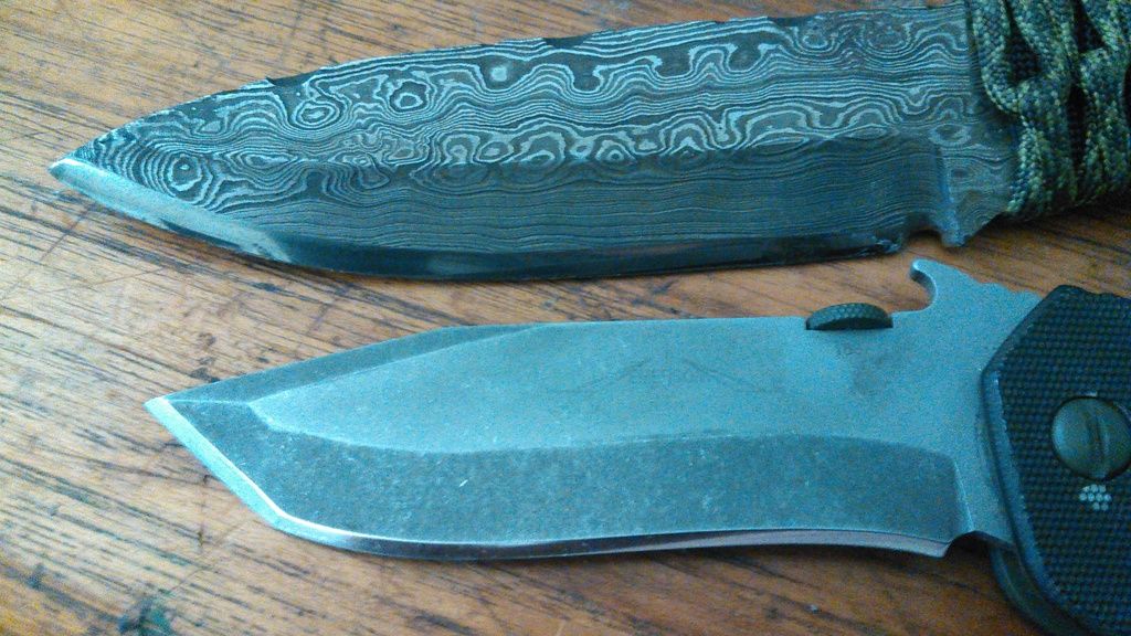

I'm not a big fan of a chisel grind. What attracts you to it?
I've found that a chisel edge will get as razor sharp as any v egde, but it holds that edge a lot better, and is also less prone to damage. It's also easier to sharpen, since you only work the steel on one side. It does take a little while getting used to how it cuts, but if you hold the blade at a little bit of an angle, that edge cuts just like a v grind. The blades on AK-47 bayonets were chisel ground, which I've always thought was a fun fact.

Do you completely chisel grind or is there some very tiny grind on the other side. Maybe only as much as from removing the bur?

I do one pass on the other side after every 20-30 passes on chisel side, but as you said, it's only to remove the burr. It's done at almost zero angle on a very fine stone or belt, so there's basically no bevel on that side still.
Here, I took pictures.

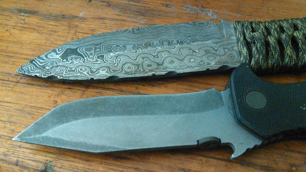

This is a knife I ground on top, convex chisel, and the CQC-15 ground by Josh, convex chisel on the recurve, flat chisel on the tanto point.
And here's the other sides. The Emerson has been sharpened more, which is why it looks like there's more of an edge. It's just the etch wearing off.
