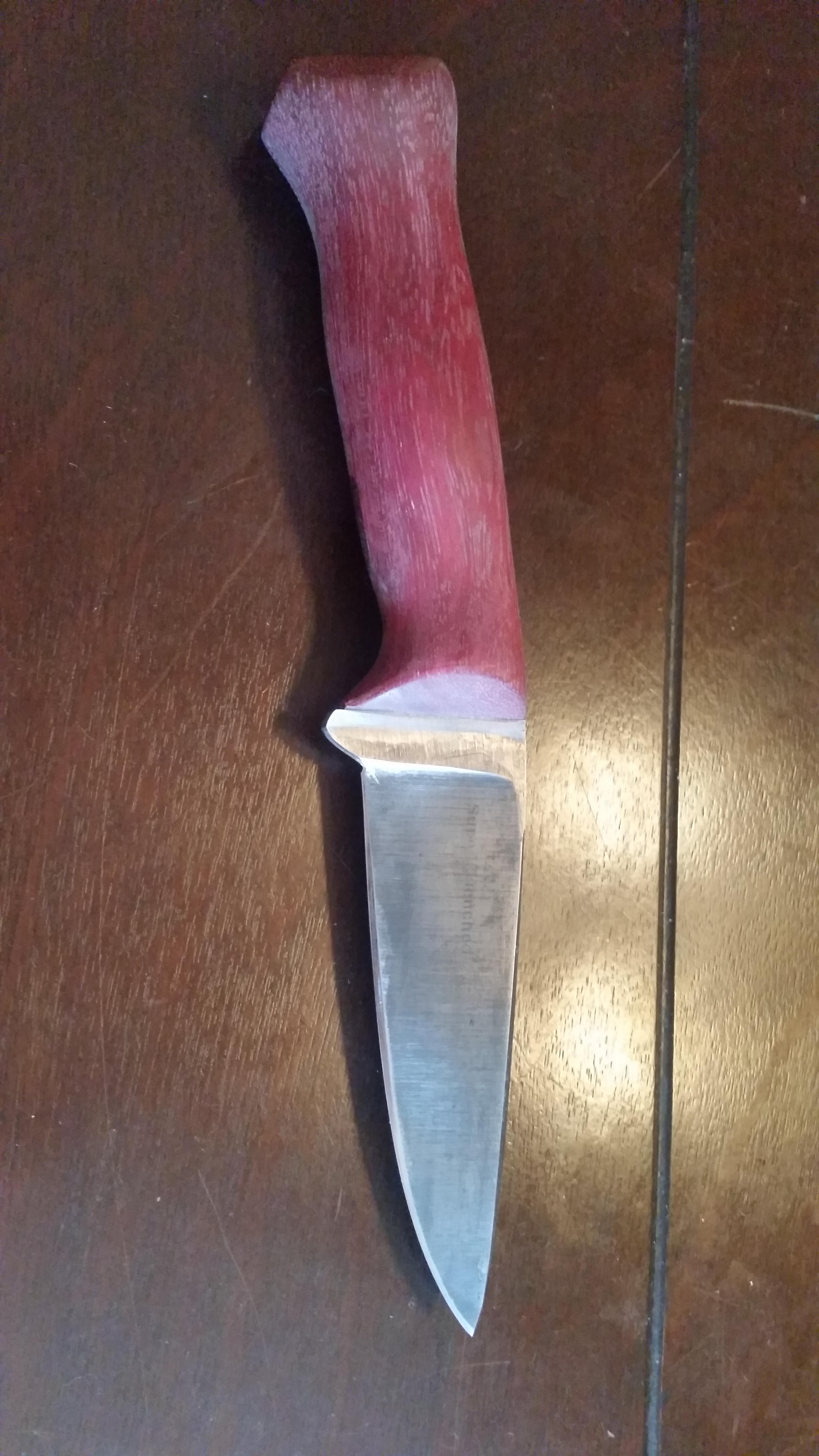

One is W2 dressed in purpleheart. It's quoted at 61-62 HRC and built for hard use. It's the workhorse meant to be whipped.

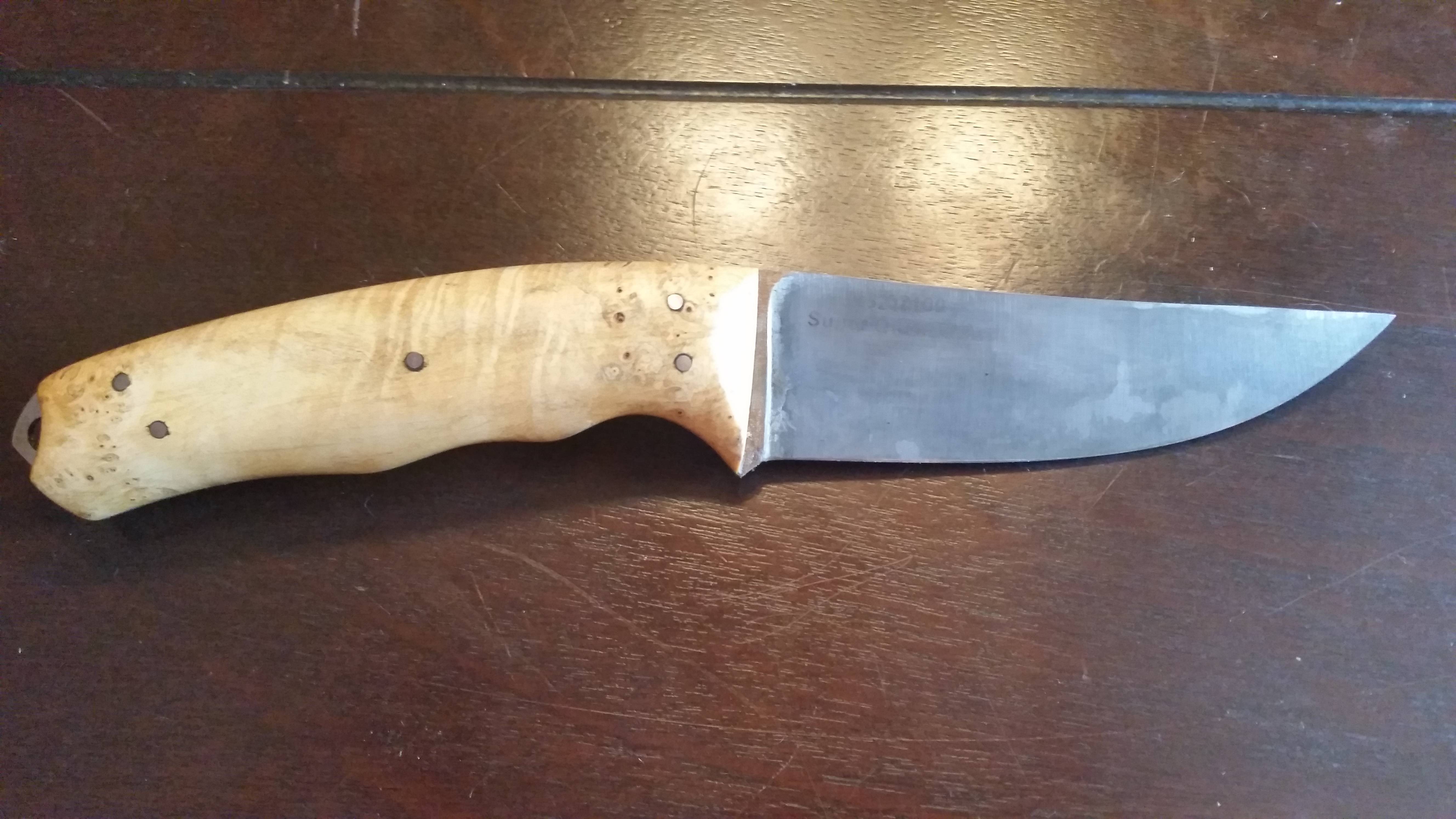

Three is 52100 dressed in Box Elder Burl. It's quoted at 63 HRC and looks to be made for medium duty use.

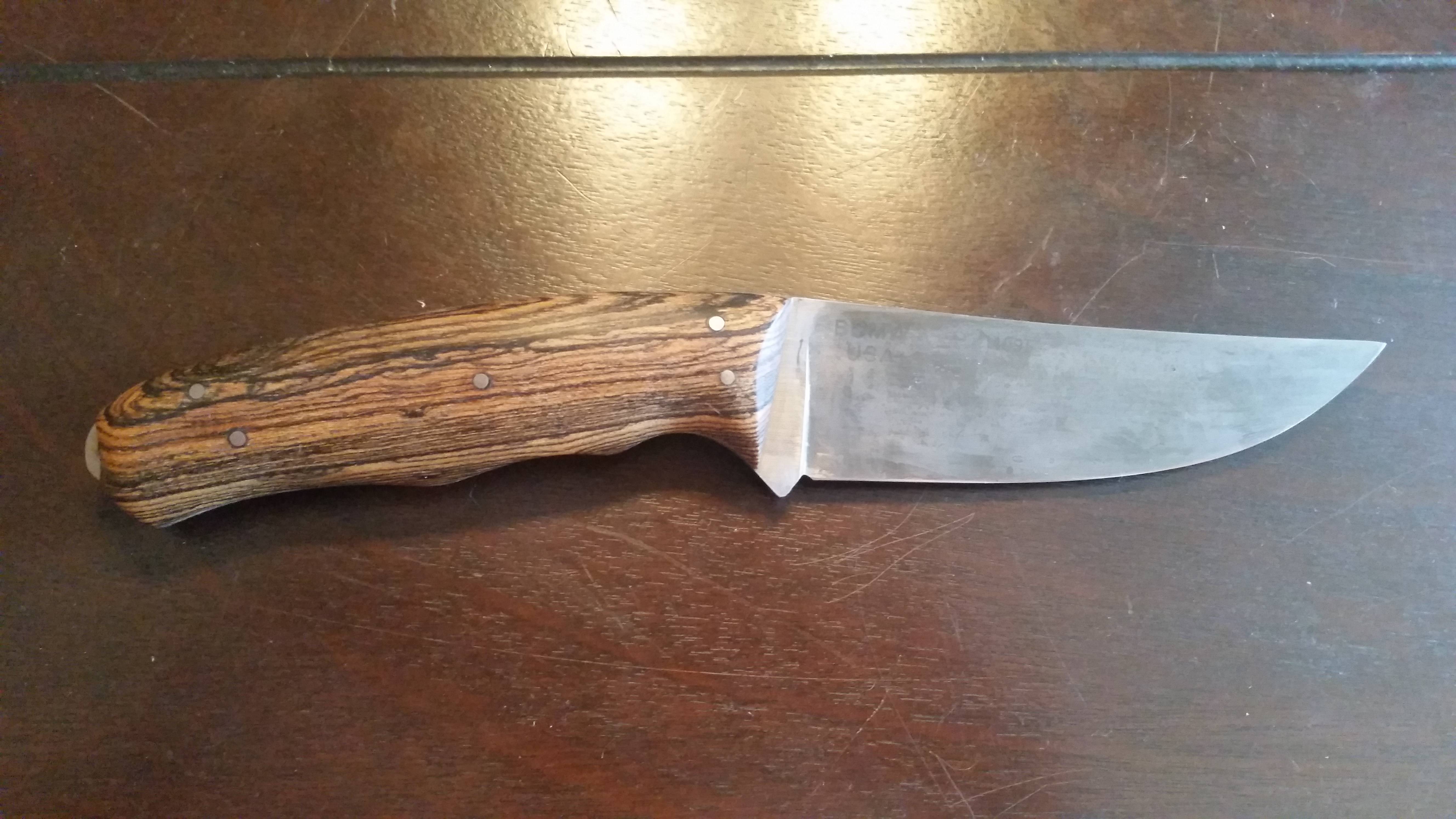

Four is 1095 dressed in Bocote. It's quoted at 64 HRC and looks to be made for medium duty use. This one seems like a knife I'd like to carry.

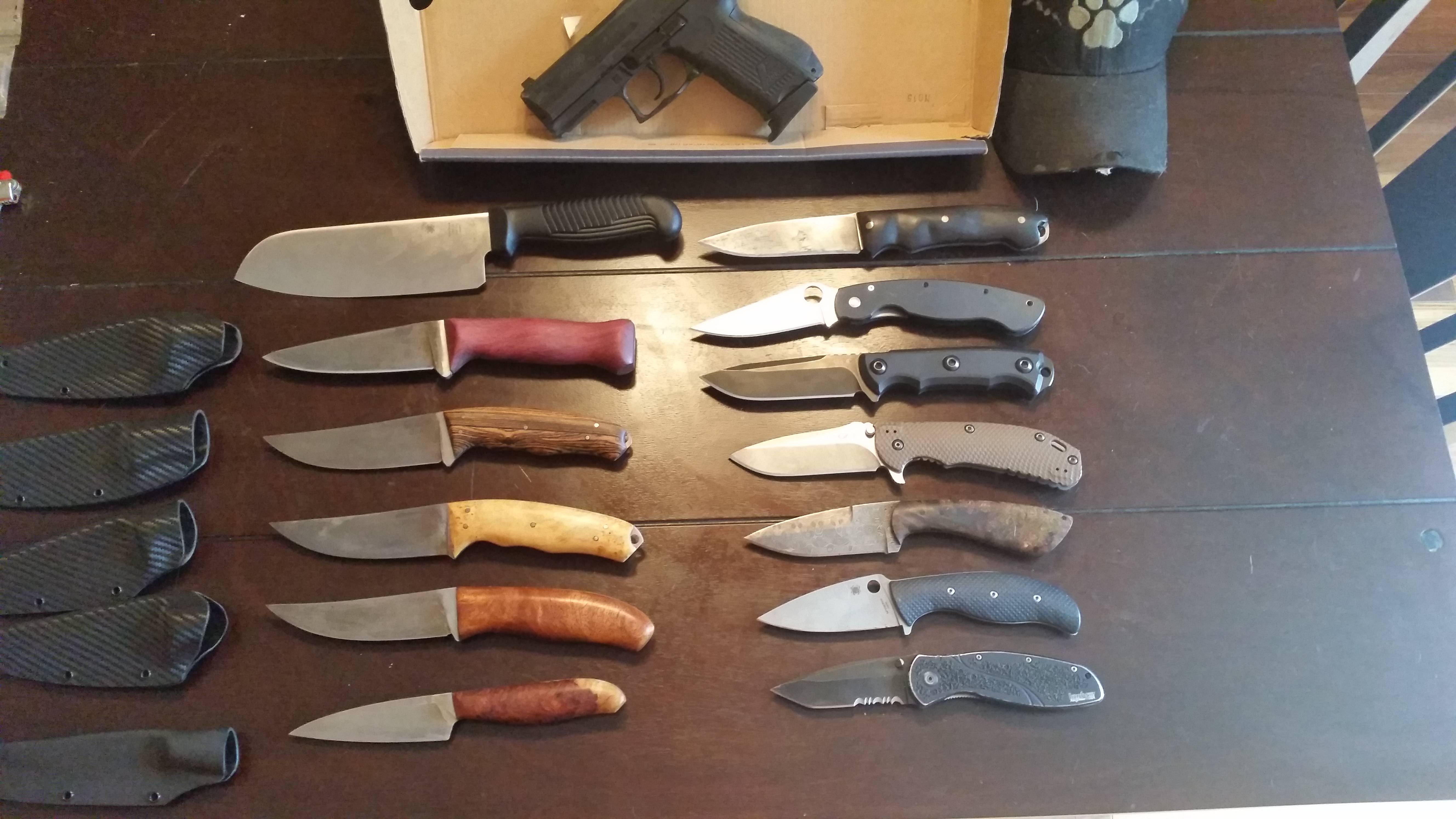

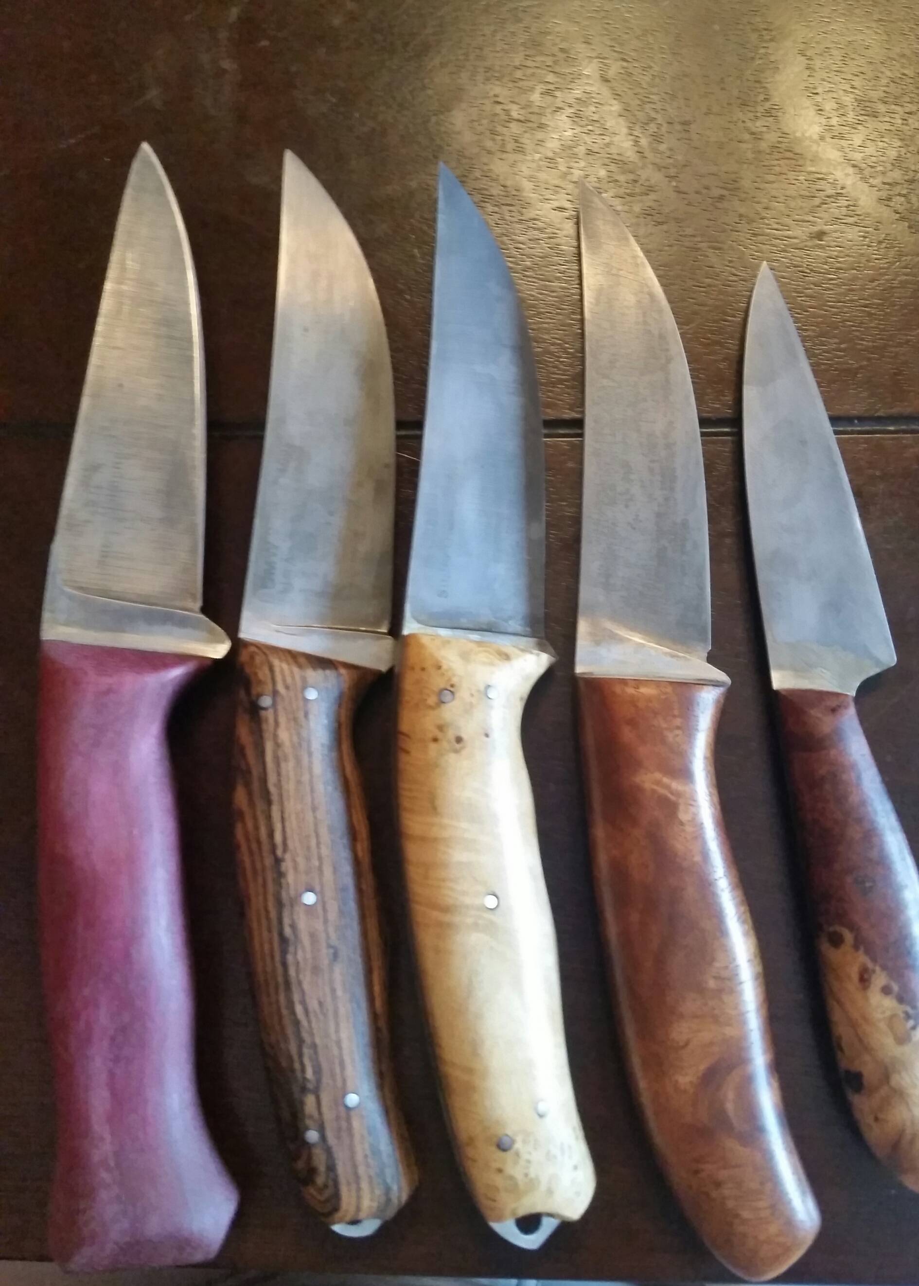

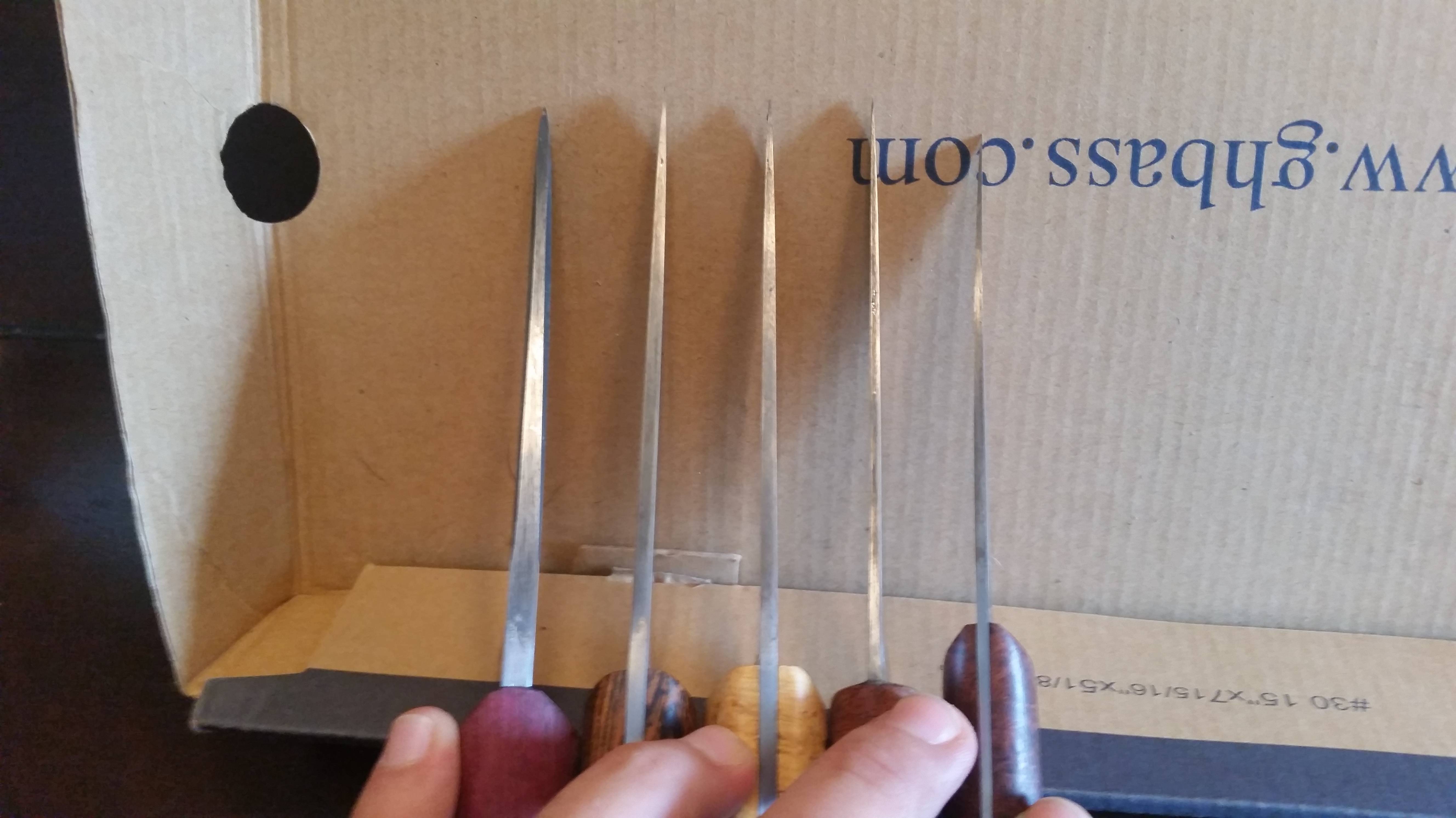

Here are the knives:
All together with some random knives for size comparison:

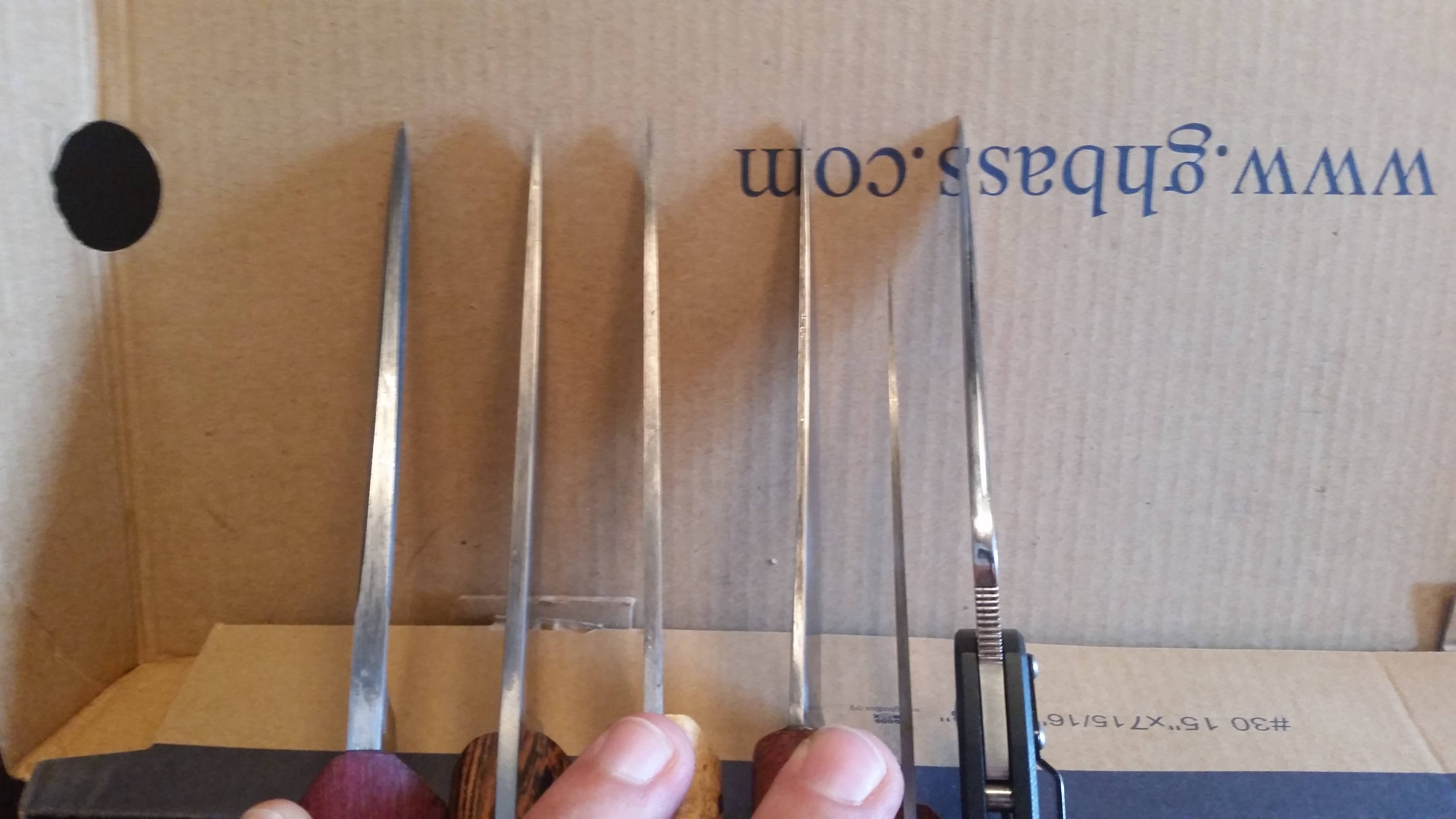

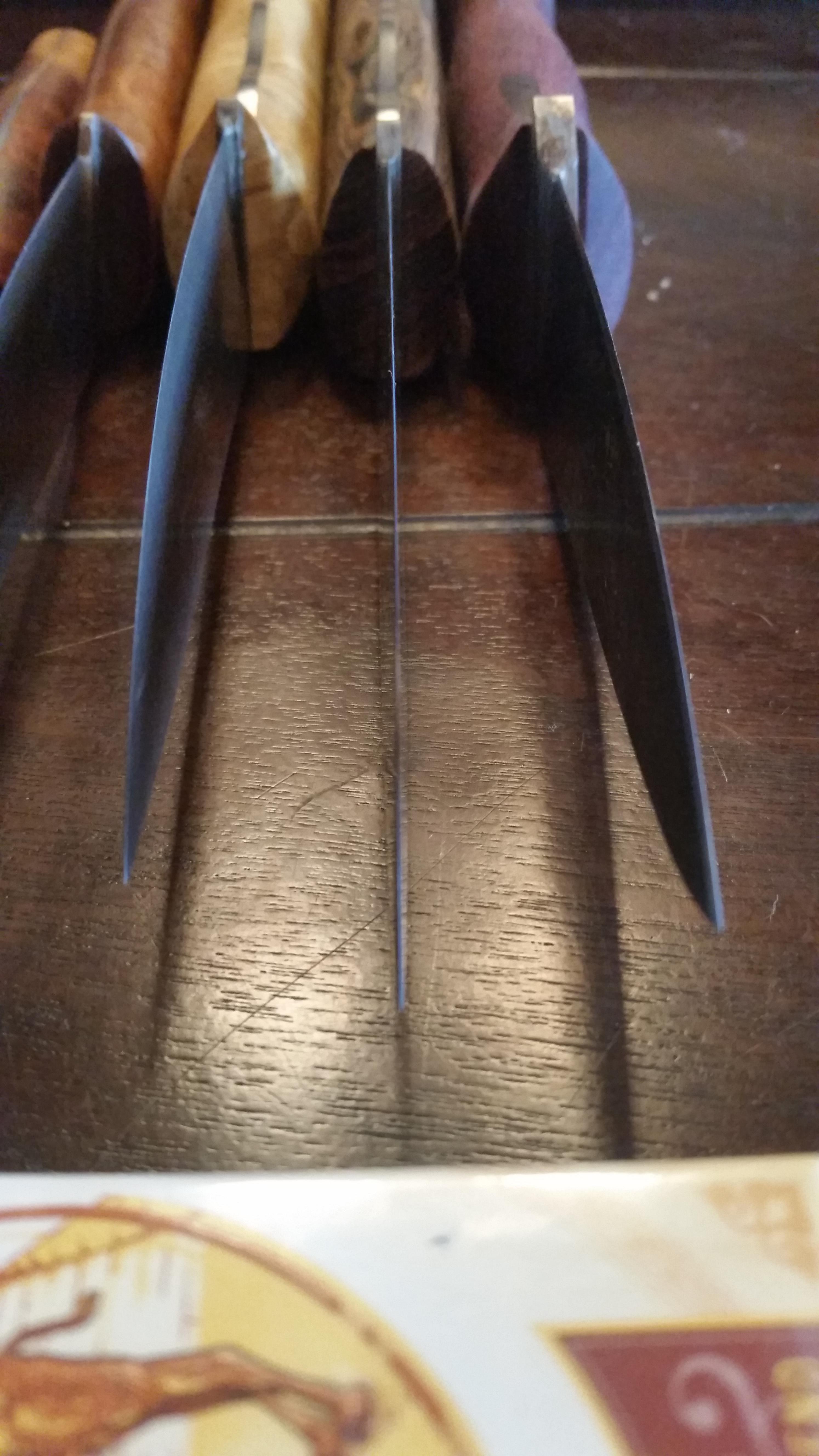

Spine thickness:
Compared to a spyderco military:

52100 at 63 HRC:
1095 at 64 HRC:
W2 at 61 HRC:

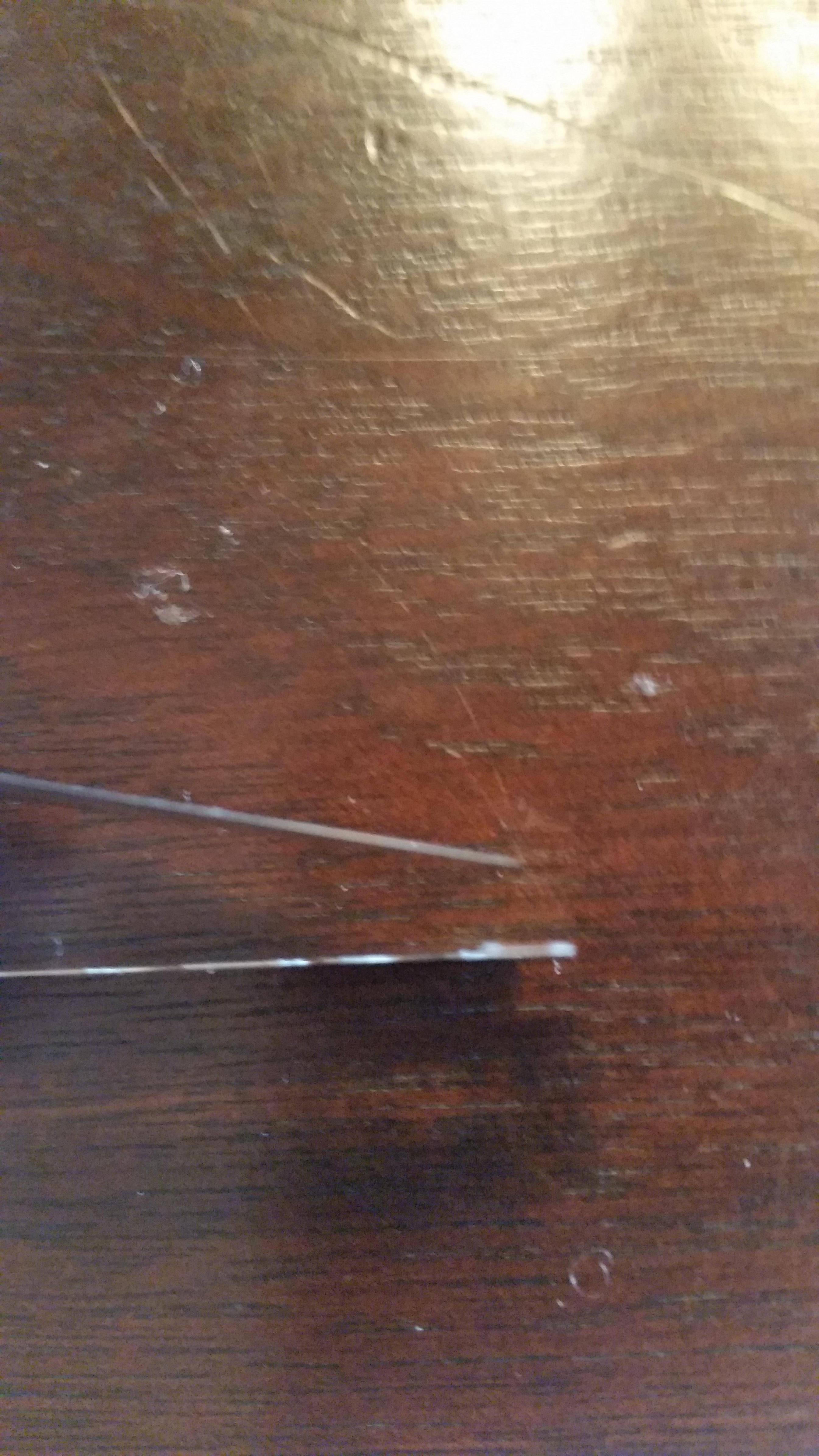

Behind the edge:
M2 knife next to a double edged razor blade:
Last shot, group photo:

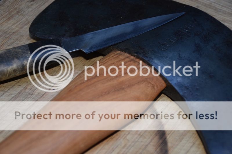

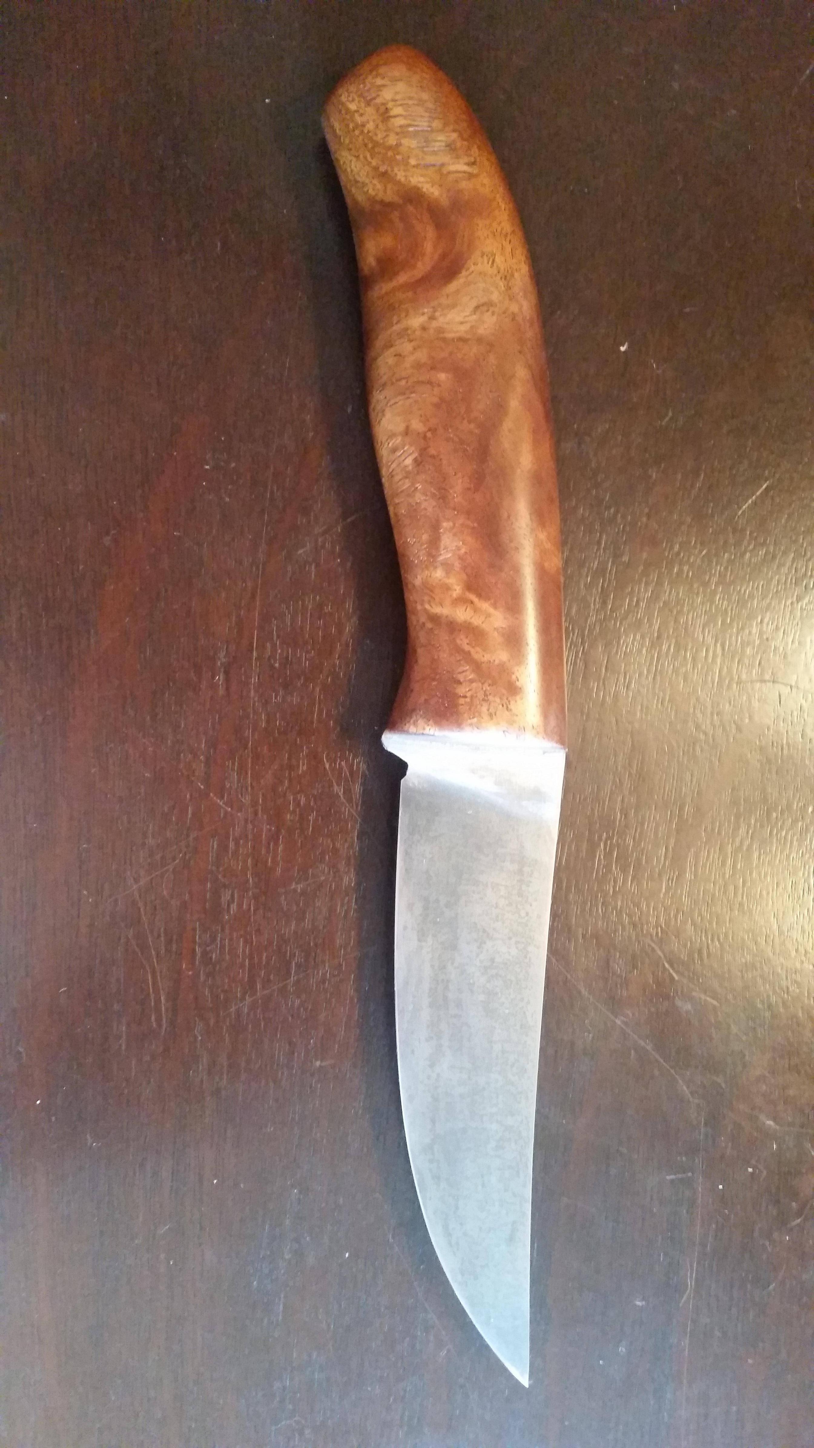

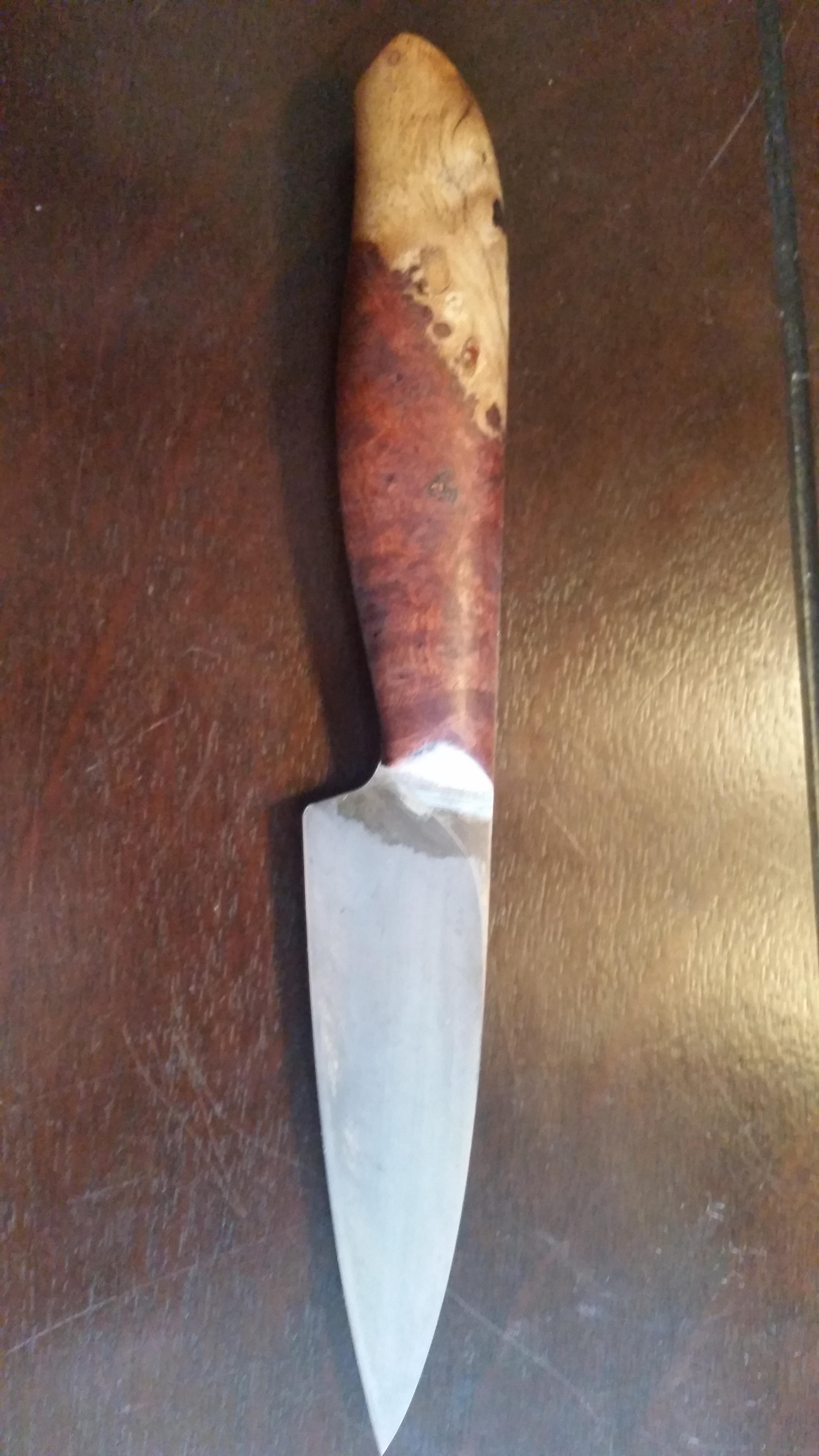

Bluntcut was kind enough to send me two slim test knives so that I could check out his heat treat. One is in M2 and the other in 52100. The one shown below is a fine slicer made of 52100.
It’s difficult to know how to test the heat treat in the steel of a knife like this because it’s not designed for hard use, but for very precise, fine slicing. The spine, above the rearmost cutting edge, is 0.975 inches. The spine has a full distal taper. The spine just behind the tip is 0.017 inches (yes, that’s the spine). It’s difficult to measure the edge width because it’s convex ground, but it’s roughly 0.014 inches at the shoulders. It cuts like a demon. I’ve been using it in my garden, kitchen and workshop, just doing normal things.
Compared to my Shun kitchen knives, it holds an edge much better, but I don’t have a way to quantify it.
I couldn’t figure out how to test the toughness because the blade is so thin. But when I was hanging an axe head one day, I pulled out my EDC Rukus (early S30V) to trim some of the hickory shavings on the haft that were pushed up by the eye. I fit my axe heads tight because I don’t use metal wedges. The Rukus was OK, but it made me nervous because early S30V can chip, and I was trimming hard hickory against the steel axe head. It makes a noise something like fingernails on the chalkboard.
So I thought I’d see how Luong’s 52100 held up, although this is way more of a challenge than I’d normally give to such a slim blade. The blade did not chip and it did the trimming. Honestly, I was very surprised. I started out gently, so if I did do damage, it would be easily repairable. I never didn’t anything too abusive, but the steel held up amazingly well.
But where the knife really excelled was in harvesting string beans. The blade is so thin, sharp and long, that it was easily to poke it into the thick maze of vines and drop one bean after another. Wonderful knife.
From what I can see that's a nice looking handle. You mind taking a full shot of it?

Man, that's a beautiful piece of wood
