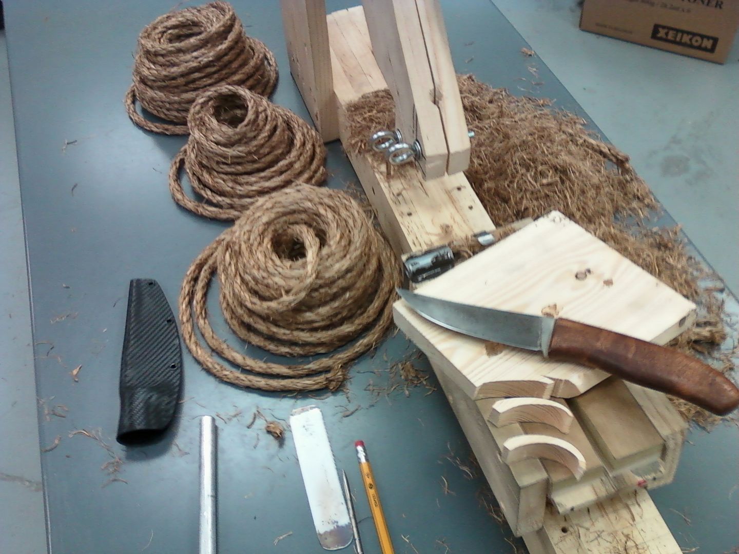

Using the newly calibrated EI-3000, I have data for one of the control knives, at least for this metric.
Set up:
Test knife is Chicago cutlery Chef's knife circa 1990s, Chinese Mfg stainless.
Sharpened knife on 800 grit wet/dry over Washboard, stropped on plain paper over same. Edge was crosscutting Alliance catalog paper with a whisper but still pretty grabby - reasonably strong 3 finger sticky response.
Set the test up at 10lbs force with 3/8 sisal (local HD only had 3/8 and 3/4, no 1/2") and a pull of 2".
Became apparent fairly quickly that rope has some variation even in the same coil. Had hoped to have a fairly black/white pass/fail but not to be. Missed its first pull on #64, yet continued for another 20 passes with no hitch. Decided when it dropped three in a row it was DQ'd. That didn't happen till pass number 217. By 120 it was missing the odd pass with regularity, but it would also recover and cut another 10-12 with no missing. Finally as it approached 200 the instance of misses and the odd double miss increased, dropped three starting at 218. I continued for another 5 passes and it was unable to complete any though was still making it reliably through two of the three strands.
Edge in the test region could still pop arm hairs and crosscut catalog paper with a push though was louder and hitched a bit as it went. Three finger stick had dropped off in the test region - was still noticeable closer to the tip. Clearly this test has its limitations, but it did pick up on a level of edge degradation that would otherwise be pretty subjective.
Next test will be something higher quality and then I'll have the beginnings of a scale.

Continuing with the EI-3000, next test knife is a Bark River Bravo Necker in 12c27. Edge terminates at approx 26°. Perhaps a touch thicker behind the edge than the Chicago Cutlery Chef's knife, but a touch thinner at the apex to make up for it.
First stutter at 180, began to miss with increasing regularity at upper 200s. Surged thru the 300s and finally crapped out as it reached midpoint 400s - 463.
Is apparent that there is a bit of variation to the rope, enough that it needs to be taken into account. Just setting it on the rope prior to making a pull I can feel variation in how readily it bites depending. I also added a necked down tube to guide the rope into the cut path, and I can feel when a splice is coming through. All in all seems to be reasonably useful though. I expected the better steel to outperform the poorer steel and it did, by more than 2 to 1. Any testing of additional knives now have something to compare to as well as other cut tests.

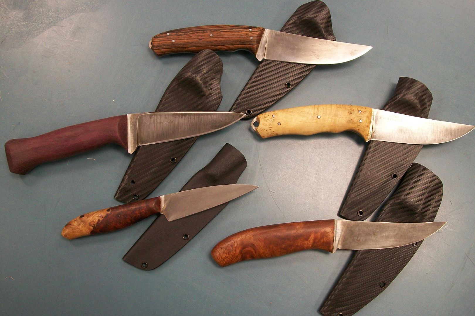

First off, all seem to be well thought out. The handles have a good feel, the edges all have a continuous curve along the entire length. All are very thin grinds except for the W2. Maintaining the edge on these will be very easy due to this thin grind, the cutting bevels are quite small. All of these sharpened up on several abrasive media quite readily despite the high Rockwell values. Burr formation was moderate, removal straightforward. The 52100 took slightly longer to resharpen than the others. I wound up lowering the grind angle a few degrees on all but the M2. Started out at just above 30° (best I could eyeball) and I dropped them down to approx 26-27.
Despite being for eval only, the overall fit and primary grind work on these is very good. I am somewhat familar with the paring/small utility pattern used by BCMW, the medium pattern is very nice in hand and use - Of the three "medium" patterns I could not settle on a favorite. The CruForge is so light it doesn't seem possible the handle/tang could hold up to abuse, but there's also no way I am going to push it far enough to find out. It would make a great EDU/constant companion for IWB or high belt carry.
Close examination at 400x revealed no cracks along the edge so far, I'll take another look before I send them off (something I always check for when steels are run close to their highest possible RC). The knives are being used on a variety of paper, cardboard, plastic skid banding. Some carving of hardwoods. I am beginning to run them thru the EI_3000, Cutting is of 3/8 sisal at 10lbs.
Started with the 52100 and got up to 500 passes before calling it for the night. It can't have much more in the tank, but I thought that when it started to balk at about 275 and it just kept going...

Back to it, I had some issues with getting reliable numbers from my rope testing, so switched to Manila from sisal and now use multiple coils, swapping every 25 cuts. This greatly improved the consistency of my numbers, still hitting foreign objects in the rope from time to time but that might be unavoidable on a unit like the EI3K and the rope I'm getting from HD. The numbers are about 1/4 to 1/3 of what I was getting using the sisal. The Manila is much more rigid, twisted tighter, has more consistent diameter. Everbilt brand name.
10 lbs of force, 2" draw, 3/8 Manila.

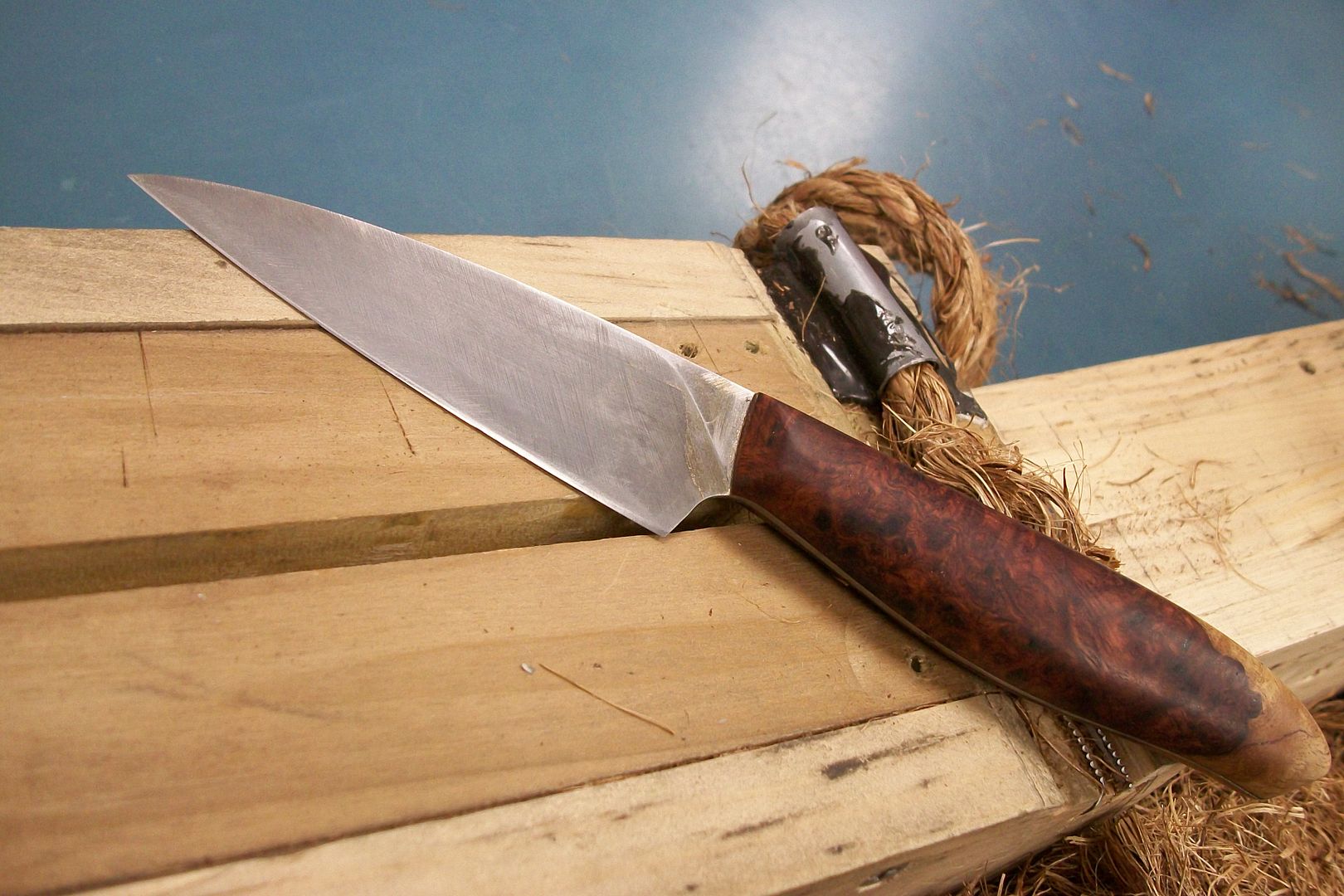

Beating on the Cruforge tonight. Again, this thing is light, 2.4 oz. As with the others I've been working them into day to day stuff where possible and this has held up fine to normal use. I would not pry anything with it, but for cutting I tried not to baby it.
This knife more than the others so far is giving me the most trouble cleanly deburring, though only compared to the 52100 and 1095. Nothing too crazy but something I noticed.
Clamped on the EI3K, it passed 124 on the first go and turned out a solid 174 on the second, best so far of those tested. I also pounded some good sized curls out of a pine board, stripped curls off some poplar. Really held up nice.
One thing I'm noticing is my numbers seem to climb on the second test somewhat reliably though I am not spending any additional time on the second sharpening. Subsurface burnishing from the test itself...? :confused:
