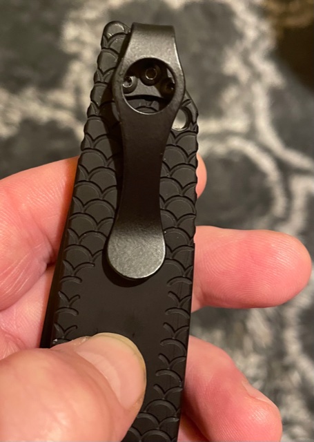

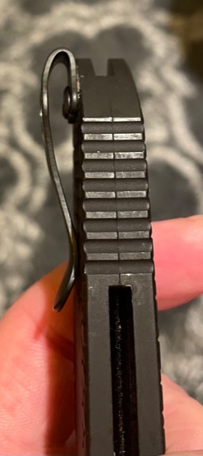

I got some newer lynch clips for mine and my wifes spyderco para 3lw's. They seemed ok but my shirt caught my clip at home and pulled the knife out of my pocket. The inside seam of my button up work shirt caught it. I chalked it up as a freak thing and ignored it. Then at work last night it happened again. My knife got pulled out of my pocket by my shirt and hit the ground and opened. Not a huge deal. These clips just seemed "loose" and not as secure on the jeans. While discussing this with my wife she mentioned hers seemed super loose too. I looked at her knife and the clip was bent out and not even touching the scale. Also not a huge deal. She must have just caught it on something. I removed it and bent it back. Now I've had a few other older lynch clips and have had like my seat belt catch it and pull the knife out of my pocket but I've never bent one. These newer ones I thought were maybe just "slick" because of the frn on the para 3lw's. Well I looked at my old lynch clips and compared them to the new ones and the newer ones are only half as thick as the old ones. Thats why I've never bent an old one. Kinda sucks to see someone who had such awesome clips cheap out and get thinner stock titanium for them. Wont be buying any more. They were always a huge improvement on grip while also adding deep carry that I like. Now the grip just isn't the same. To flimsy.
The new ones that you show actually look more refined, finished if you will. I think any clip will catch and pull if not careful. I actually have 3- Lynch clips-one for Delica-one for Endela and one for Chaparral, the Chaparral actually has the tightest of the 3. I don't have any experience with the older ones as I have only had these a short while, I will be buying more. I like the name you chose, I chase surfperch. Have a good weekend.

I did email him. Haven't heard back yet but im sure he'll get back within a few days. Either way something changed. Its clearly a thinner stock of titanium. Either way its not really "my issue". I just thought I'd point this out and show people. If you've bought clips before and liked the older ones just know you may not be getting the same solid product you used to.
Your photo looks like a wire clip replacement (Para 3, left) vs. a standard clip replacement (PM2, I think?). Is it not possible that those two clips are built to be different thicknesses.
(Genuinely curious. I've only ever replaced standard Spydie clips and BM clips with Lynch versions; they've all been great.)

Yes this one is a wire clip replacement but I also recently ordered a benchmade clip from him to replace the one on my hogue ritter and while it is leaps and bounds better than the stock hogue clip it too is thinner stock than the older clips.
I have Lynch clips on a GB2 and I think on a Griptilian. They have been great. I wonder if they went with thinner material due to the ultralight nature of the para 3 LW? It will (in theory) require less clamping force on your pants to keep it from getting away. Sometimes stuff like this doesn’t work as well in real life as it does in theory.

I've been buying the same material since I started making clips. The target tolerance is between .040" and 043". If the material is less than .040", I'll send it back to the supplier. If it's over .043", I'll do the same.
I've played with a lot of thicknesses, and right around .041-042" is what I prefer, for a few reasons. The main reason I don't like to go thicker is because we still bend all the clips one-at-a-time, and the thicker material is harder to form in a repeatable manner, so there can be tolerance issues. The thicker material is also more prone to cracking or stress fractures at the 'U' bend when forming. In addition, when I tried the slightly thicker material (.044-.045"), I heard from quite a few guys who had trouble getting the clips on, the issue mostly being not able to get their screws started. Clips will bend for sure - an .041" piece of metal (about the same thickness as 10 sheets of printer paper) is no match for a 190 lb guy vs a seat belt. But I've found that the thickness of material I like has proven to be durable.
In the pictures above, the thicker clip is one from probably 3 or maybe even 4 years ago. I've been cleaning up the edges of the clips for around 3 years, so ones with rougher edges are most likely 2018 or older. I'm always playing with designs and changing details, and I had decided to try some slightly thicker material, but decided it wasn't the best solution, for reasons I mentioned above. If those clips in the photo were mic'd with a pair of calipers, my guess is that one would likely be around .040" or .041" and the other around .043" or .044". I could be wrong, but that's my best guess looking at the image.
As an aside, a sheet of printer paper is roughly .005-.006" thick, so the difference between an .041" thick clip and an .044" thick clip is roughly half the thickness of a sheet of paper. I bring that up because there is no cost savings for me when using .041" material vs .044" or .045" material. From my titanium supplier, it's the same price. In I the end, I just like the .041"-.042" because I think it's a better end product.
Like I mentioned to Shawn in the email, part of my deal is a lifetime warranty. If you bend a clip, I'll replace it, no charge, and if it happens again, I'm happy to replace it again. And if someone buys something from me and decides they don't like it, for whatever reason, I'm always happy to refund them in full. You don't need to send the bent clip back to me; just let me know where it was purchased from. I don't want anyone stuck with a part they don't like or won't use.
