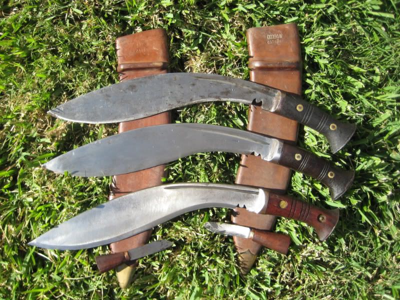

On the ring, British Gurkha issue Mk. II, as well as the enigmatic M-43 (whether or not it was issued has been debated), both came with rings and slick handles. The WWI Mk. II had rings, as well as early WWII models. The rings seem totally gone by at least 1943 from what I've seen. The consesus appears to be it was cost cutting, as quality also seemed to deteriorate with Mk. II in general at the same time. Production was really ramped up. As well, Mk. II were issued to Allied servicemen, so that could have played a part as many do not like the unfamiliar ring (if it's not in the right place for your hand size, it is annoying). The Mk. II was an issue piece for the US Merrill's Marauder Rangers.
Any excuse to post pics:) Here is a WWI/early WWII Mk. II with ring.
Here are two 1943 Pioneer Calcutta Mk. II and an M-43 on bottom, sans ring. Notice the quality difference between the above ringed Mk. II and the Pioneers. It can be felt as much as seen. All of the M-43's I've seen appear to be of very high quality.
