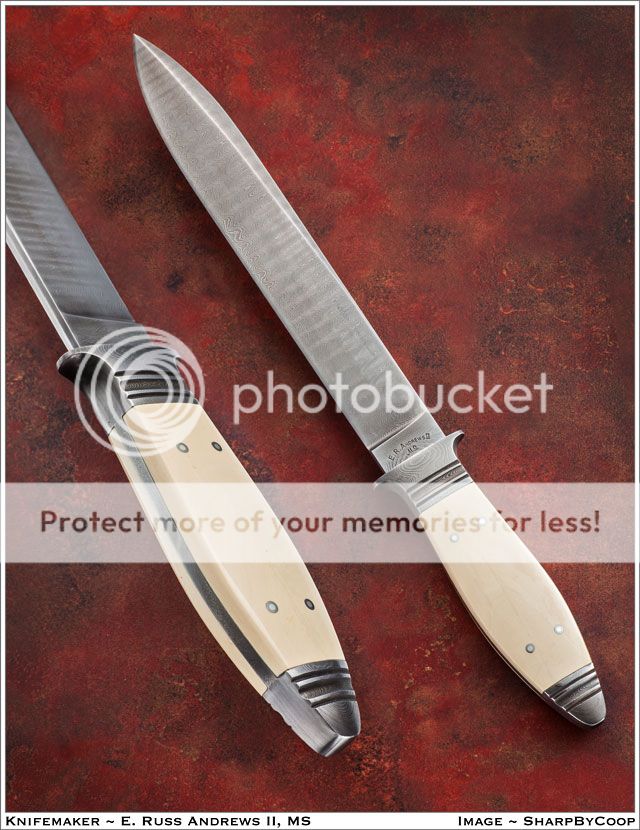

About 320 layers 1084 and 15N20, and core Mammoth Ivory, with Sterling
pins and stainless sleeves.....Integral construction except for the inserts
along the edges of the tang.
For the inserts, I used thin strips of random pattern, with a single twist at
the center of each....twists which are opposing....just for an added touch.
The blade is 8 1/2", and the piece is a bit over 13" overall.
Some memories, lessons and a few goofs (lol)...all contributed to it's completion..!
Comments welcome....

Very nice looking blade. I like how you did the pins in the handle also, nice little detail.
Elegant, Russ. Traditional and modern at the same time.
Also a second on the neat pin treatment.

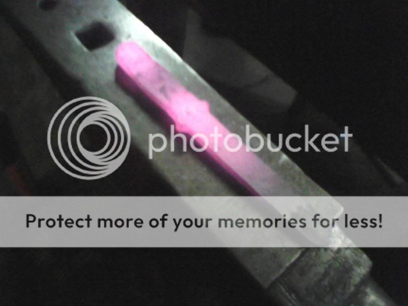

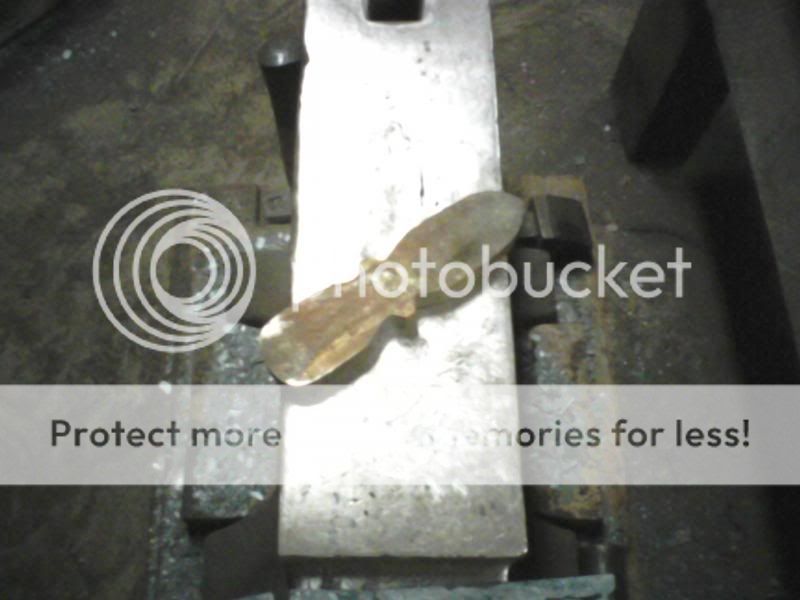

First, the forging stages.

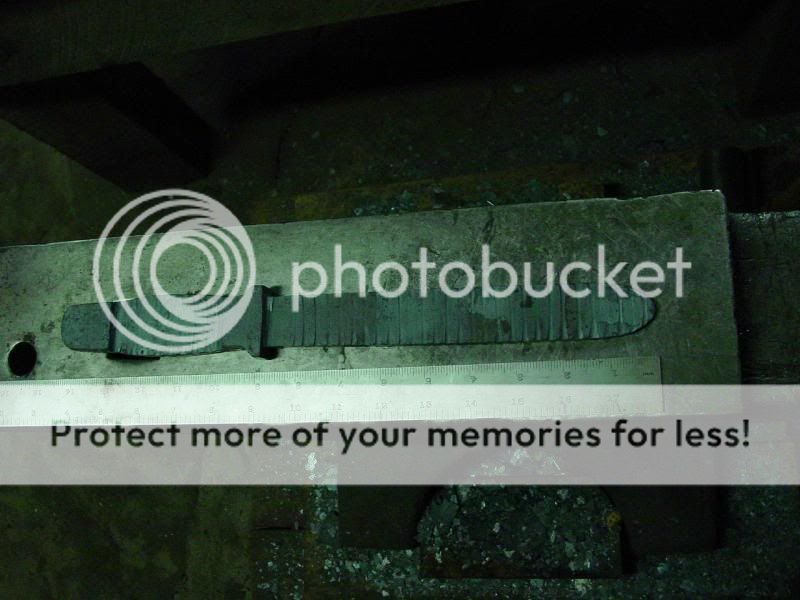

Ladder cut in.

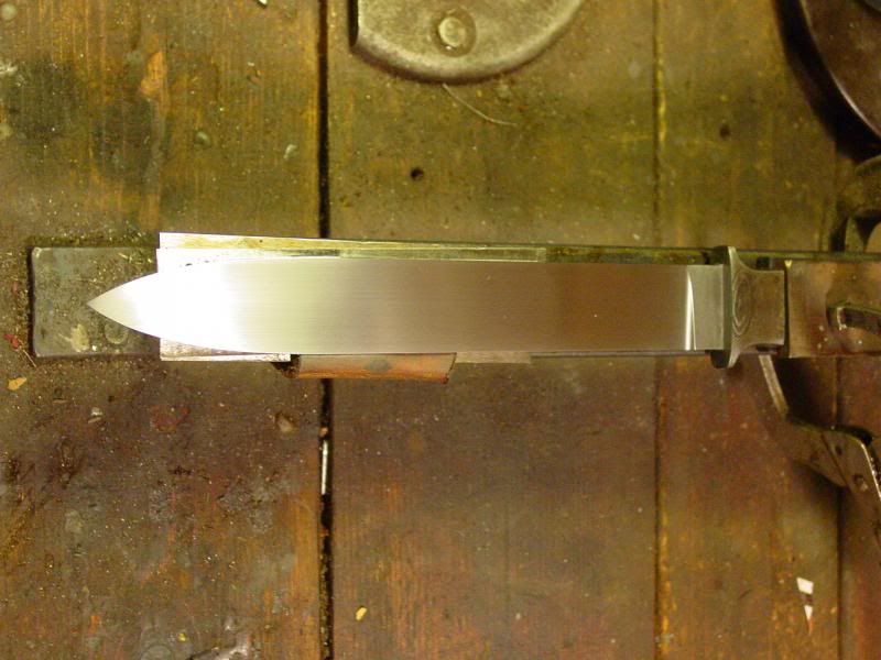

Heat treatment and grinding complete.

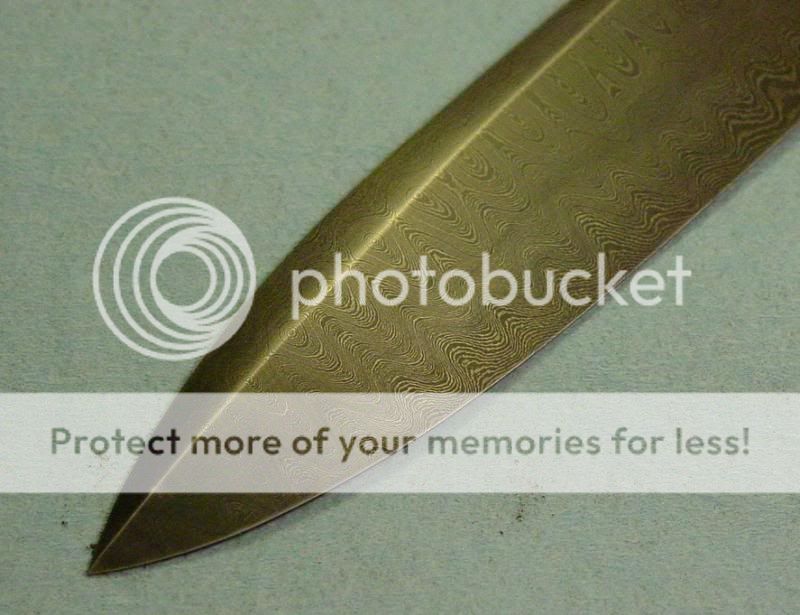

Preliminary etch on blade.

I need to add that there is a LOT of shimmer in this blade and what appears to be streaks are only a snapshot of that movement. Not so.
I was suitably impressed. You can look VERY closely and see as well.

Wow, Russ that is very impressive. Just a fine job. Classic and modern at the same time. Love it.
Brion
Such a beautiful unique piece, gorgeous work Russ. :thumbup:

A tremendously elegant piece that is a credit to both parties involved - congrats to you both!
