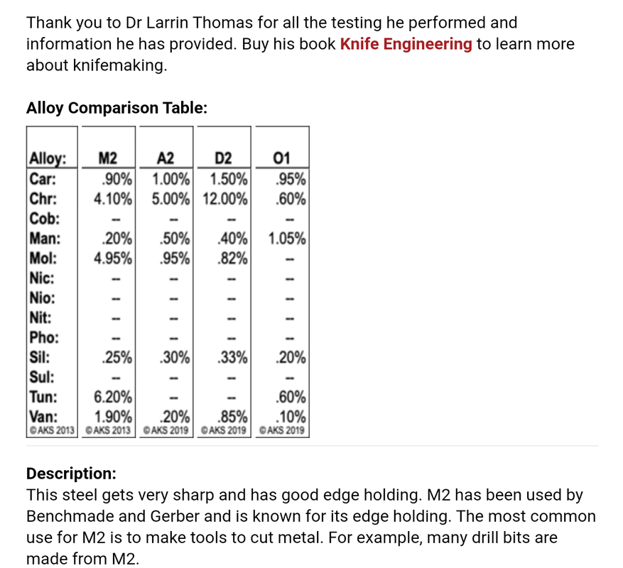

Certain brands are fully heat-treated high speed steel, usually M2.
I have to dig through his notes, but they are treated to be Extremely Hard.
Harder than most knives. When made into knives the edge will last a Long time.
Lots of vandium, should hold a Better/finer edge than D2.
According to AKS

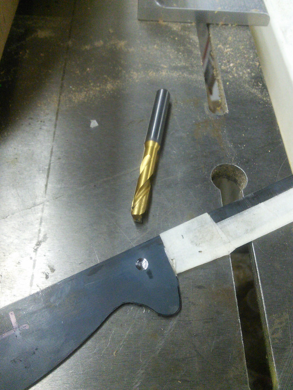

Special belts, and drilling is next to impossible.
I heard masonry bits work? But I have yet to find the ones that do???
I've tried 3 unsuccessfully, and my expensive Carbide drill bit is now dull. :(

They were just various cement/masonry bits I bought at the local hardware store.
They don't work..... I'll have to borrow one from my job this week, unless anyone else have Proven bits I can purchase.
*I might remember somebody saying that the carbides on the masonry bits need to get resharpened? Maybe I could try that...

The spade shaped bits for tile and glass work fairly well on the PHBs.
Everytime I have checked hardness of the PHBs they have been 64-65 Rc.

Black and Decker glass and tile have worked well but sometimes feels like I would get a dud. Lately I have been buying cheap ones of Amazon, they are still a spade point and cost 10 dollars for 10. They are cheap but work and if there is a dud or three no big deal.

Nice and cheap..... I paid around 25-30 and they aren't working.ha
I had a friend who wanted a couple PHB boning knives. He owns a manufacturing company and bought a couple 30 dollar carbide bits from his supplier. They both shattered with my crap drill press techniques, total waste.
Yeah, mine from work, I'm sure cost prob the same? Only did around 4 holes before getting dull
I'm checking out Amazon now, for more tile bits
USA knife maker has carbide bits for drilling hardened steel. Haven't tried them but you'll probably want slow speeds and high torque with lube to cut and not bind or burn and break. I find angle grinder works well for cutting a slit that can be secured at either end with pins.
