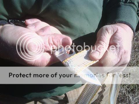

I have one M4 knife. I've used it hard, using it to cut metal in various forms, among other things.
If you can do things like that with a knife, and then still do this;
then you are using a good steel, IMO, and you most likely won't need anything else.
Just for fun, maybe someone should try doing the kind of cutting I've done with M4 on a comparative basis, just to see how the other steels hold up. Use them to cut some sheet steel, some steel tape, that kind of thing.

You mean you cut sheet metal, but was still shaving sharp after?
To bring it back to shaving all I had to do was touch up the edge a bit. By that I mean, I steeled the edge then polished it on a ceramic rod. The blade was still sharp enough for cutting purposes before I did that.
I have a thread in the Spyderco forum talking about the uses I have put this knife to. The only thing I have done to do any noticeable (visible) damage to the edge was when I used it to pry carpet staples out of some floor sheathing, and that was because I used poor technique.

I did see and follow that thread Andy and that was awesome. I do use my GB a lot on work chores too(not as hard as yours) and I agree about the edge holding of CPM-M4. I was just a bit surprised that, which I thought you meant, that it was still armhair shaving after the sheet metal. This clarifies things.Thanks
