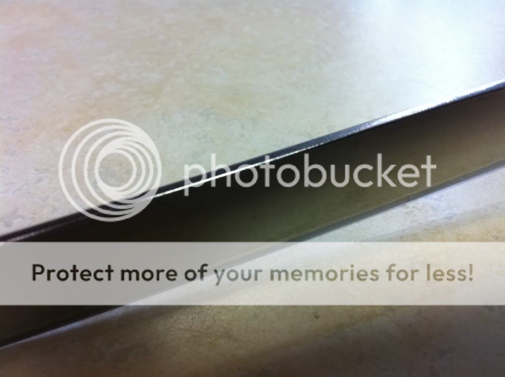

M42 steel saw blades turned into kitchen knives
That looks good enough to scare the hell out of dinner guests :)
That's a helluva band saw. It could be solid then. The best way to tell might be price. Do you have any idea how much the blades cost? Will the blades bend at all before breaking?
I have no clue on what they cost. And they usually don't break, but when they do it's is mostly where the blade ends are welded together.

if it is solid m42 you will know that stuff is supper hard and incredibly wear resistant. try scratching the spine with a knife of known hardness and see which one wins
If it IS a bi-metal blade, that would indicate it's rather critical to get the orientation right when making it into a knife, no?
Hard spine and soft edge would be a shame.

Just an update:
I just called the manufacture of the blade and the teeth are welded to the backer blade, however the teeth are actually m71 and rc of 70. And he thinks the backer is made of m42. He is looking into it and promised to call me back.
Ok I just spoke with the manufacture and the m71 teeth are welded to a D6a steel that is used for the backer. Now I
don't know anything about "D6a" other then I'm guessing that it is a variation of D6 tool steel. If this assumption is true, then it is still very much suitable for a knife blade.
Metal experts please chime in and shed some light on what I am working with. I don't want to waste my time with this
stuff if it is not worth my time. Thanks.
D6a sounds a lot like D6AC steel. D6 and D6AC are very different, and I'd bet on D6AC as the backing. D6 tool steel has almost none of the properties one would want in a backing steel for a band saw blade. D6AC is made by Latrobe, among others, and is a medium carbon, low alloy, high strength steel with good ductility (stretch) and toughness.

It would make a knife blade with toughness difficult to fathom if you're used to normal cutlery steel. For a carving knife, it should work fine. It's not like you're cutting used carpet or something like that. It will turn colors if you use it on meat. My carbon steel knives turn a nice shade of blue.
Really? 0.42-0.48 C would make it hypoeutectoid. What do you get if you harden such a steel?

Billyboyr6, if you would like a brief explanation of any terms, let us know. I tend to write as though everyone is familiar with the terms, which is a bad assumption on my part. Hypoeutectoid steels are steels with a carbon content less than about 0.8%. A few of the steels used that qualify are 5160 (popular with custom makers for chopping knives), 420HC (Buck), 1055 (Cold Steel machetes and GI tanto), 12C27 (popular Swedish made stainless steel), 13C26 (slightly higher carbon version of 12C27, same manufacturer), AEB-L (American made version of 13C26), and others. The last 2 are razor blade steels, and I've had very good results with 12C27 and 420HC. Cold Steels machetes of 1055 will cut two 2x4's and still shave my arm, and likely are about the same hardness as your D6AC. The maximum hardness of hypoeutectoid steels is lower than other steels with more carbon, and they have much lower wear resistance, but still have their place for us knife knuts.
I'll clarify a little bit what I mean by unfathomable toughness. This steel will be extremely tough, especially relative to some of the more popular cutlery steels. If you bounce a machete or such off a rock, and it's made of a steel like this, there's practically no chance it will chip at the edge or shatter out right. There's a good chance it will mash/dent pretty good, but you can't get everything in one steel, and geometry has a huge influence on this kind of damage. Traits like this are the reason hypoeutectoid steels are used in the first place.
As a kitchen knife intended for cutting meat (carving knife) I'd think it would work fine. Just give it a good sharp edge, and don't hit any bones too hard. As a broad generalization, if the steel is in it's working range of 250,000 to 280,000 psi, you'll get a hardness in the range of 53 to 56 HRc. This can be found on google with a search for hardness conversion charts. Hardness in this range is relatively low, and you can expect some definate edge rolling if you use it in a ceramic plate/cutting board. However, many kitchen knives are made in this range, and serve for years. Just don't cut anything frozen or try to hack through bones. Aim for a bevel angle of 20 to 25 degrees. If this proves satisfactory, lower it little by little until you feel the edge is too weak. Food is generally very soft, and the cutting board, washing, and storage in loose silverware drawers will do more to dull a kitchen knife than cutting meat, vegetables, plastic wrappers, etc. In short, you have a fine carving knife, and I wouldn't worry about the steel not performing properly, you just may have to sharpen it a little more often. I've seen video of a guy prepare a chicken dinner with a sharpened can lid. As an experiment, get some steel from Lowes or Home Depot and grind a blade from that, then see how it works in the kitchen. For meat and such, it will cut fine, just not as easily or as long as the thinner, harder blades. The strength/hardness just isn't there to hold a razor sharp edge on a 10 degree per side bevel. Past a certain point, weaker steel gets too thin and will just fold/deform. Anyway, its an interesting experiment.

I wouldn't bother with it, myself. It sounds like false economy to me... sure it's free but there's usually a reason for that. It will "work" I guess, but there are dozens of alloys that would be much better. Blades made from O1 and CPM-154 (for example) perform extremely well, and would cost $5 - $15 max for a blade that size.
