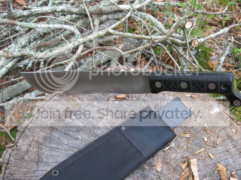

I have discussed the modifications I do to my machete blades here before. Today I made up a little video explaining some of my reasoning and demonstrating the use of the different surfaces. No chopping in this video as I did it here at home.
I used a 12 inch Ontario in the video because that is the blade I use most in North America and wanted to show how these are practical mods for there as well as here in the tropics.
Machete Modifications for the Bush

I do all of it by hand. I clamp the blade horizontally on the edge of my workbench and work one side at a time. For the scandi I use the file first to lower the grind and keep an eye on the edge. When I get close I switch to sandpaper around the file and then to my ez-lap, medium and hard Arkansas stones.
