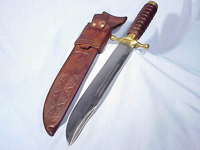

That Old Collins 18 bowie has gone through a myriad of changes on the handle. In their catalogue, it was called the 12" bowie. During WW2, Collins had to abandon the use of their cowhorn cause it was hard to obtain, so they switched to stacked leather. Then they turned to plastic some time during '42, calling it the A.A.F Survival. They also had a variety of stamps, for keen kutter and even Old Timer to name a few, but I dunno about True Temper. If the date was right, that very well could have been made by the actual True Temper factory.
There were actually two Collins models called the #18. The older #18 Bowie was a true Bowie with a 12" blade. Collins made swords and knives, too. But the short one with the 9" blade and big quillion was called the #18 machete. I had a chance at one of the green horn handled models, but passed. It was in like new condition with orignal sheath and all. I'm just not that serious a collector. Kinfolk, Case, and Western also made them during WWII. Whether you call them Bowies or machetes, they were thin and used as machetes mostly. Maybe some Japanese soldier got stuck with one, but I'd hate to go up against somebody with a Samurai sword if all I had was a 9" blade.
Here is a picture of the #18 Bowie.
