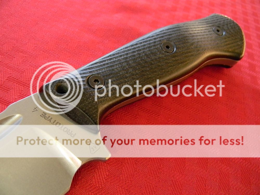

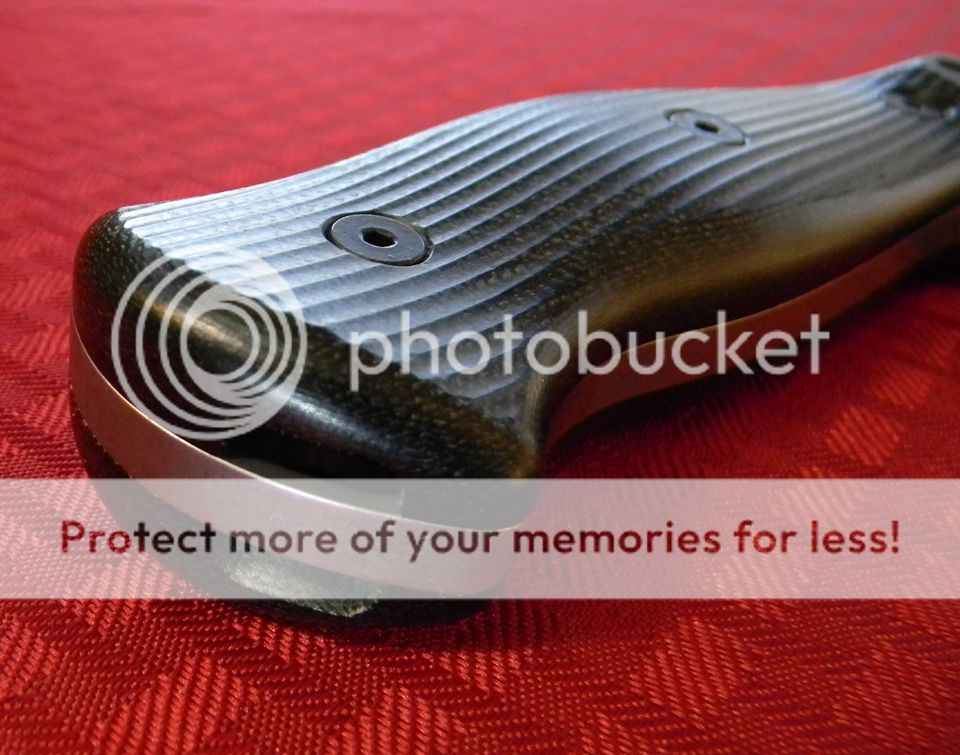

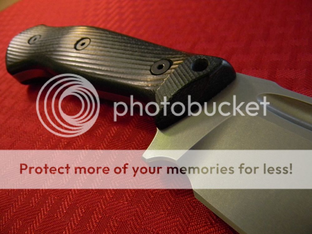

I'll update this old thread. We produce scales in production quantities for manufacturers and mid-tech makers. We specialize in high end full 3D contoured scales.
3.jpg~original
8.jpg~original
10.jpg~original
If your tangs are accurate the scales are bolt on ready to go. If your tangs are waterjet there is a little clean up grinding to get things flush and smooth.
We produce scales in mostly micarta and G10. We can provide material or you can provide your own. Typical minimum quantity is 200 pieces though we will do 100 in certain circumstances. There is a setup fee and unit price with price breaks starting at 1,000 sets. If you're going this route it is best if you let me create the data. Waterjet is a roughing process and it works with crude data. But our scales are fully 3D contoured and machined on high precision CNC machining centers and any flaw in the geometry is visible in the finished work. A tiny intangency can result in a wrinkle when extrapolated into 3D. I have a degree in product design and 15,000 hours experience in 3D CAD doing high end 3D surfacing for plastic industrial design. Use this as a resource to make your finished work its best. A typical project starts with you giving me a handmade 3D prototype of your knife and you let me create both the 3D geometry of the scales that I'm going to make and the 2D DXF file the blades are cut from. This way everything fits.
