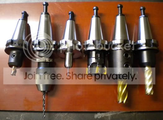

The first thing I do is figure out, in my mind, how I want to go about it and select the cutters I'm going to use so I can write my programs. This is the spread I'll be using:
That's a 1/2" endmill, a .200 drill, a .182" thread mill, a 2" 5flt face mill, a 1" 5flt rougher and a 3/4" 5flt finisher.

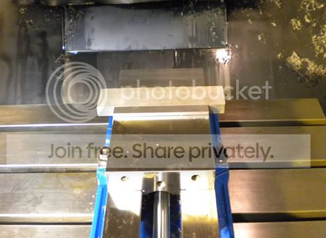

I stick them in the carousel, touch them off and zero out a vice. I saw off a blank and stick it in the vice.
And then mill it.

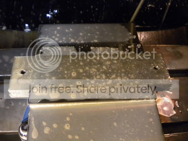

I drilled the holes, applied a chamfer, milled the 1/4-20 threads and squared up the ends. It is wet from the coolant, which is a water oil emulsion.

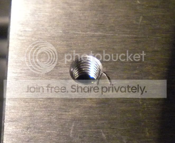

This is what a milled thread looks like:
Shiny huh? I don't remember why I started milling my threads, but I just about don't even use taps any more.

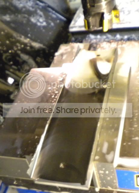

The next step is to cut the radius. Most rational folks would turn it on the side and cut it. But I'm going to rough it out from the top first with a little 2" inserted face mill to save on cutters.

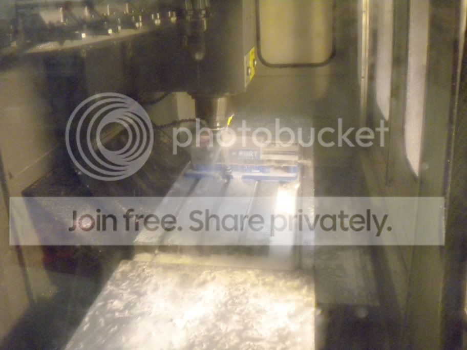

This is what the inside of an old mill looks like while making that cut.
And a picture of a rough milled part

Thread milling involves a little lollipop cutter that has a 60 deg v profile that you run out in a cork screw path (a helix). This is a single profile, so you have to do as many revolutions as you have turns of your thread. That one thread mill can do 1/4" threads to 1/2" threads, and about 28 TPI to prolly 13 TPI. It can chamfer its own thread and it can cut a full form all the way to the bottom of a square hole. In production you frequently use a full form cutter that does the deal in one rotation. They cut internal threads or external threads. The thing I like about them the best is in these plastic manifolds I make. Nice clean threads, no stringy swarf up inside a part where you can't see it. Most folks would tap a 1/4" hole in A2, but you know me.

It can do it in one pass, but that old cutter maybe isn't as sharp as it once was, so I take a spring pass too. You can get a great finish if you bump it up in Z, then again down in Z so it is only cutting on one side. Neat trick for a hand load mold core where you don't want a lot of drag unscrewing it.
