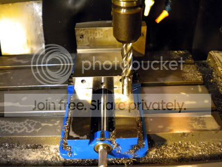

So, I got around to trying a different endmil for my finish cut. This is 1" four flute (carbide). Stiff as hell.
Ahhhh... pay dirt

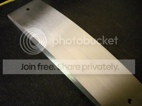

and after a little sanding
I remember some advice my father gave me on my wedding day. He said "Son, life is too short to lap out a bunch of flat platens for people, they can do it themselves"
...Okay, he didn't actually say that... But I still won't be sanding the rest of these, but #1 here is the "set up" piece, so I'll keep it as mine.
They're done Dan. I finished machining all of them last week. Except for HT.
Anybody wanting one soft (so they can drill and tap for a non-KMG setup) can contact me for a soft one right now. I'd even discount it. You'd need a HT setup though.
Otherwise, they'll need to be hardened before I start the sale thread. I've got a dozen out to Peter's HT right now. If they come back good I'll send the balance.

I don't know if that would sand it properly or not. I'm not going to try it because my wheels don't need more wear than they already have. I'm toying with the idea of doing nothing. First, doing nothing would be really easy. Second, doing nothing is already done (I've already done nothing to these). And lastly, I think it will polish out on its own in use pretty quickly. And lastly, lastly, doing nothing reduces the risk of accidentally distorting the (painstakingly accurate) geometry.
... I could be wrong though...

if your worried about surface finish of the part your a fool (its crazy flat but round :) adn smooth)
i hit mine with A45 belt just to clean the HT finish off the platten and then bolted her up and used her
ok first off this is not a platten to just got to and grind a blade out on as it heats up fast best thing to do is flat grind then hollow out from there
all good so far adn i ll hav e the blade im working on to show shortly
also the 4' is a really shallow grind so if you want a grind that shows even a little get the 3 footer

48" radius is .0026" @ 1" grind height and .060" depth
.0104" @ 2" grind height and the same .060" depth at the edge.
These numbers increase to .0035 and .0139" respectively on a 36" radius.
In a perfect world of course....
