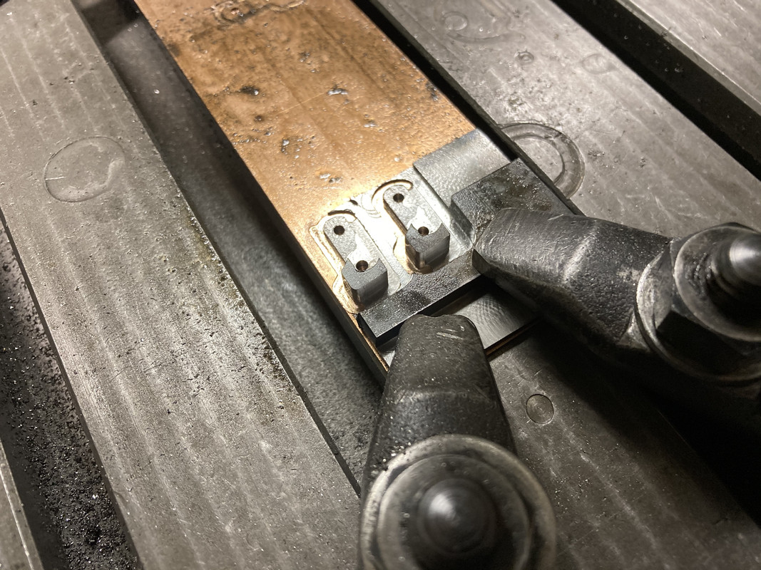

That's a very nice knife! Can you tell us more about the backspring construction? It looks like there are two parts to it.
upload picture
So the RWL-34 part it where the blade tang contacts the backspring, to increase wear resistance and reduce galling?
