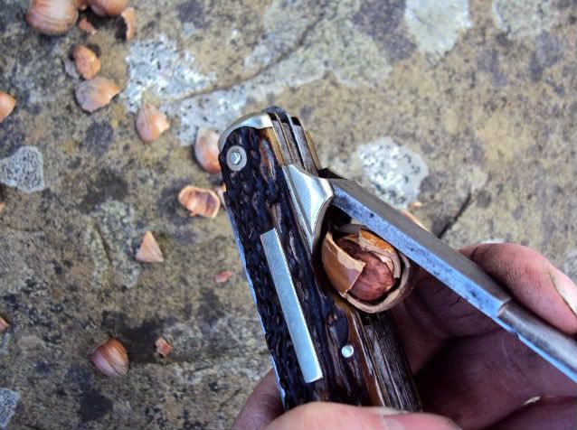

Hi Mick,
What a pretty picture those four make. Prettier still that you chose to show them with hazel nuts (Filberts.) Especially as all four knives are equipped with nut crackers!
Jim Taylor.
Jim, I was experimenting cracking hazelnuts with those knives, the large 6 1/4" Holtzapffel broke them with ease as did the 4 3/4" Rodgers. The 4 1/4" Turner would brake nuts, at a push, but I was afraid to try :rolleyes:. The 3 1/2" knife is too small...

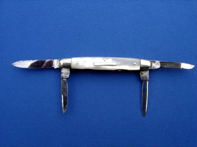

MOP 4 blade senator, 2.5" closed. Marked "JAMES BODEN SHEFFIELD".
From Geoffrey Tweedale's wonderful new book on Sheffield cutlery manufacturers:
A manufacturer of "fine pen and pocket knives"...born in about 1815. By 1841, he was listed as a spring knife cutler....He employed 20 men and boys in 1871, but the number was a dozen in 1881..In January 1872 he appeared in court as a witness to testify that he had been marking knives 'L. Rodgers' for William Jackson & Co. - a fictitious mark that was clearly intended to mimic the famous name of Joseph Rodgers & Sons. He died on 28 September 1886, aged 72.
The quality of this little knife, with sunk joints and recessed nail nicks, would indicate that Boden's craftsmanship was every bit the equal of the more well-known firm. Then as now, however, some people prefer to buy a name.
^^ A very nice and tidy compact little four bladed James Boden penknife there Berkley :thumbup:, great to see a knife made by one of the smaller Victorian era makers.
Tweedale's Directory….certainly paints a colourful picture of old Sheffield, he tells us in quite some detail about the many makers associated with the cutlery trade..a great book.
Mick

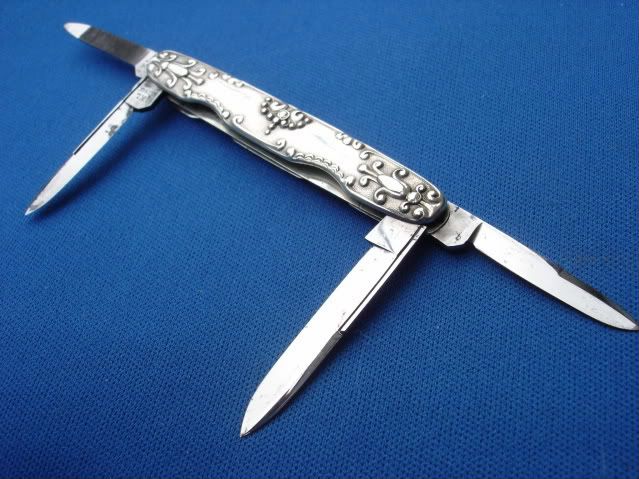

Here's another fine Victorian 2 1/2" Senator, all the blades are marked I*XL, GEORGE WOSTENHOLM, SHEFFIELD, guessing made C1890, silver scales and centre liner, the backsprings have a silver overlay, sunken joints..all the blades walk and talk very crisply.
Mick
All that fine work in such a small package! It is just amazing to think of the skill and ability required to produce that tiny work of art.
Done today, it would probably be fairly priced at ten times the cost of a work-a-day two blade production trapper.
Thanks for bringing the museum to the gawker, Mick!!

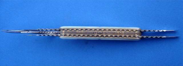

I knew I'd seen a small JAMES BODEN, SHEFFIELD four bladed Senator before, here it is, a little spotty but unused, really nice quality...

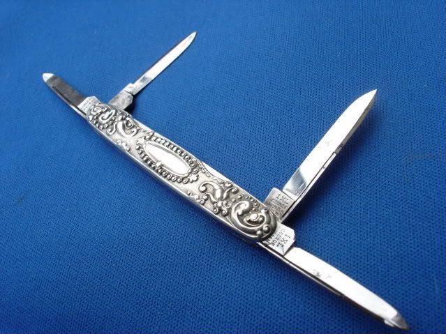

Here's an excellent top of the line 3 1/4" shadow three thick Victorian era H G LONG & Co, SHEFFIELD (crossed swords logo) gents pocket knife, super pearl, milled liners, gilded and fileworked inside and out, the blades look unused and unsharpened..
Thanks for looking,
Mick

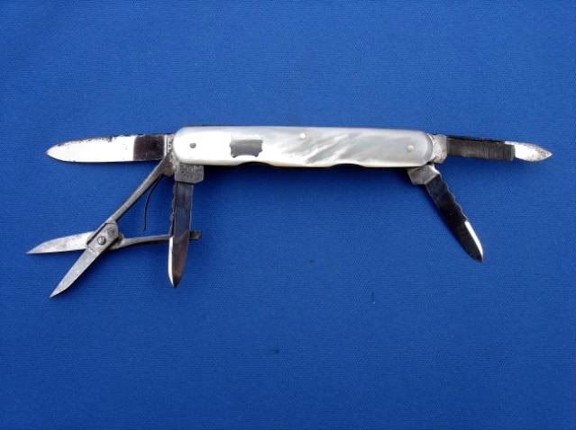

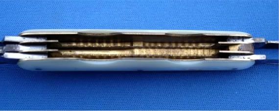

Hi Mick,
You keep on slipping these high quality folders into this thread and we all benefit. Thank you so much.
This one is just that little bit different, having the folding scissors as the "master" blade.
As you know, in the US this pattern has become known as a "Five blade whittler. ALWAYS top-of-the-line and just as pretty as a picture.
Jim Taylor.
Thanks for the comments Jim & Rob.
Jim, now you mention it these five blade whittlers, three thick with a full length central blade (or scissors), always seem to be really well made, usually in a shadow pattern, pearl scales and smothered in filework, they must be top of the line knives, great things.
Rob, delighted you like the knives however neither is a Congress pattern, they always have a sheepfoot master and a slightly hollowed back...I think ?.
