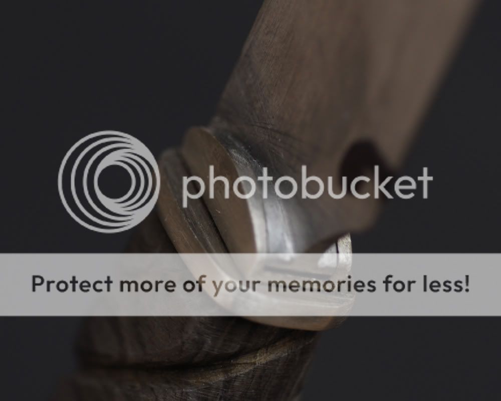

Sorry for the long delay on this Collab. I finally got some shop time after a very busy holiday season. I managed to order some .096" German Silver sheet from Sheffield and it arrived Yesterday. I was able to Heat and shape the "Cup" (What should I be calling this?) It is still very rough, the gap is so that I can press fit tight after Jason does the HT. I also need to trim down the sides a little bit more.
Questions and comments appreciated. I will have some more shop time tomorrow and will be cleaning up this piece and fitting the piece that goes between the Ironwood and Wrought Iron Piece.

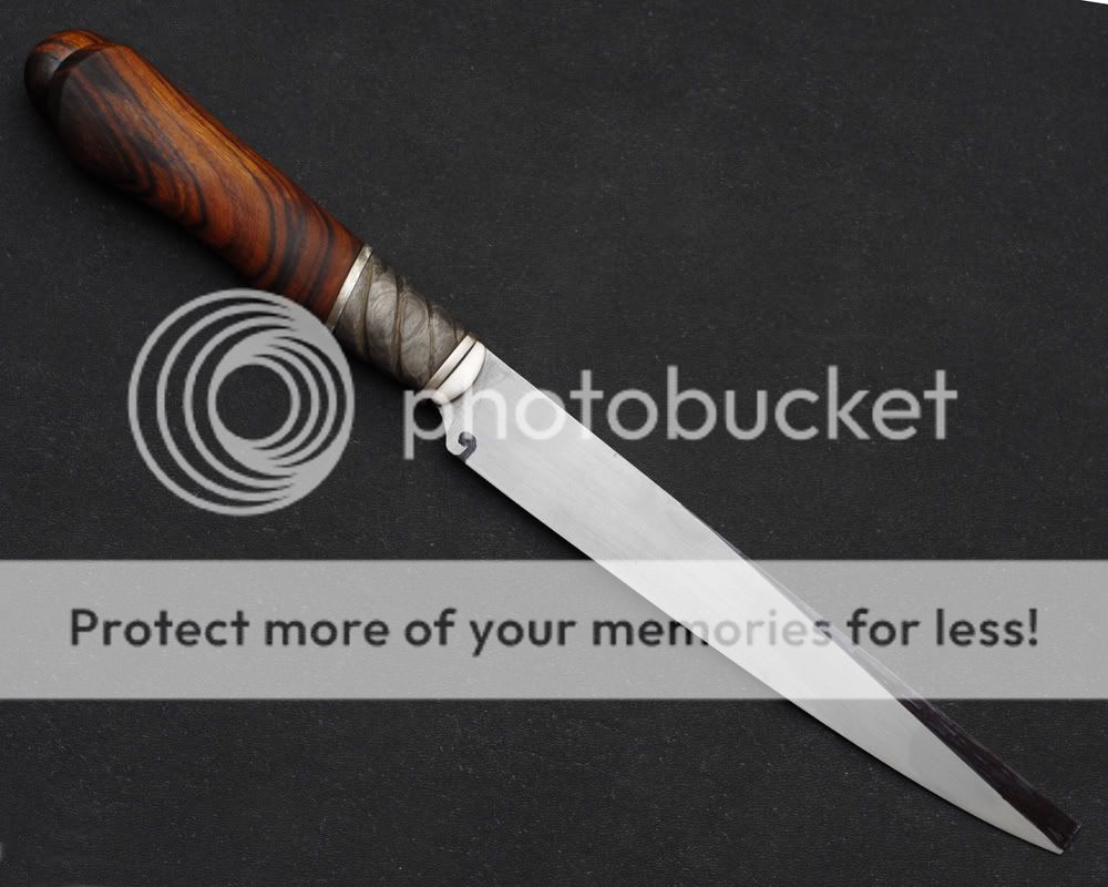

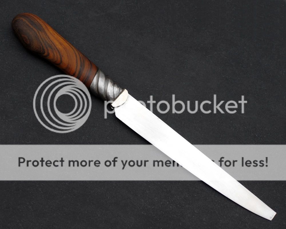

OK I apologize for taking so long on this, OKCA and customer orders have occupied my every spare moment. I spent most of today working on special projects.
I made some pretty positive (in my mind) progress on this build.

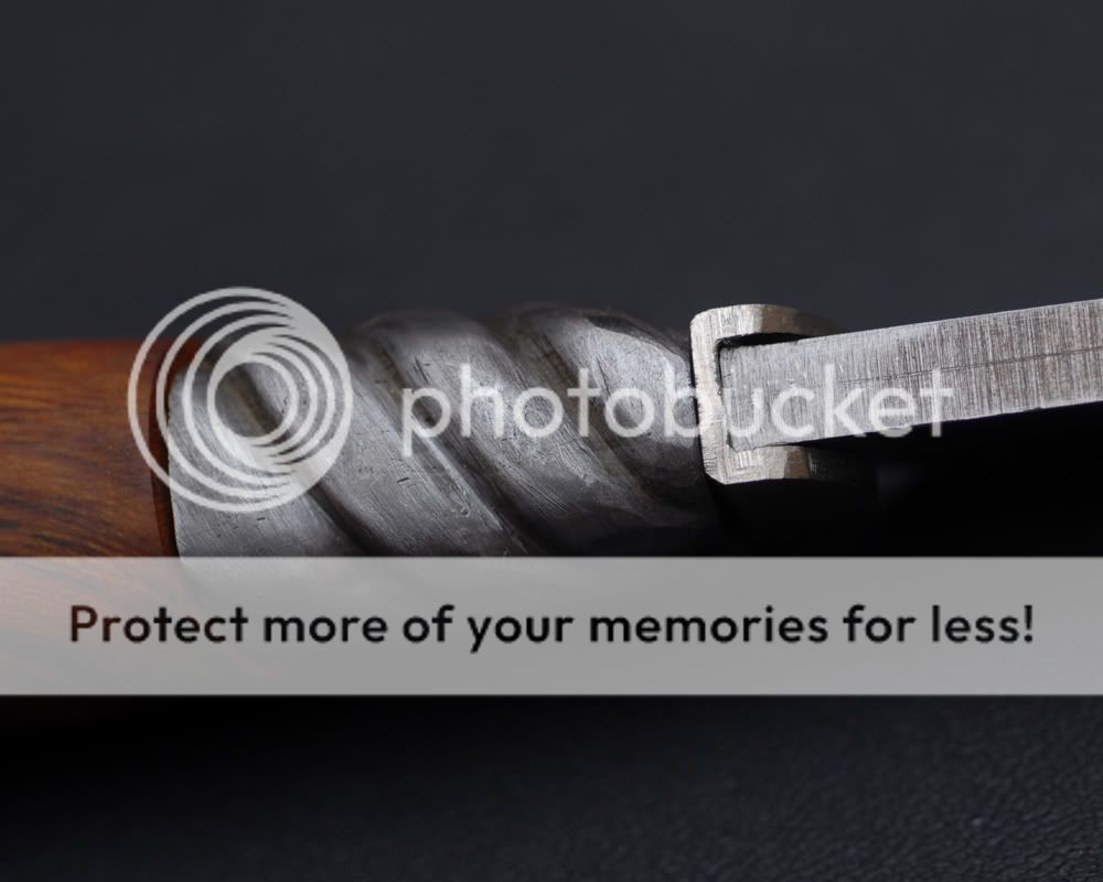

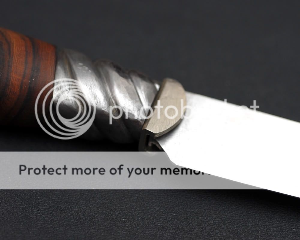

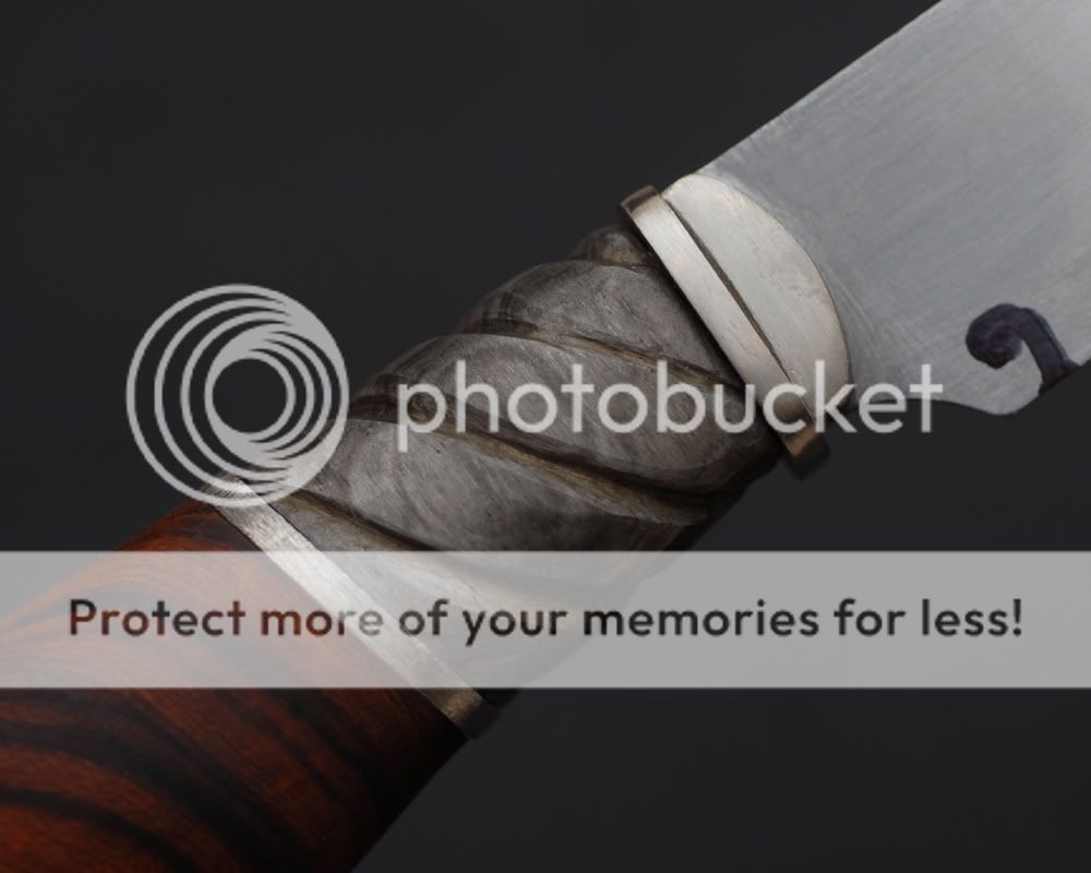

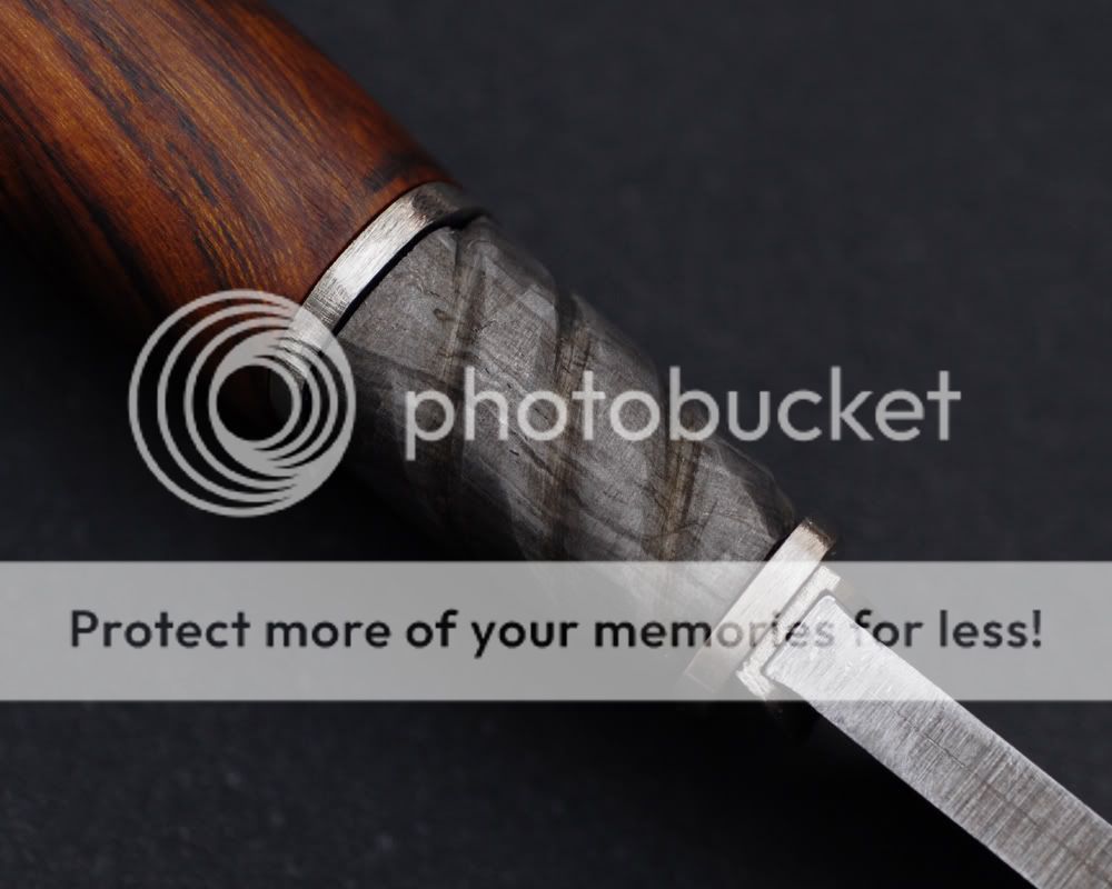

I have fitted all the parts to the tang, they need to be cleaned up as you can see in the photos. I really like the Wrought Iron bookended with the German Silver. I am not going to carry the rope pattern into it, It will terminate as it does in the photos. I will be working on mating everything together cleanly.

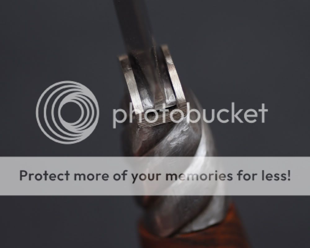

I am going to bring the rope pattern filing in deeper which will also help reduce the weight of the wrought iron.
These gaps will close on final fitting after Jason does the HT

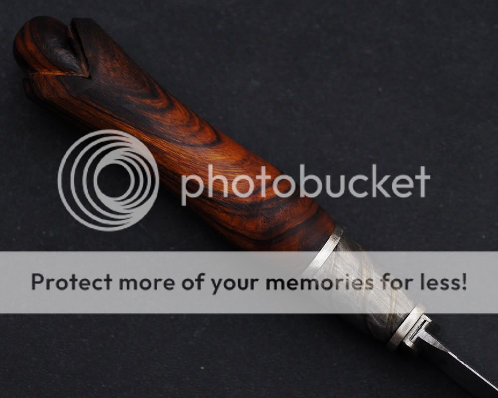

I am still working on the Pomel/Butt Carving, I am considering checkering the "round" portion to add some depth and contrast.
I would love to hear your comments!
There are a lot of cool elements going on with this one! It sort of has a belduque look to it, very nice.
Thanks Ben I appreciate it, I did some research on Spanish / Mediterranean Dirks when this arrived in the mail and really liked the Belduque style.
