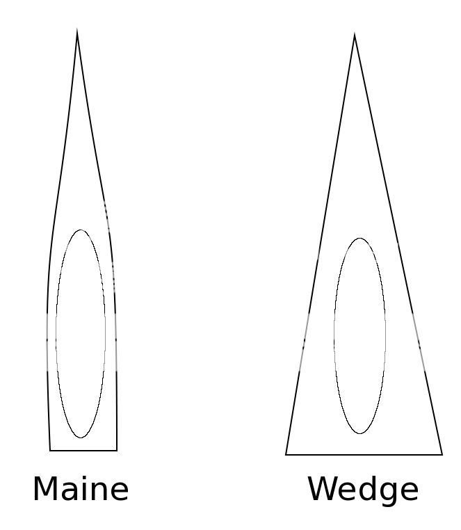

I love the Maine pattern, and not just because of it coming from my state! It just too bad folks often confuse it with wedge-pattern axes. A good Maine pattern may have a similar profile, but the top down view isn't so...uh...wedgie! :p
I always thought of the wedge as the quintessential Maine pattern. Of course lots of companies in Maine made axes that werent wedge patterns. The good wedge patterns that are profiled right are good choppers, they have to have a thin taper to the wedge though. You could probably hit the middle of it with calipers and it wouldnt be that much thicker than the high centerline on a typical american axe. As long as the shape isnt overly round they cut great in the timber around here.
Personally the true Wedge patterns I've seen literally look like a splitting wedge with an eye in it. In profile view they look like a Maine pattern but top down the poll is much broader and is pretty much of true taper from the poll to the edge.
Edit: quick sketch
There is a lot of variability from say, a newer and a later snow & nealley for example. the earlier ones were more like the one on the right, although if you straight edge it there is some hollowing in front of the eye/on the upper cheek to make a thin enough bit possible. sort of a hybrid between the two. The later ones, from what I can tell, looked more like the left sketch. I have a 2 pound snow & nealley that is probably from between 1965 and 1980 or something that has a more flowing rounded profile. More high centerline on it, but still short bit and heavy poll.
Many Maine makers DID also make Wedge patterns, too, so that confuses the issue.
