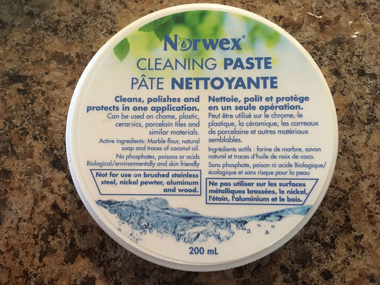

Most of my knife task call for cutting food for my daughters. Ive been using this as it's natural. I could even eat it directly and not be harmed. Not pushing it, but my wife sells it so we get a discount. Just rub on, rub off, add some oil to the joints, and clean out the interior.
