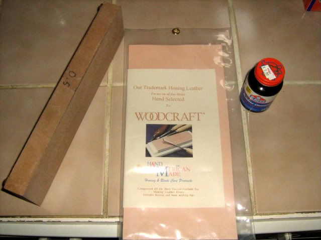

You will need to start with a good base and quality leather. For me I like MDF as my base and my leather of choice is Hand American compressed 4/5 Oz. bark tanned cowhide. I have tried a few different types of glue and found that rubber cement seems to work the best.

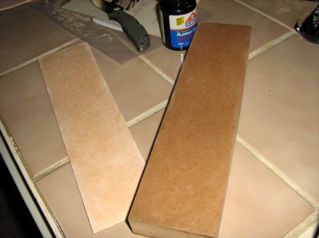

Cut the leather just slightly larger than the strop base. Apply rubber cement to strop base and ruff side of leather, all that is needed is a very lite coat just enough to make it look wet.

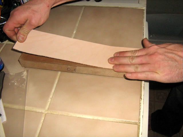

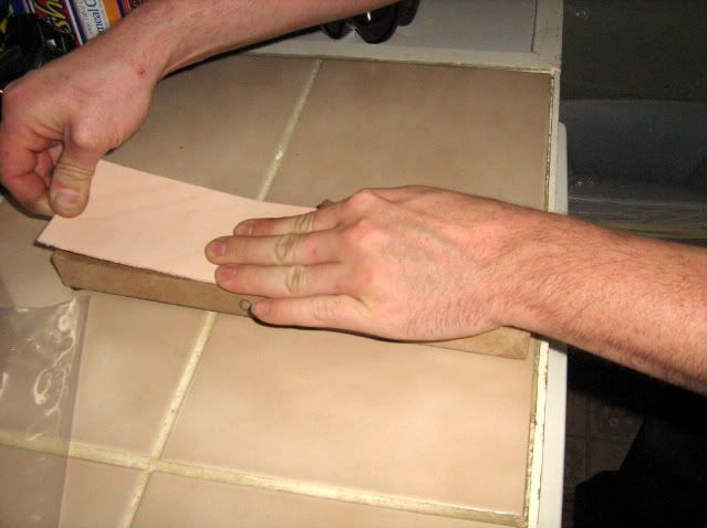

When the rubber cement has dried it is ready to be put together. Start at one end making contact with the last 1/2 inch of leather and strop base. Pulling from the other end to ensure the leather does not bunch up and is smooth when finished use your fingers and rub the leather on to the surface.
Take you time when doing this, you may need to move the leather from side to side to keep it even on the base as you stretch it. Not much movement, just enough to keep the leather stright on the strop.

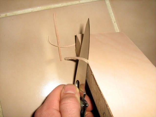

After the leather is pressed down go over it again with your fingers or a roller to make sure it has made contact in all places. You can then trim the edges, a thin blade works best.

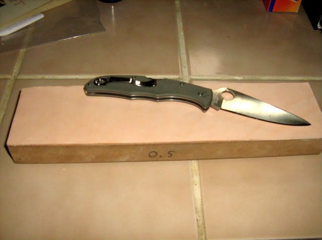

After all the blood, sweat, tears and hard work :p the strop is ready.
