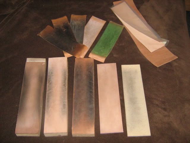

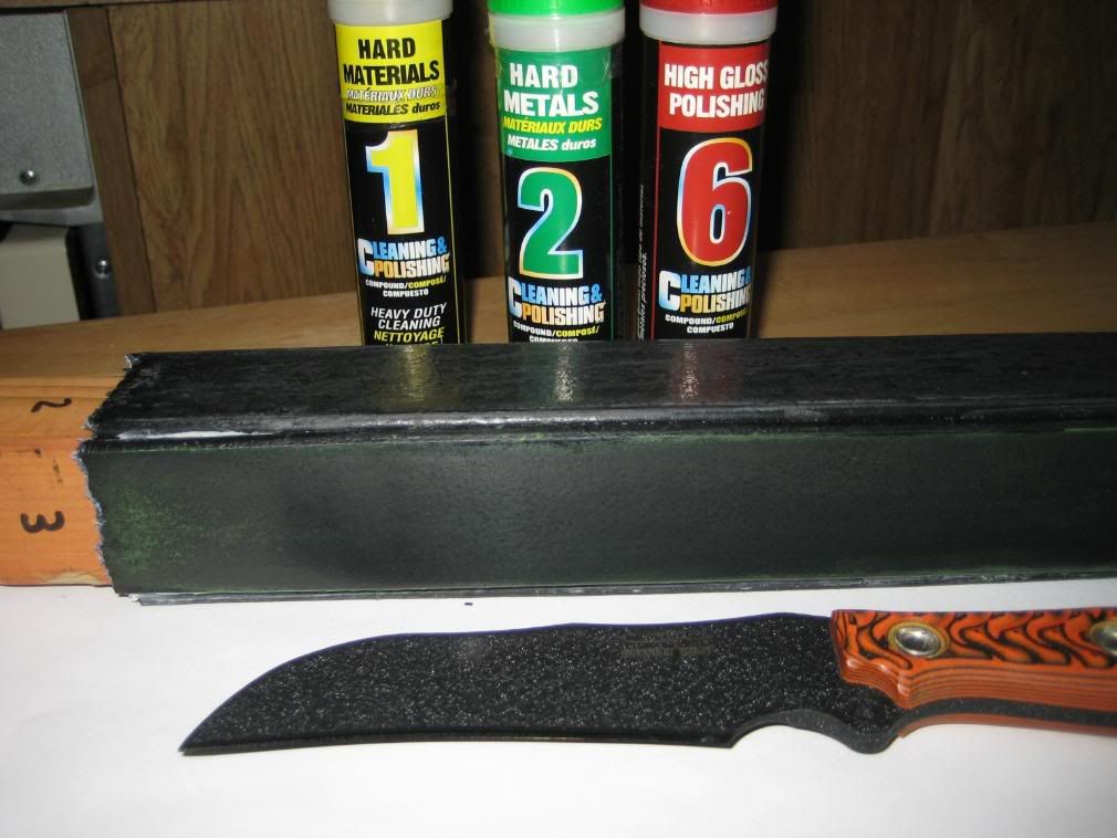

here is my ghetto strop bat. I broke a new belt, and cut it up. I use ghetto buffing compound from the hard ware store, but it works.

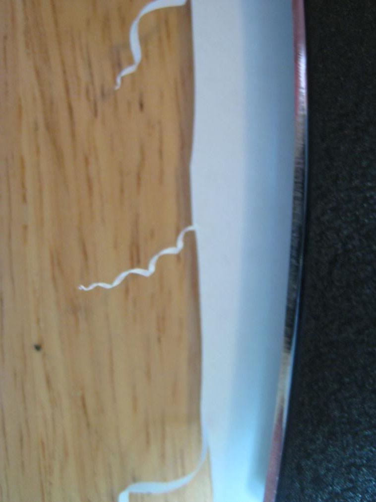

This is a v grind at this point. Just a bit of stropping with the loaded strop and it was hair popping sharp.

Next I want to actually use quality leather and good quality compound.
