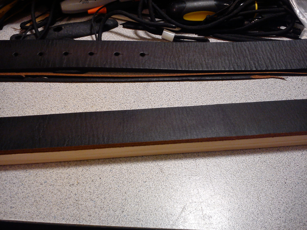

Awhile back I talked to a couple of folks and they were wanting to know how to go about making a decent strop. Unfortunately I wasn't able to get my hands on any sizable pieces of leather, so I made do with what I could scrounge together. For now. ;)

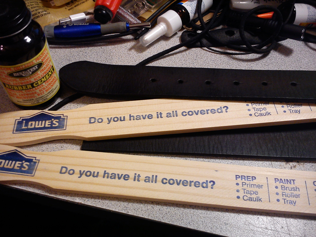

I wanted to make one on the cheap, and cheaply 'twas made. Hit the local goodwill and struck out, but managed to find what I was after at a local outlet store. Leather belt, on clearance ($2), no weird stitching or odd material, just good 'ole leather. It was already dyed, but that didn't matter for what I was after, and it had an odd texture, but as you'll see, that didn't matter either.
Also needed were two of the heavy duty paint sticks from Lowe's. They keep them behind the counter, and they are free. About a quarter inch thick, two of them together make for a fairly decent base for your strop. Using contact cement (rubber cement) I applied a generous amount to the faces of each of the paint stir sticks (this way when you are done you don't have all the Lowe's advertising showing) and wait for them to dry. Once dry, apply the faces and press them together. I used speed clamps to make this happen.
Like the paint stick says, make sure to have it all covered. ;)

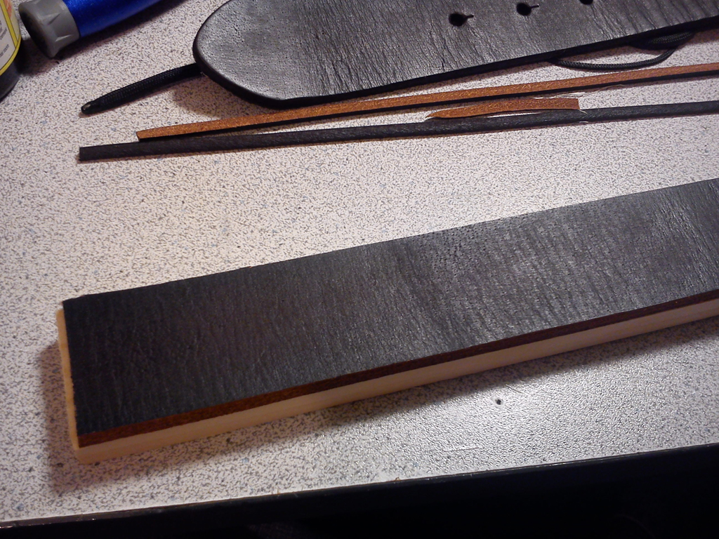

Then, cut the belt to length. At this point the belt was too wide. I clamped the stick on top of the belt on my desk and trimmed the sides of the belt, but you can easily do this after you attach the leather to the strop. Here again, use the rubber cement. Coat one side of the leather, and the face side of the strop. The side of the leather you have facing up is up to you. I've used the rough side, this time we'll use the smooth side face up.

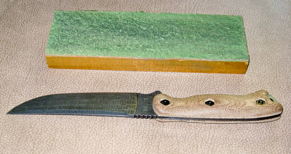

Once the leather is attached, you will have for all intents and purposes a strop, but this one had a texture to the leather on the smooth side, and we don't want that. So I hit it with the sandpaper. (This made a huge mess btw.) Once that is finished, apply your strop compound of choice (this time I went with green) and voila! Strop.
I got a little overzealous and attempted to melt some of the stropping compound into the face of the strop, which was exactly what I didn't need to do. I ended up going back and sanding off the ridiculous amount of compound I had dripped onto the strop. Once I got it cleaned up I simply rubbed the compound onto the strop until I had a decent coverage. Hope this helps those that are wanting to make a strop for themselves.
There are a ton of threads on this already, but this is how I go about it. Once I get my hands on a larger chunk of leather I'll post up a part 2 with something a little more sizable.

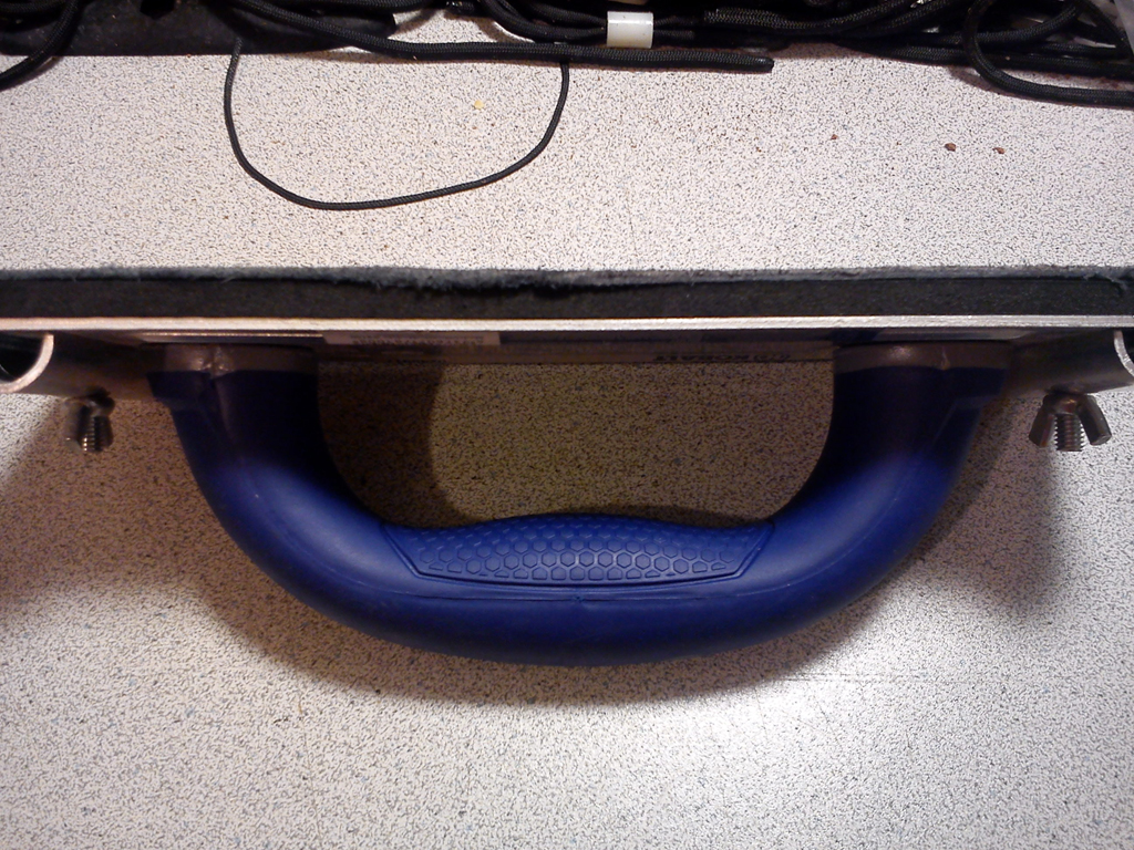

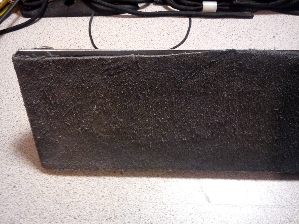

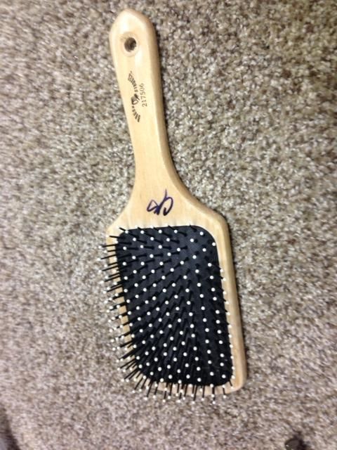

OK Derek and Nikki, here you go. Derek you will have to look for a hair brush from the wife but Nikki may already have one.
This measures 3.25 X 4.75.
First pull out the bristle pad; glue in some paint stir sticks and sand then then varnish. Glue on the leather with contact cement and cut around the edges. This one is not yet done.

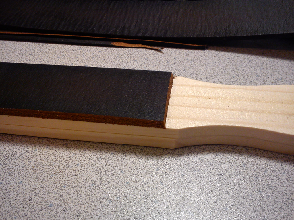

I made a 2x8 inch one out of some 1x2 white pine I had lying around and cut leather out of the top of an old work boot. The leather is a little thin and haven't gotten a chance to use it much yet but just shows that there isn't really any need to spend money on one.

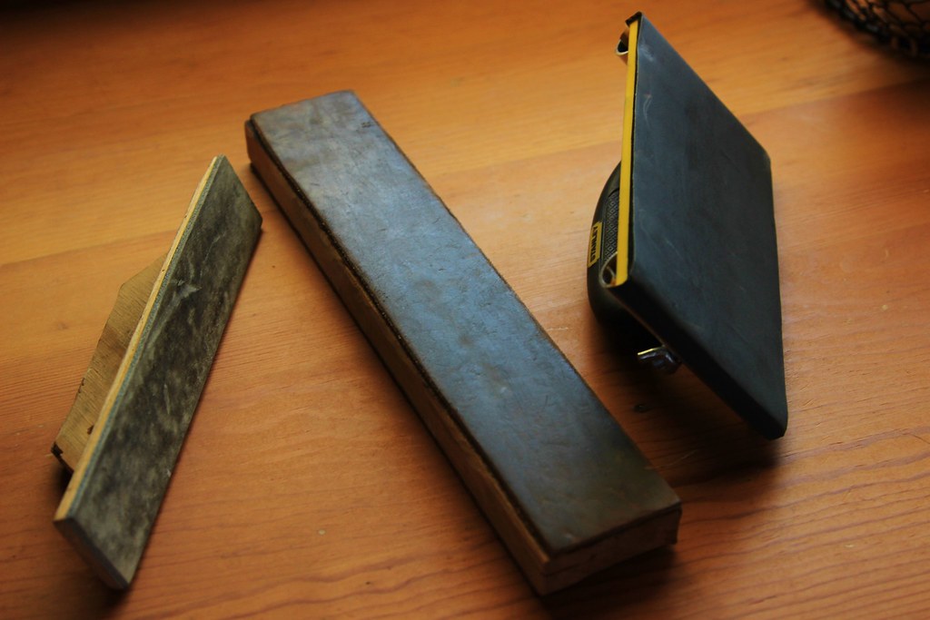

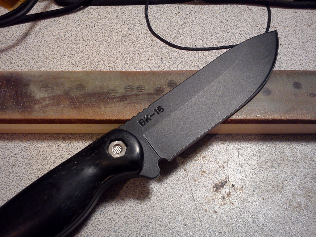

I use the sander for wet/dry in various grits, usually 800 for a nice toothy edge. Haven't used leather on it but may give it a try sometime. For stropping I've had these two for years. The one in the middle is black compound on one side, green on the other and only been loaded once. Most people use way too much compound. Doesn't take much and I'm a huge fan of black compound.
Oops, knew I was forgetting something. I put that chunk of leather on there and never took it off because it worked so darn well. (That is that chunk I told you about that takes something from SHARP to CRAZY STUPID SHARP. Have no idea why either, but it works. Never was able to find sandpaper in the medium to high grits that was long enough to fit. Do you buy full sheets of the higher grit stuff and cut to fit, or is there sets of the good stuff out there that is long enough?
What surprises me is that if I buy one of those, in the sanding section, the sandpaper that has been next to it that comes in the 1/3 sheet strips has never been long enough. That always perplexed me to no end.
