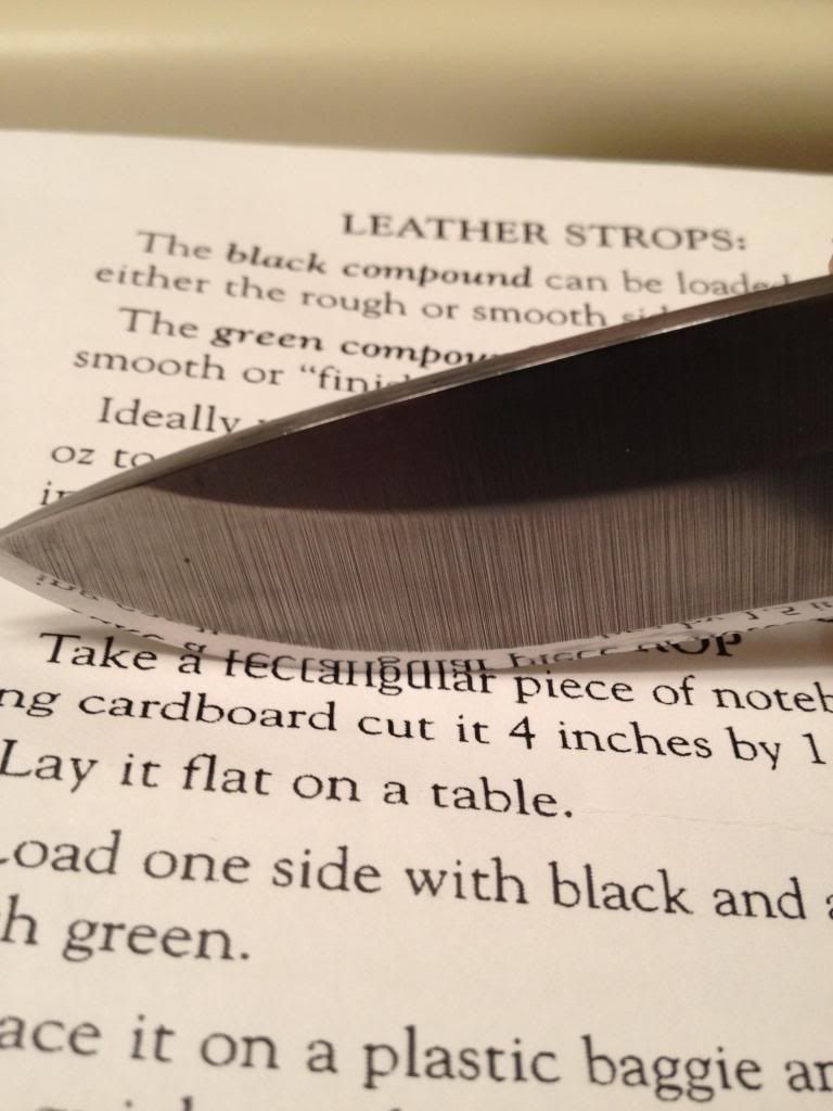

So last night whilst sitting in front of the boob tube I decided to try my hand at stropping. Used Autosol metal polish - all I had handy at the time - and grabbed my 16. Man big mistake. After watching YouTube vids and reading dozens of posts around here over the week, I still used WAY too much pressure. Ended up rounding the edge off to about the sharpness of a butter knife. I mean the spine edge of a butter knife. Oh well, broke out the Lansky and reprofiled the edge, and started round 2 with the strop. This time used LIGHT even pressure, and really paid attention to the angle when drawing the knife across. Much better results this time. Definitely sharper than using the Lansky stones alone - shaves arm hairs easier than before, and the bevel is a lot smoother and shinier than when I started. Still not the fabled razor sharp slicing thru newspaper though. Still have a ton to learn about stropping, and sharpening in general, but this project was a good start in my journey. Need to get some bench stones to learn on, as well as some proper polishing compounds. Keep learning...

Finally got around to testing my new strop with autosol. I never knew some polishing compound could make such a difference.

Ok, so I have an old peice of leather I was going to use....but my roomie hid it well apparently. So I broke down and ordered a strop and some compound last week. So the compound came in yesterday, and I found the old peice of leather. I was so excited I just layed the leather flat on the counter and loaded it with the compound that had just come in and....oh...my....goodness. I have finally acheived scary sharp....like cutting circles in paper...my arms have no hair now...I'm just floored at how easy and effective using a strop is. Years of sharpening fustration out the window. So here is a quick pic of the finished product.

Woah, mirror finish! Looks great and I bet it slices very nicely.
Thank you sir!
And yes, it slices pretty good (a thinner blade will win though), and I can shave my face with it Dundee style :D
