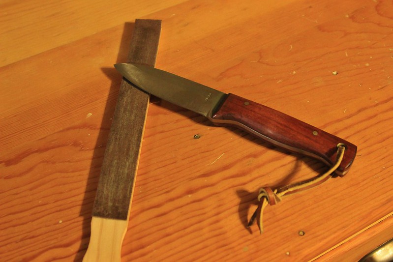

Found a scrap of leather and slapped it on a paint stir stick rough side up (carpenter's glue works great) today. Colored some green compound on it and by golly it's the bomb.
Best finishing strop I've ever used. Ludicrously sharp. I'm a convert.

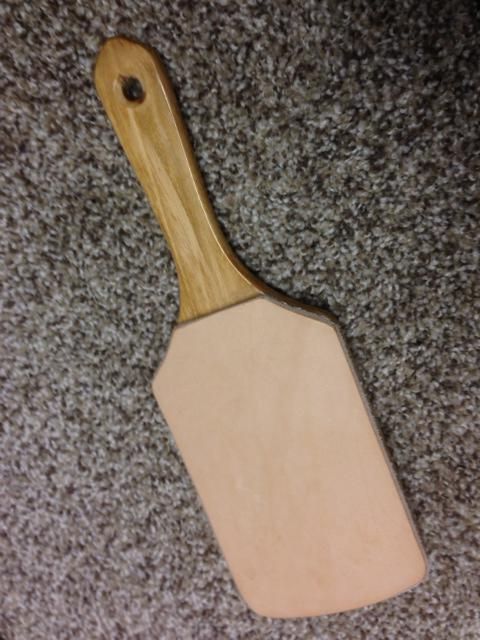

Here is the update on the strop made from a brush handle. Hey, it's what I had, and I already had a bench strop. So something smaller was OK for me.
