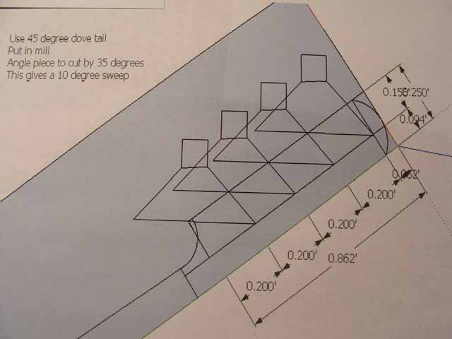

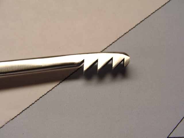

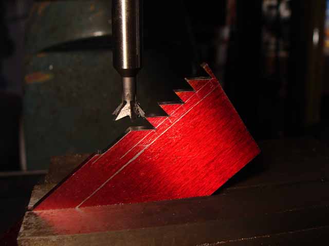

Here are some pix of Eric Fleming's design (from http://www.flemingknives.com/misctools.htm)....
I made a pair from O-1 a couple of years ago and have even used them to enlarge slots in mild steel guards. If you do hidden tang knives these are a must.
Hey Phil,
Thanks for posting those pics. I was just about to look them up to post as well but you had beat me to it. Using the angles laid out in the drawing gives uniform cutting teeth at a good cutting angle. I've made a few of these now and all work fantastic. They are pretty easy to make as well. More detailed pictures are on my web site under shop tour and misc tools. I just happened to have some O1 laying around in the right thicknesses so that's what I used. These are at 61 HRC.

Wow. Nice guys. Those are great. And Phil... I don't know what to say, man :) I forgot if I mentioned this in the Caffrey post, but I do take a little off of the side of every-other tooth, so as to provide a little of what on a saw would be called an "offset." In my thinking, it allows each tooth to grab a little deeper. Just seems to work good for me. And don't worry about the tooth angle too much, if it doesn't work, then you have it wrong - kinda simple that way. Anyway, here they are again, but keep in mind that Ed did give me a very fine damascus head hammer in trade. I had to make them nice, yaknow?
