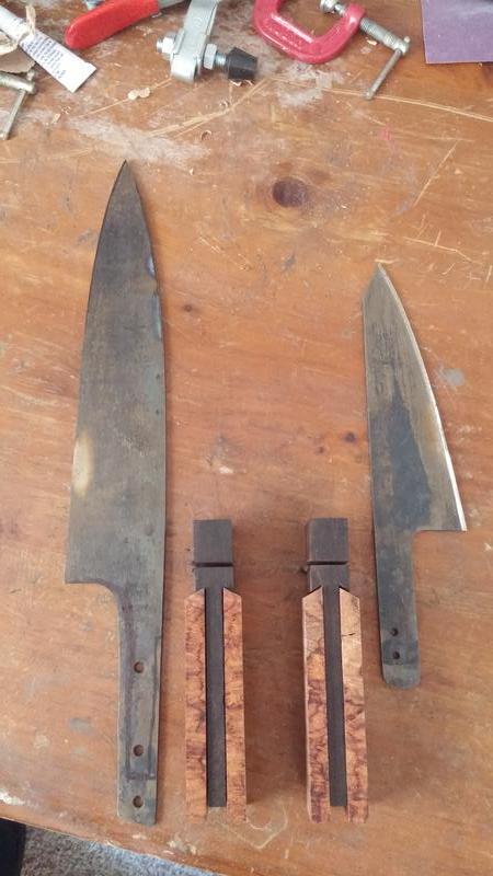

Thanks, yours is looking fantastic too. Mine is honduran rosewood burl ....it looks so very similar to the amboyna burl. I also feel it pairs great with bog oak and blackwood especially.
Oh very nice, that stuff is top notch!
Sweet!!!! I like rosewood burl better than amboyna and that's saying something because I really like amboyna. Who is Cody Paul? What wood did he use?

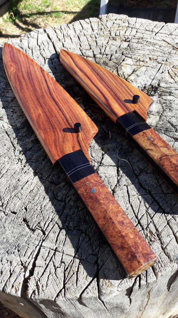

Finally got these pair done...sayas done by Cody Paul

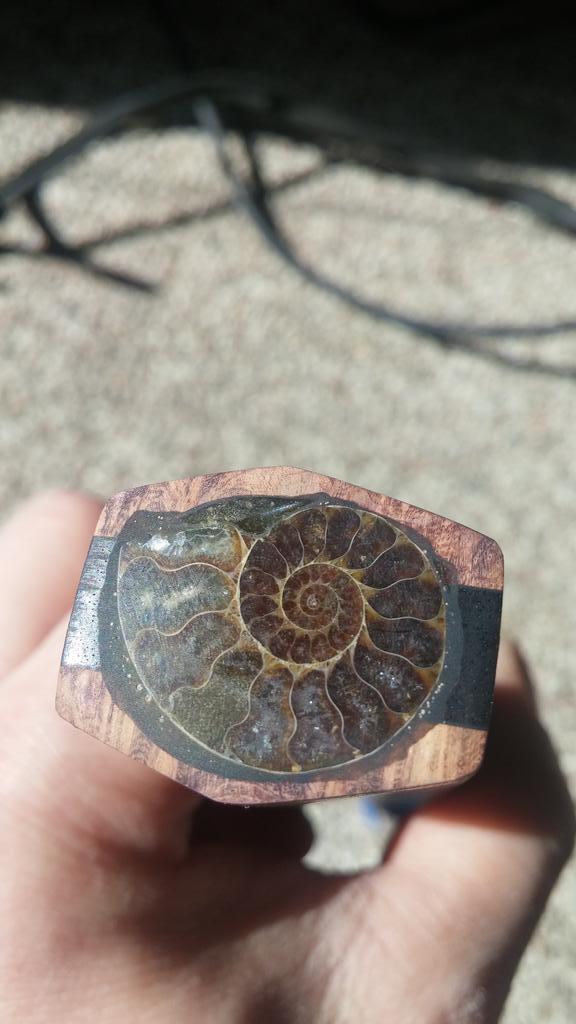

Cody used Bolivian Rosewood. The only Amboyna I have used was actually nicer than the honduran rosewood IMO. It had zero voids and a brighter hue. I also inlayed some ammonite's into the butt end of these, It came out ok but I would probably approach that differently next time.

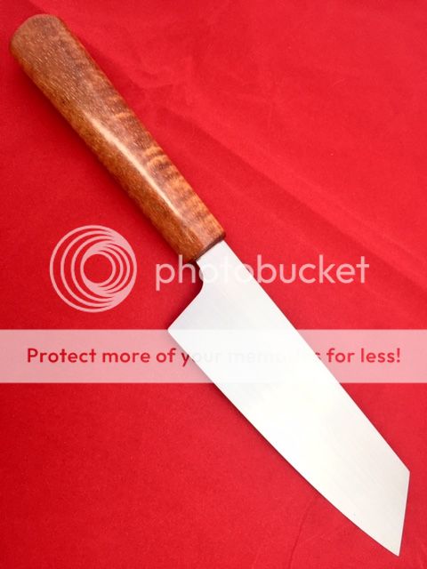

"I was told the higher chromium steels had too course grain to be acceptable for kitchen knives." Definitely not necessarily the case. AEB-L has over twice the Cr of A2, and we all know how fine the grain in that steel can be! If it's a kitchen knife that might see protein slicing duty quite heavily, I bet even D2 would work very well (probably best with the cutlery grade HT instead of industry standard HT). D2 and AEB-L have roughly the same Cr %, but the much higher Carbon % in D2 causes those large clunky carbides, while the relatively low Carbon % in AEB-L allows for the very small Cr carbides. You might even experiment with "pre-quench" on A2 for kitchen knives. Not the same as double quench, but pre-quenching (from what I gather) puts some carbon in solution up front allowing for lower hardening temp/shorter soak time. Thus smaller aus grain. Sub Zero "should" be used with A2, as well, due to higher RA levels, if not full on cryo temps. Speaking of Chromium in kitchen knife steels, here is a pic of my latest kitchen knife, a Tosogata inspired Santoku with Aldo's 52100 at 65HRC (normalized 1700F, 3x cycles, 1475F 10 minute soak, P50, 300F 2hours 3x). Edge was taken to "zero" with the full flat grind, and then sanded back just enough to reflect light and allow some meat for the edge. Took about 5 minutes to sharpen with the 1200 mesh DiaSharp, then refined with the EEF DiaSharp, 15° per side. It is incredibly sharp! For sale in the exchange if interested.
