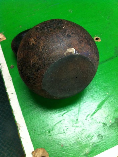

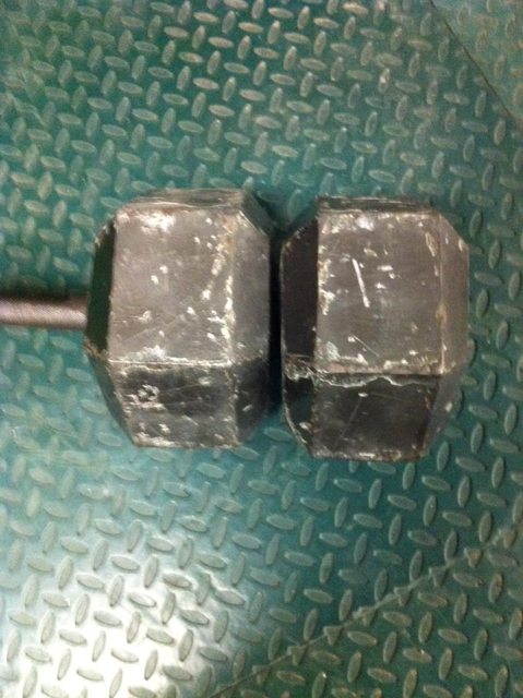

What I'm still stuck on is a good anvil solution. A real one is impossible to find here and prohibitively expensive, but I've got some ideas! I'm a strength coach, so I've got a bunch of equipment laying around:
These are broken 100 lbs dumbells. Each one of those weighs 50 lbs, but I'm pretty sure they're cast iron. Also, its hard to see but they're slightly rounded at the ends, not flat. I have up to 3 of those that I could probably plane down and stack on top of each other.
This is a 50 lbs kettlebell with a very flat bottom surface, but I'm pretty sure it's also cast iron.

My plan is to put either the stack of dumbbell ends or the kettlebell into a bucket of concrete and have a buddy weld the steel block to the top, then somehow secure the whole deal to a tree stump or a table.

I think the best makeshift anvil I have seen is a 4x4x24 steel bar in a bucket of cement, the guy also stuck 3-3/8 eye hooks into the side of the bucket before he poured the cement and used 3/8 hook turnbuckles to secure the whole deal to the stump
I would be a little concerned about the hardened steel as the alvil, depending on hard it is it could be on the chippy side, and when you chip a piece of steel the chip comes flying off at a zillion miles per hour and WILL embed itself into your skin or eye or whatever
I was worried about that too, but it's advertised as a jeweler's block for light hammering so I'm hoping it will hold up. It would probably be better than using the bottom surface of the kettlebell, right? Maybe I can anneal at home successfully?
I've seen those sea anvils made out of solid bar but even at scrap prices it's expensive, not to mention hard to find. The DB and the KB I have for free, and it's hard to pass up 50-150 lbs of free dense metal to use. The eye hook/turnbuckle idea is great though, that's a huge tip, thank you.
If your 4x4 was made specifically for hammering you should be good to go, I dont see anything good coming from using the cast as the anvil face

I'd personally avoid both of those choices as a makeshift anvil; they're likely cast iron rather than steel...

Would cast iron still be a problem even with that steel block face welded to them? I'd like to make a good solid post anvil, but free is always better than relatively cheap.
