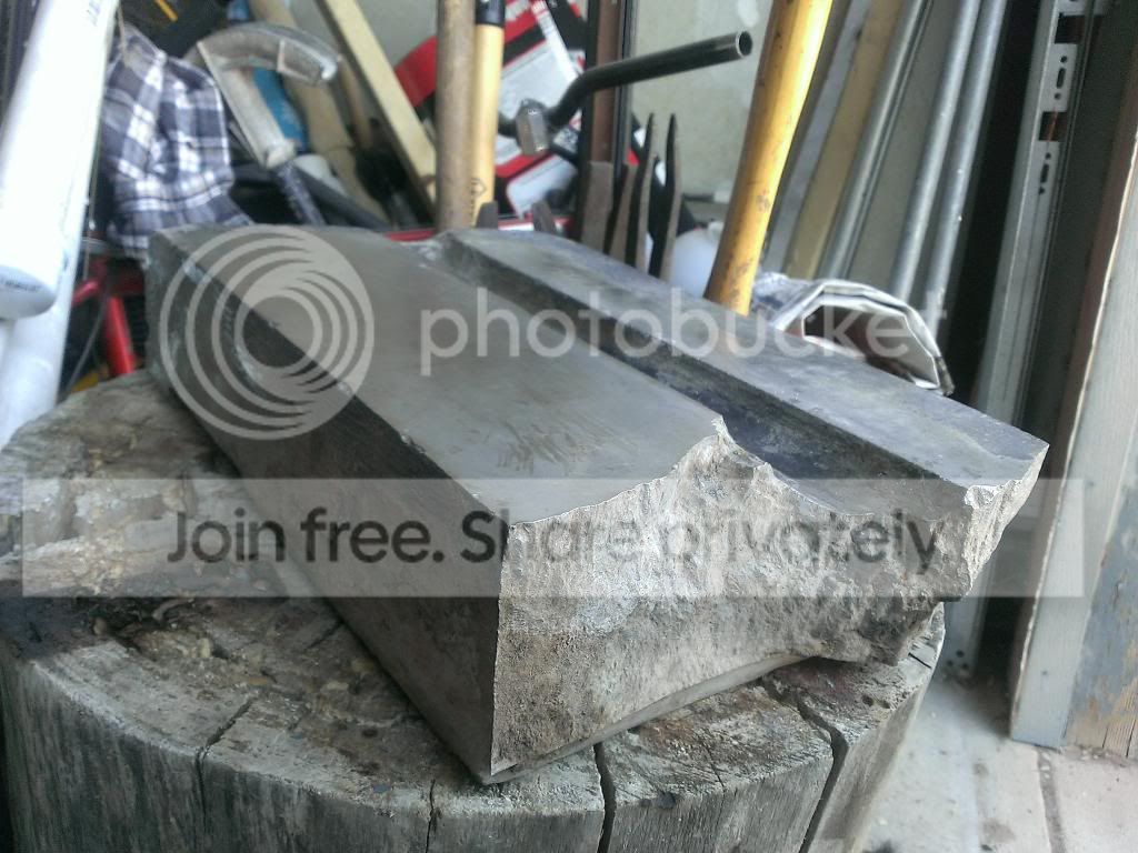

This is my starter anvil:
It's a piece of rock-crusher jaw. I don't know the exact composition but it weighs about 135# and rebounds the hammer like crazy. It was given to me gratis by the local scrapper after some chatting. Build a network in your area, when you're working on the cheap it pays to have friends.
