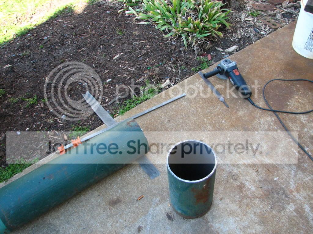

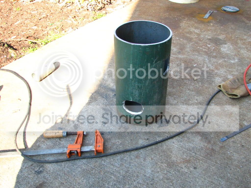

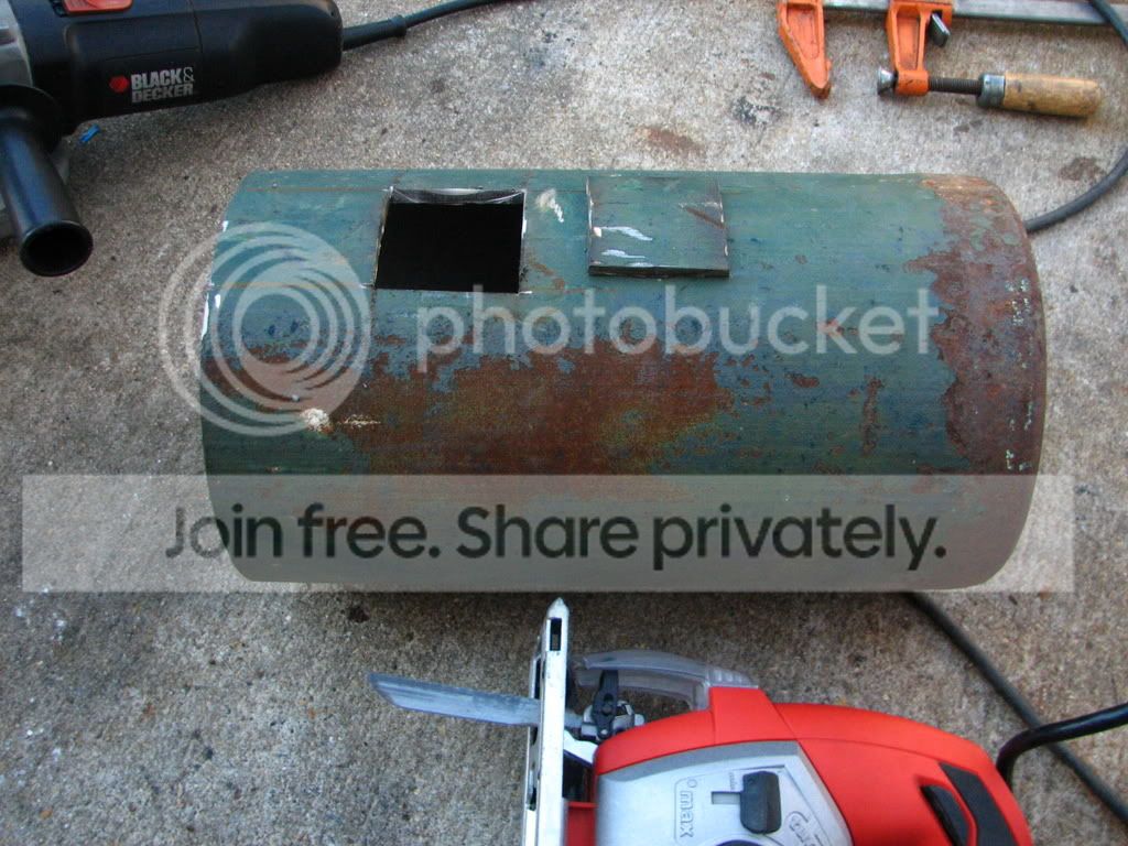

Here is what i have been working on all afternoon.

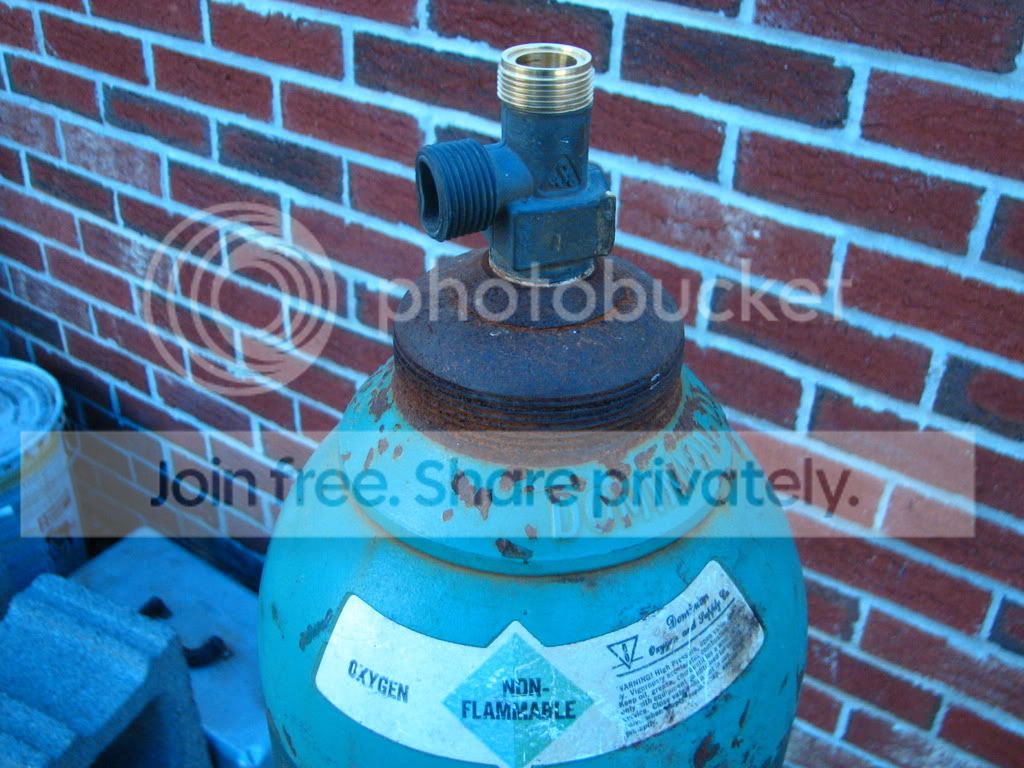

First we have the tank i picked up at the dump

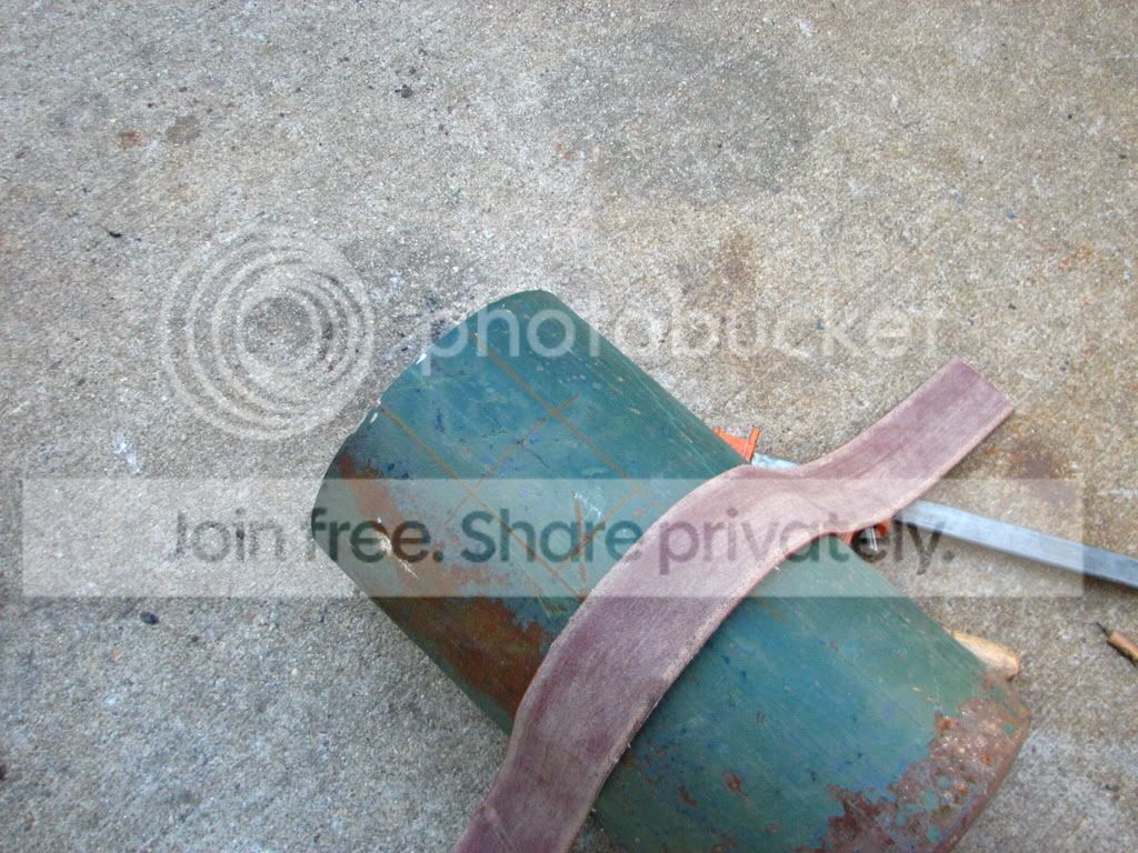

then we have me marking at the right hight to cut it
Here is the cut off bottom...slowly and carfully
Here is me marking the tank with an old belt

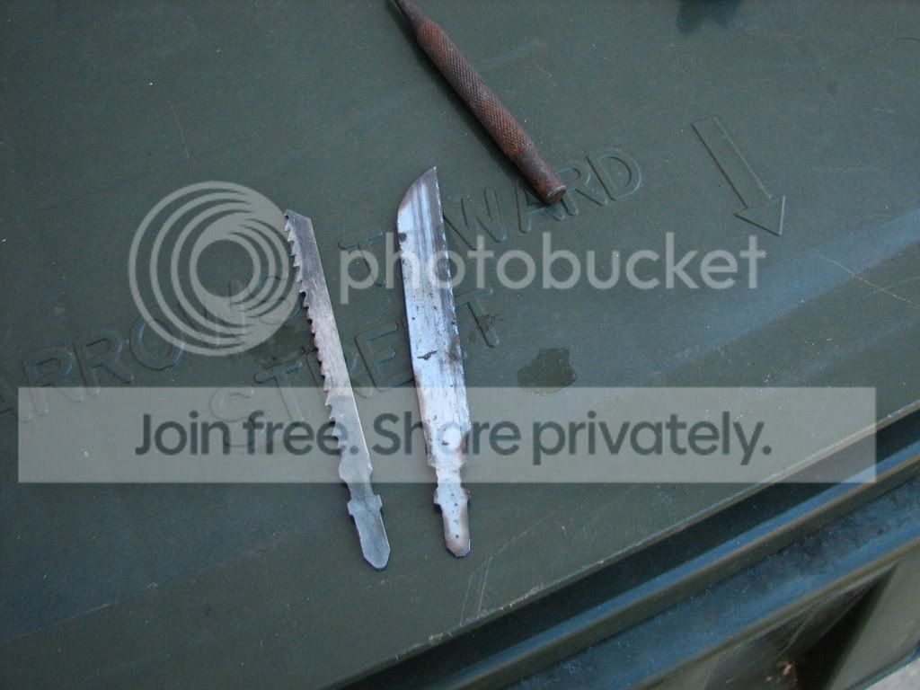

here is me not likeing using a hacksaw blade to finish the cuts
here is me using a hacksaw blade in my jigsaw...improvisation!

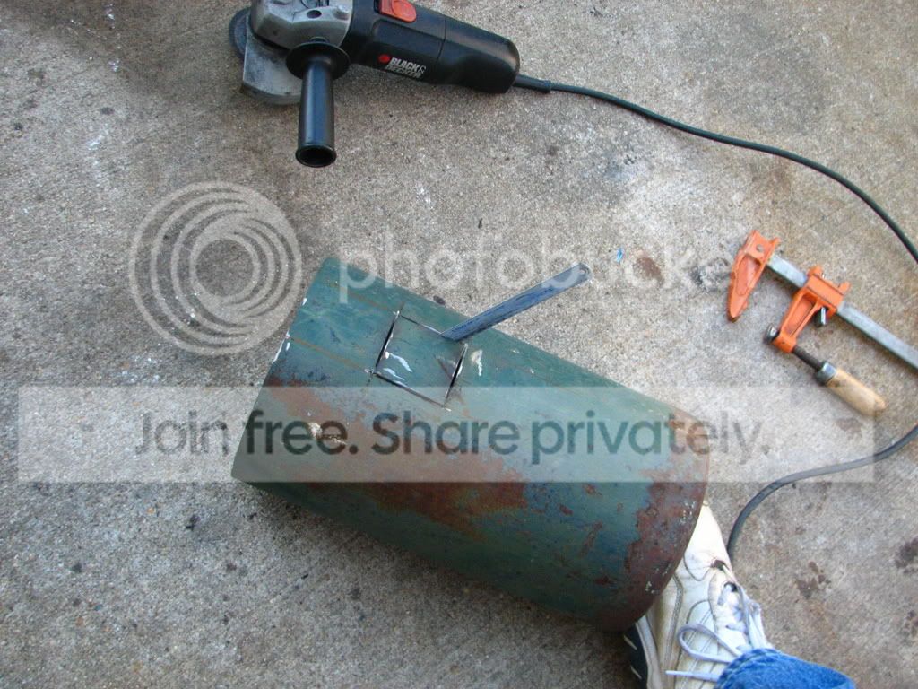

One side down... one to go!

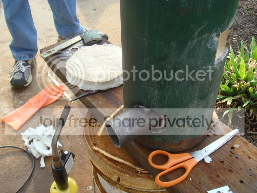

The burner pipe hole... quite a feat with a 4" angle grinder

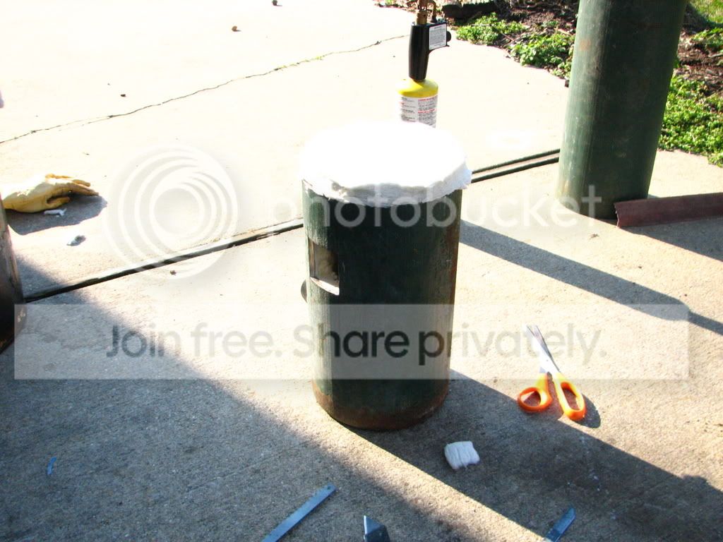

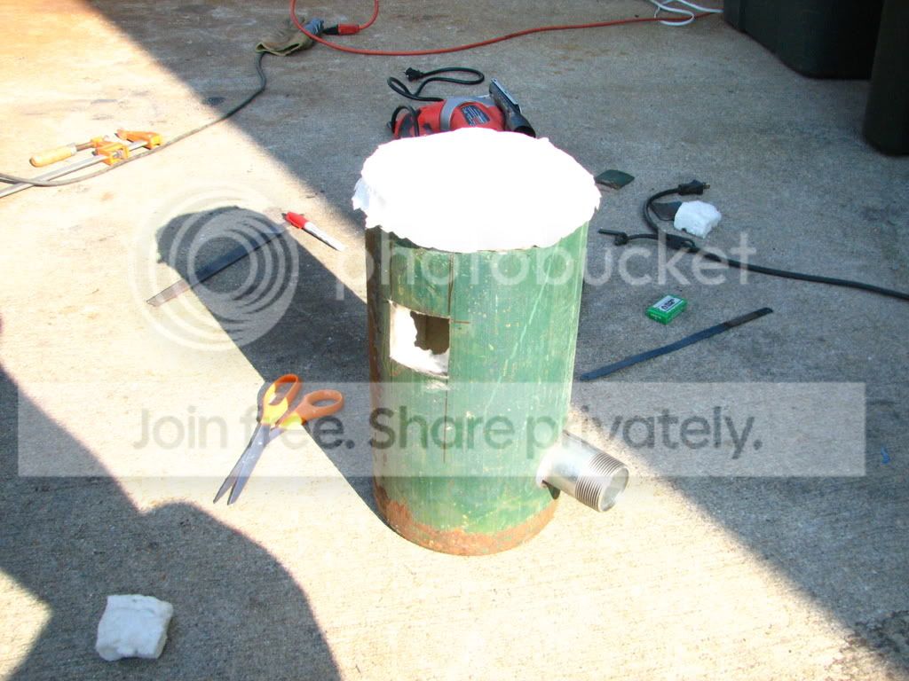

Here is the kaowool inside
another pic...
more pictures later...
fo REAL!
a sawzall would be nice.... christmas maybe
i can hardly wait to fire it up... still gotta finish the burner

is that a vert forge? How much did this cost over all?
i guess it is a vert forge.
as to cost..
old oxygen tank: free (got it at the dump)
Cutting wheel: $2
Kaowool: $10 (i got 25' for $50)
burner tube: $5
ITC 100 coating $20
thats what $37? not bad
the burner i jsut got from Darren Ellis.. so i have to finsih putting that together before i can fire it up. i SERIOUSLY need a drill press!
i also need to put the ITC on it. but as soon as i do i will post pics
thanks!
~Chris

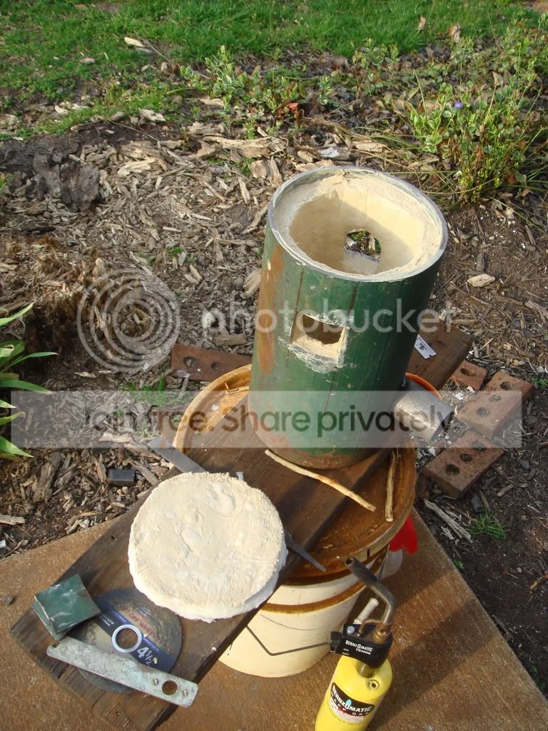

i was thinking...
i clay quench my knives... and this new forge isnt gonna heat treat anything.
can i put a burner at one end of the other portion of the tank i have so the flame comes down the lenght of the tube for heat treating blades?
it was just a thought... but it would allow for a more even heat i would think.
something like this:
with the blade getting a more even heat laterally what think ye?
thanks
~Chris
Hi Chris, If you have materials to clay quench, you might consider putting a layer of something like satanite under your itc-100. It'll probably be more durable for you. Your heat treat forge looks like a regular horizontal forge. I'd go with one of the side mounted swirl burner placements. I think it would be tough to evenly heat a blade before the tip got a little over cooked, and it might feel a little warmer the usual with a burner pointed right out the front.
Best of luck, Craig
Chris, your doing a good job on your forge. As far as the burner placement on your horizontal forge, I'd suggest capping off the threaded end, and bringing the burner through the wall perpendicular, like your vertical forge.
Keep on with the photos!
okay...
so it sounds like i so the swirly thing just n a linger forge. do i still put the burner at the far end? or closer to the middle or what?
thanks
i'll try to avoid the flame thrower thing =) *grins*
~Chris

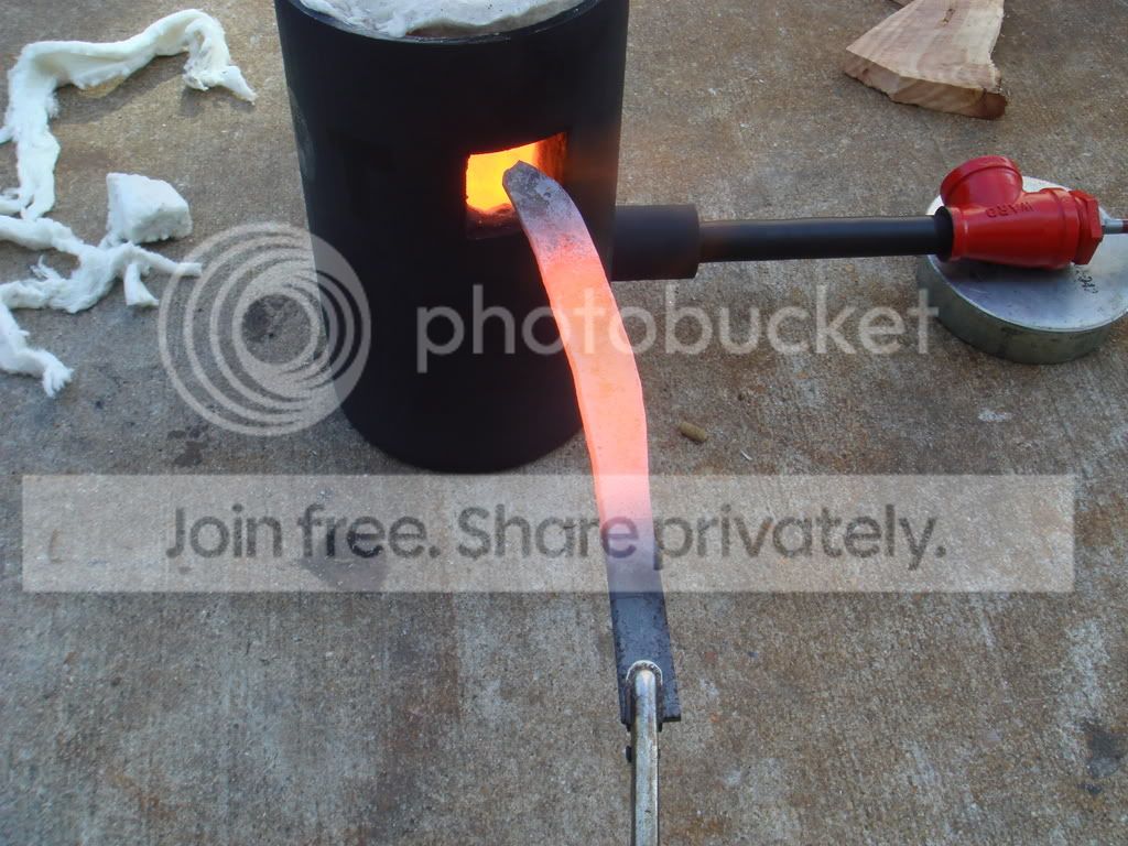

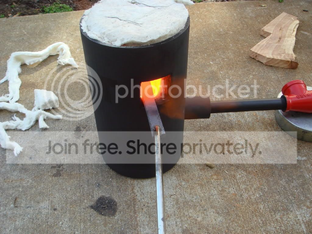

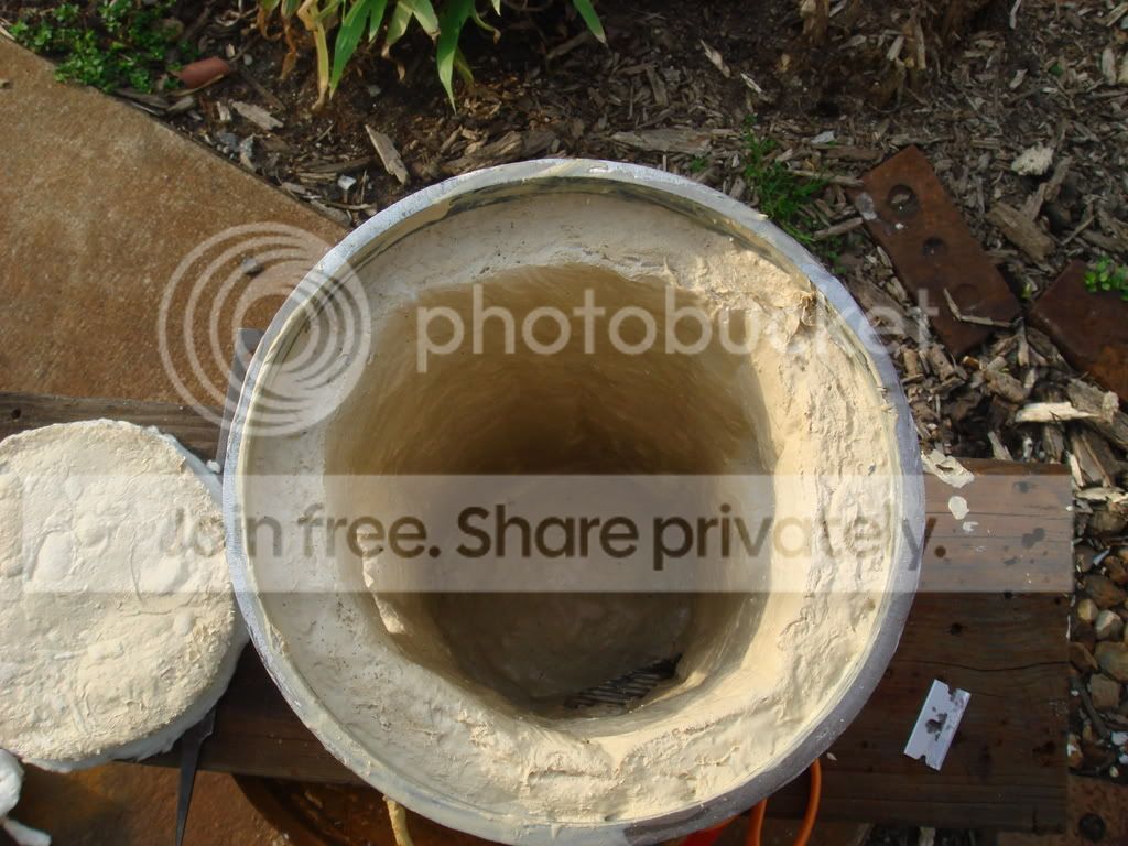

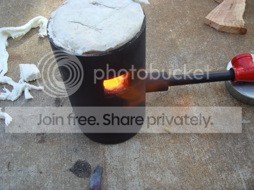

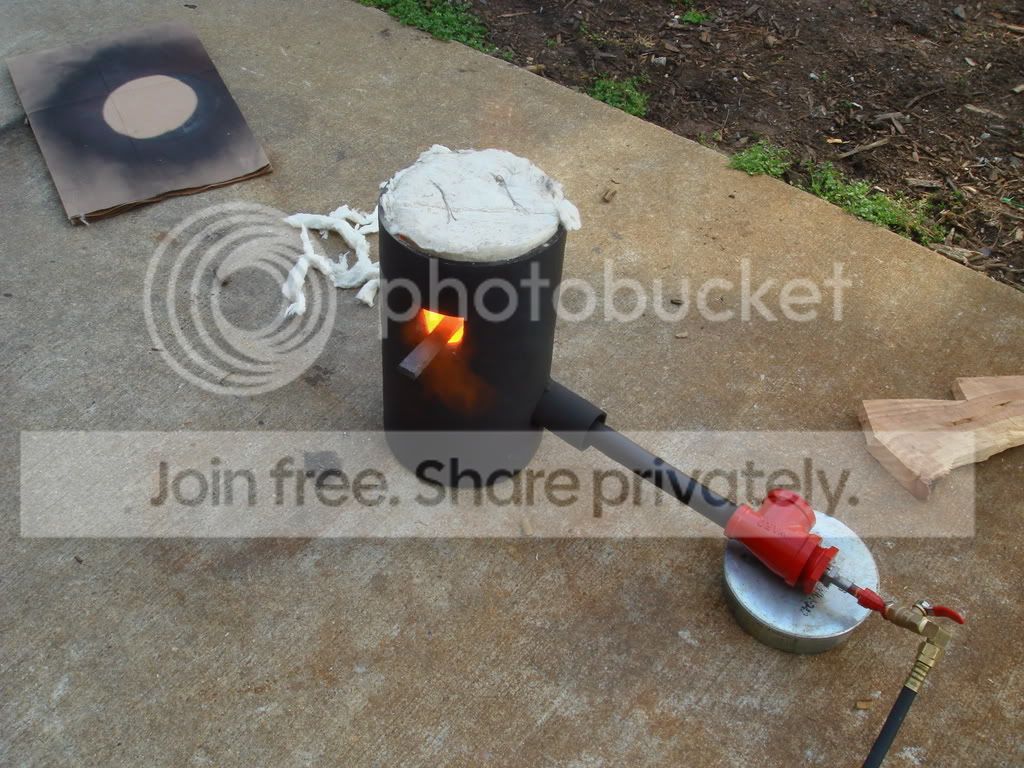

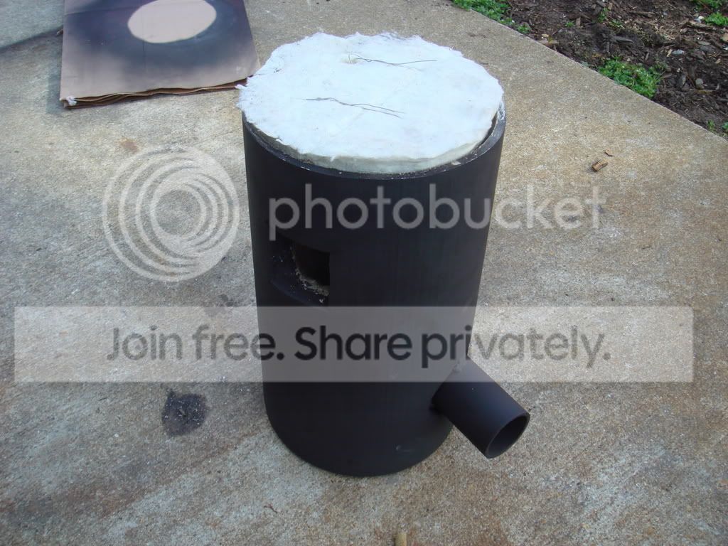

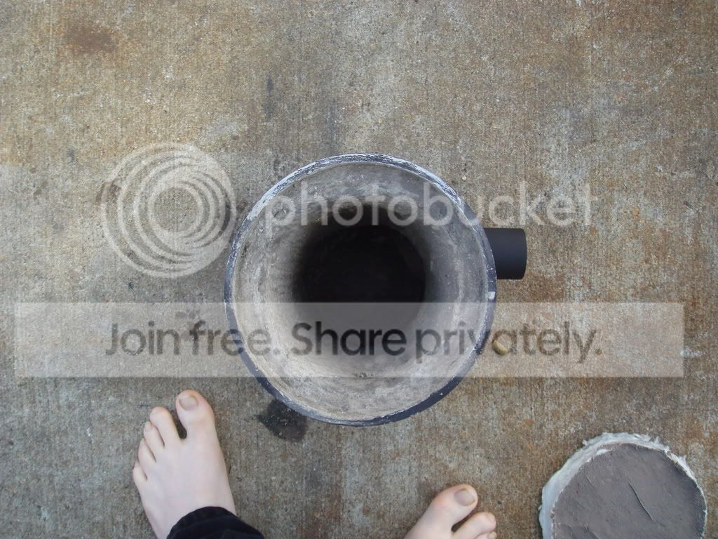

okay i finished it!
i put on a coat of refractory cement (which i later regretted doing.. but whats done is done)
then i got the 1 1/2" black steel pipe welded in
then i coated it with ITC 100
then i hooked it up with my brand new Venturi burner from Darren Ellis
in the pics it is running about about 5-10 psi i moved it around
thanks!
~Chris
