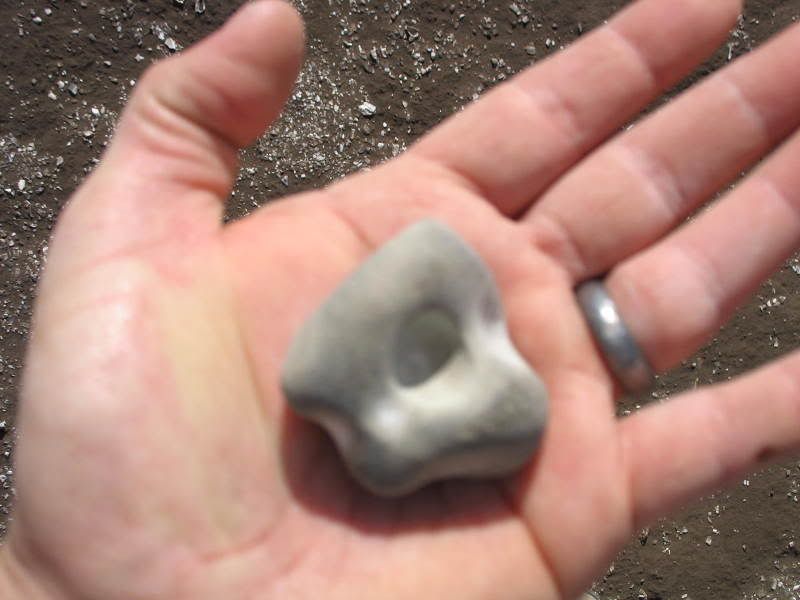

How can this be done? How can one drill a socket into a rock? What rocks would be good for this?
Many people say you can do this - but how?
THanks,
TF

Primitively you would do it with pecking the rock. Repeatedly hitting the rock with a rock that is harder than it. It takes a long time though. Its not flintknapping you are just trying to ware down the rock.

You can drill a rock using sand and your bow drill. Even easier is to go to a mountain stream and look for palm-sized rocks with a natural indentation.

A slightly pourous rock can make a great handheld. The best way as previously mentioned is to find another rock that is harder with a point on it and peck out a socket. This can take some time - 15 minutes to hour+. Plus you get to hear tap tap tap... in your sleep all night.
If you make one, make the socket a lot smaller than you think as it will provide greater versitility - you can always make your drill thinner.

i found this rock on the beach... i thought it would make a great socket for a bow drill...
I feel dumb now....I live close to the beach and never thought of looking there for a stone like that.It'd be smooth too.
Thanks so much for all the suggestions.
I am going to stop at Home Depot tonight - and I have a line on a free chunk of soap stone.
