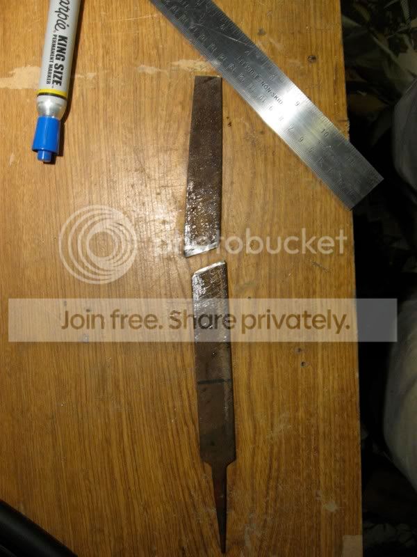

i thought this might be appreciated around here. i put this together to show any of the members here that have more time than money that it doesn't cost a fortune to have a good bushcrafting knife. this knife actually comes out cheaper than a mora! :eek:

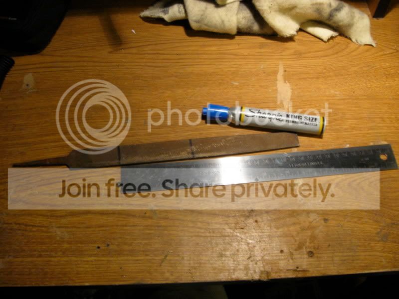

yesterday i went to the junk shop and bought a file and a chisel for $2 total, so i figure $1 of that was for the file.
yesterday i reconditioned the chisel, linky

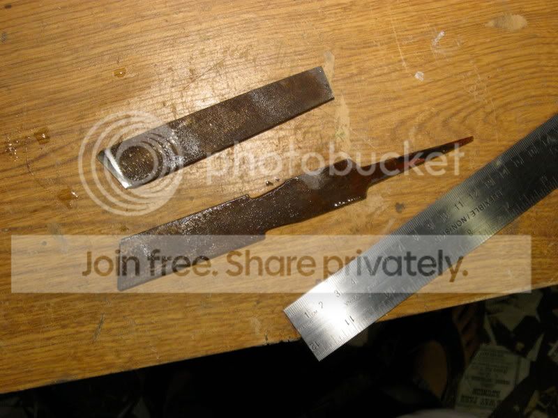

today i started making the file into a knife. i smashed the handle and then marked out where i want the blade and handle to be.

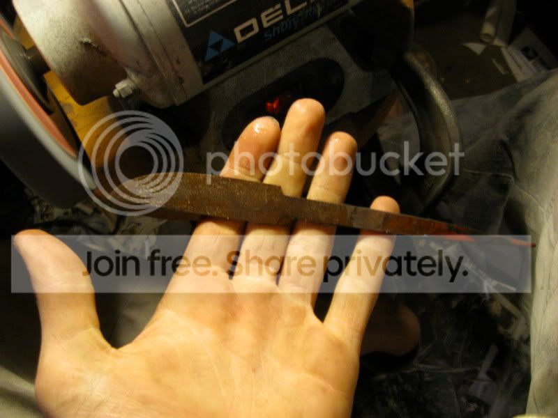

i used the corner of the stone on my bench grinder to cut it to length;
next i started grinding down the tang on the bench grinder;

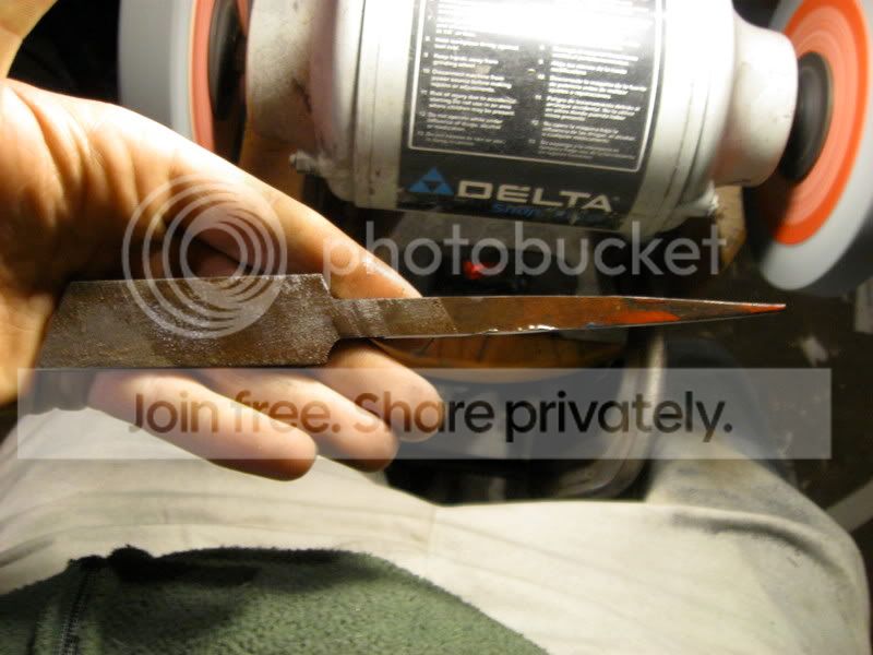

quite some grinding later i'm almost where i want the tang to be;

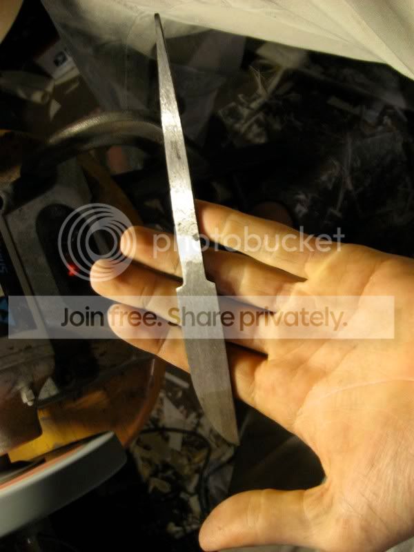

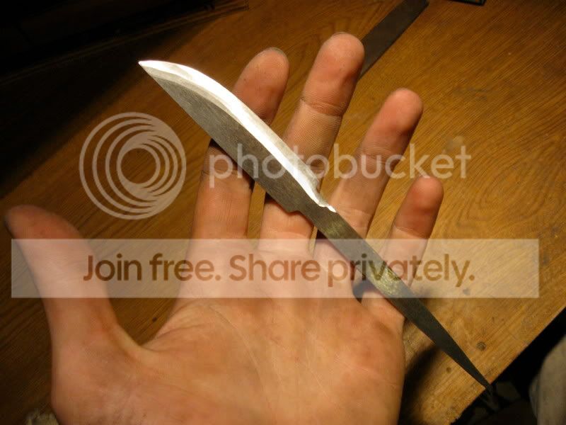

i ground the blade part narrower, since it was too wide for what i wanted. then i started shaping the blade shape;
next step was grinding the teeth off of the file;

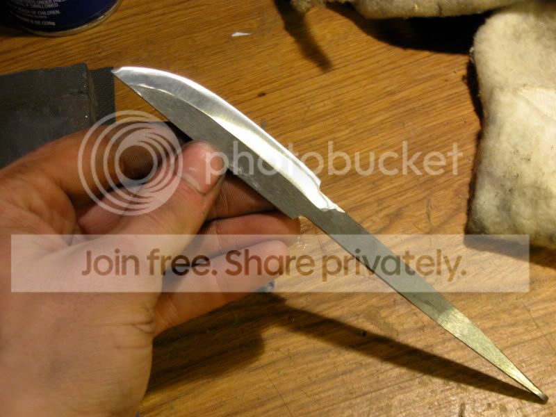

next came the tricky part. i started slowly and carefully, with many light passes at a time, grinding in the bevels (still on the bench grinder). only a couple of passes and then some swishing in the water bucket to keep it very cool. at the end of this stage, i came out at almost exactly 1 hour of time spent so far;

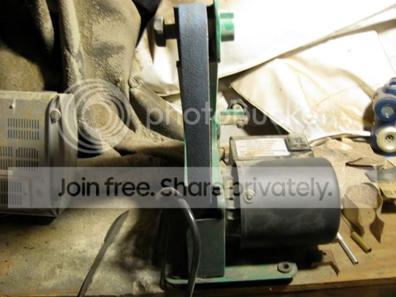

after that, i tried flattening out the bevels on a few different stones and then on coarse sandpaper. all too slow, so i gave up and took it to an 80 grit belt on the 1x30 sander;
nice and even and pretty flat;

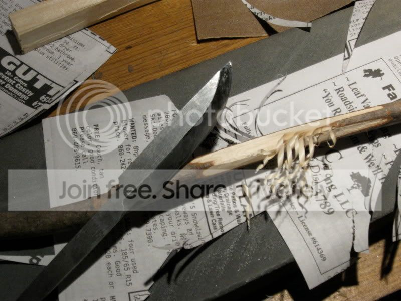

next, back to the stone. i ground for quite a while on the stone, and still didn't get the bevels flat. that's alright, since i did a pretty high scandi, and making it dead flat could make the edge weak. i might work it out flatter over time, but i'm happy for now. after i polished it out some on my medium stone i stropped it to remove the burr and ended up with one sharp file :eek::D
