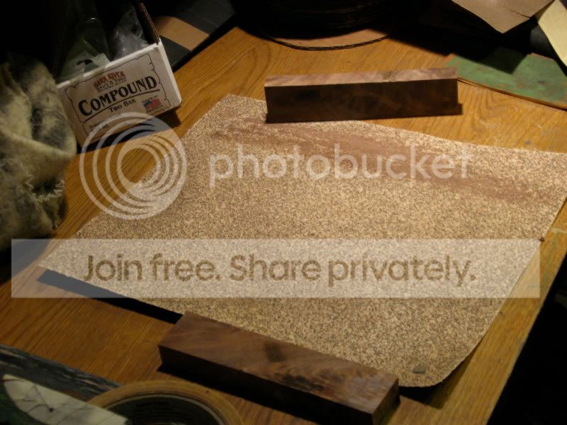

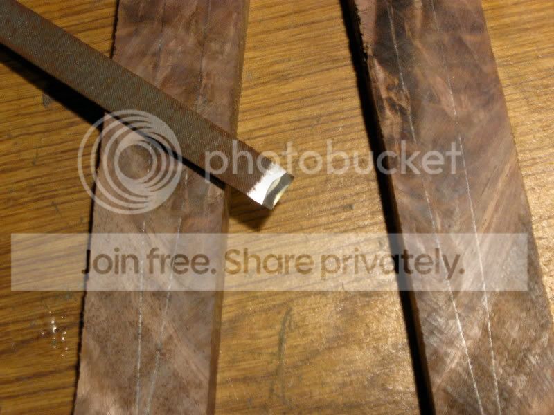

so anyways, now that i have my blocks of wood, i start by sanding the mating surfaces flat with a piece of 40 grit sandpaper:

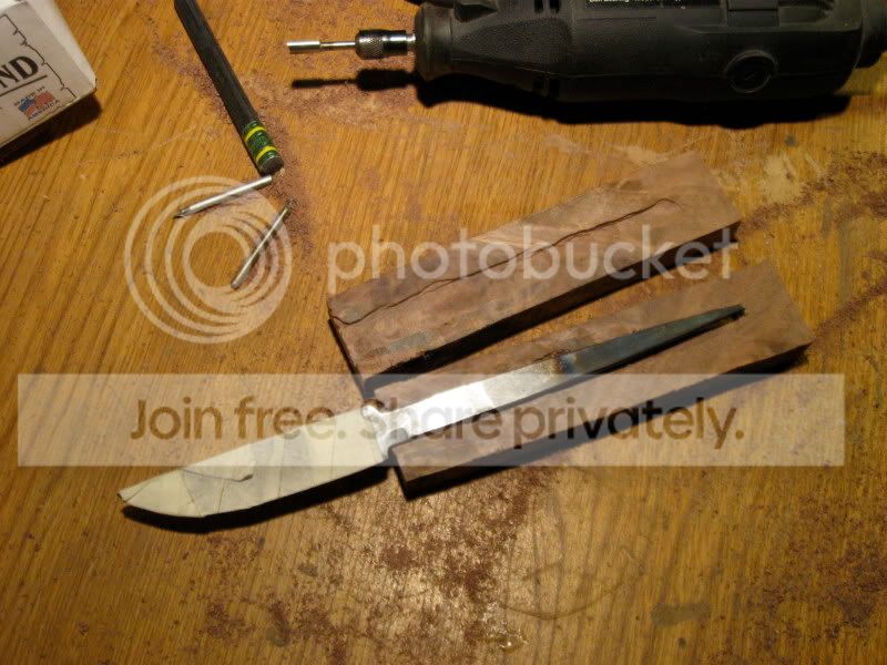

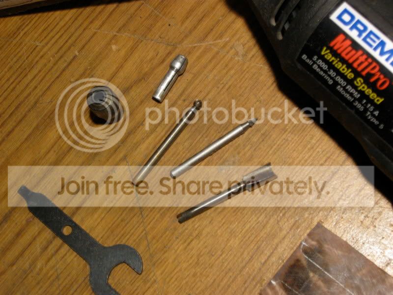

then after i traced the tang onto the scales i used a Dremel (any rotary tool will work fine) with various cutting bits to carve out the channels for the tang.
if you don't have a rotary tool, you can have at it with small chisels like i had to before i found the Dremel hiding in a corner...harder but if you are careful the results will be just as good, maybe even better since it takes longer to mess up;)

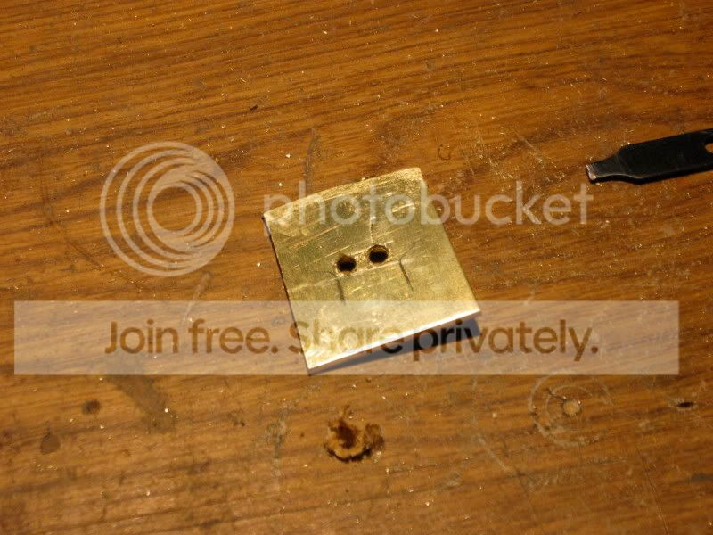

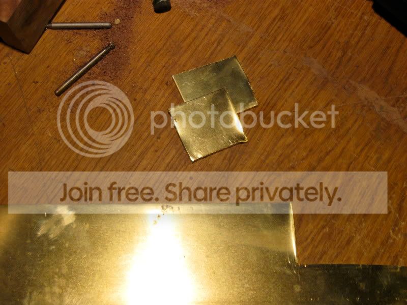

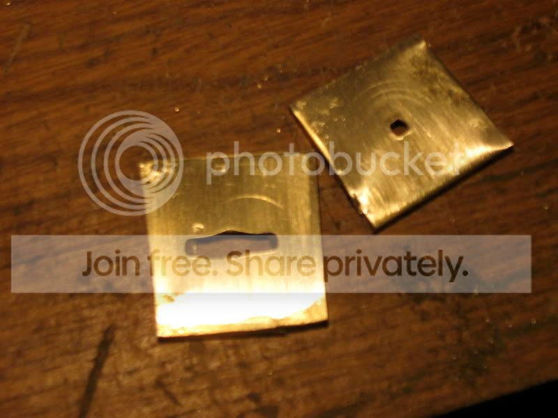

after i have the channels fitting well, i cut some pieces from a brass sheet. i don't remember the exact cost on the sheet, i think it was around $7 at the local Ace. if you don't have the $ or a nearby source, you can scrounge for old brass hinges or other sources of brass. you might even be able to forge out some old belt buckles or something...

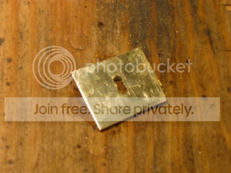

i again used the dremel to drill the holes in the faceplace and notch it out to fit the blade. if you don't have the dremel, you can use a drill and some needle files, but it will take some time.
you also want to make a piece that will fit over the end of the tang and hold the whole assembly nice and tight. i just drilled a hole ever so slightly larger than the end of the tang. you want to sand the visible faces of the brass to their final grit before putting everything together, it will make it much easier later on.

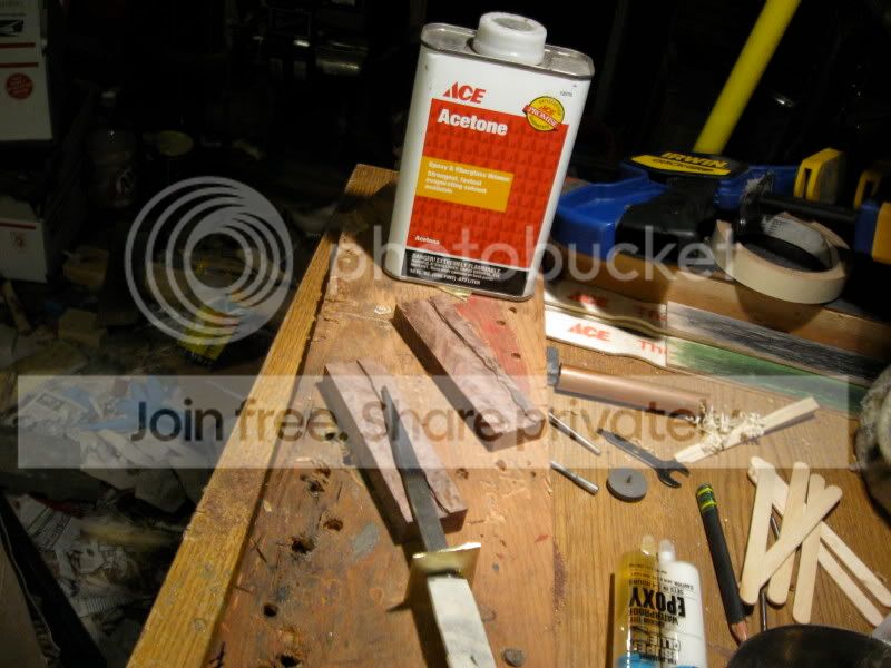

do a dry fit to make sure everything fits well. if anything doesn't fit quite right, take it apart and adjust until it works. trust me, you don't want to ignore little problems. they have a way of becoming big problems later on...:rolleyes:
once everything is looking ship-shape, take it apart and degrease the parts with acetone or the like

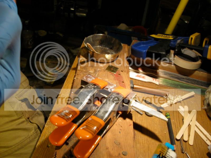

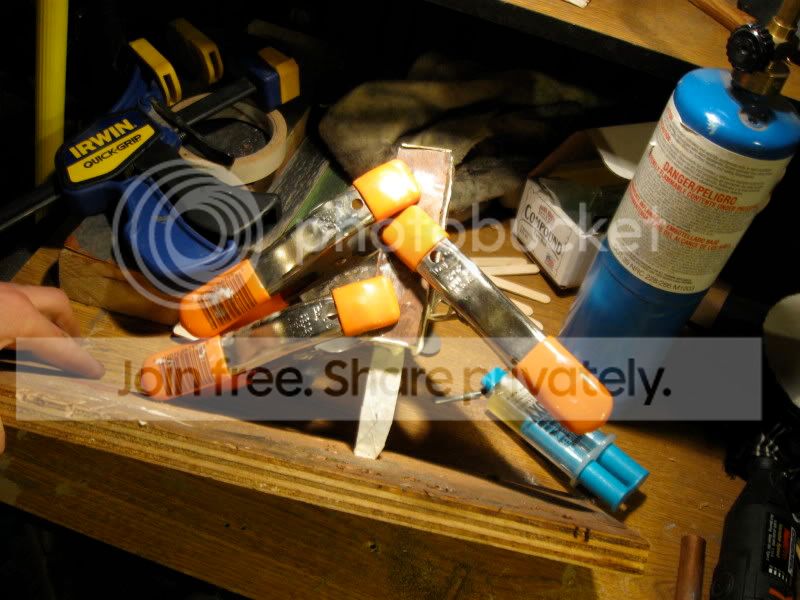

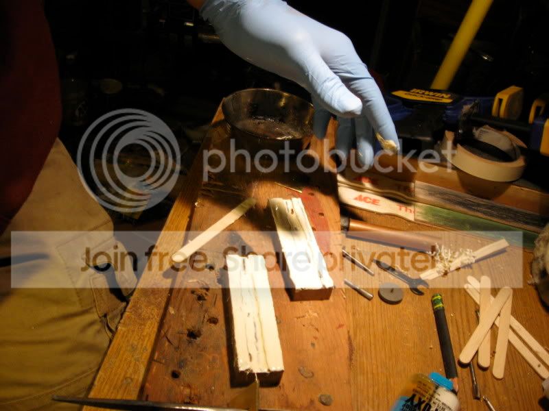

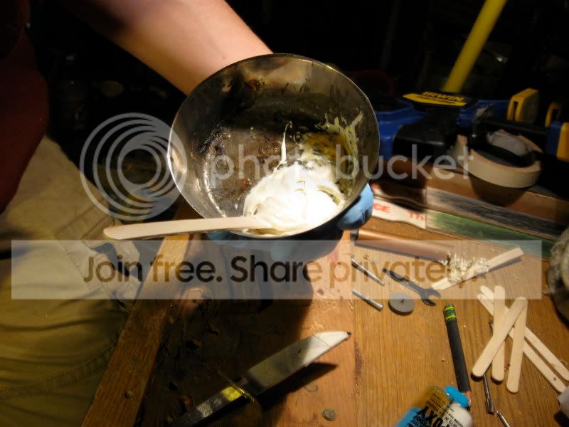

mix up a good amount of slow set epoxy. here i'm using 3 hour set, to give me plenty of time to work.
start spreading the goop! this stuff is messy, and tough to clean up, so i use a board on my work desk, and wear gloves. if you are doing this in the kitchen or something, make sure you lay down plenty of wax paper or newspaper...

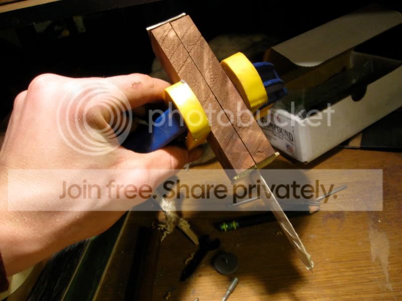

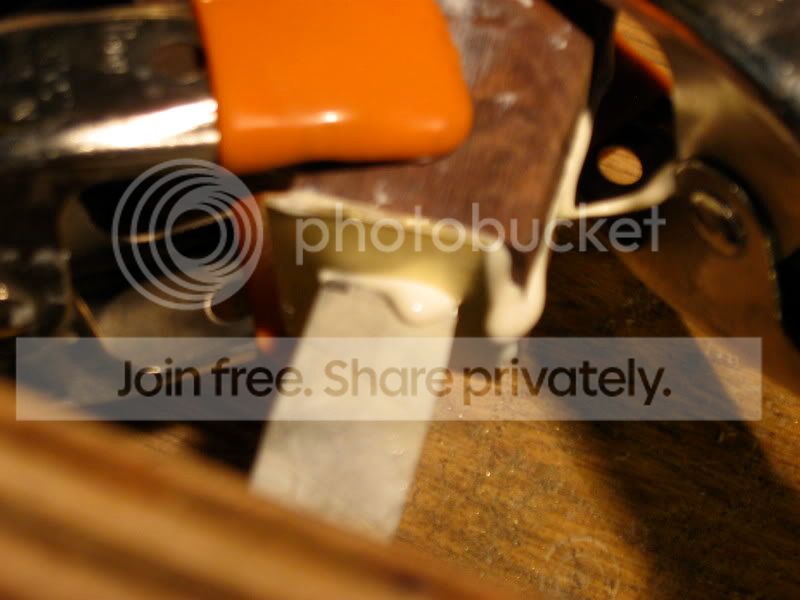

stick it all together, making sure you don't forget any parts. i use spring clamps to hold it all together, because they apply a good amount of pressure without squeezing out all of the epoxy. any reasonable clamp will work fine. i've even used a bunch of rubber bands before, bound up tight.

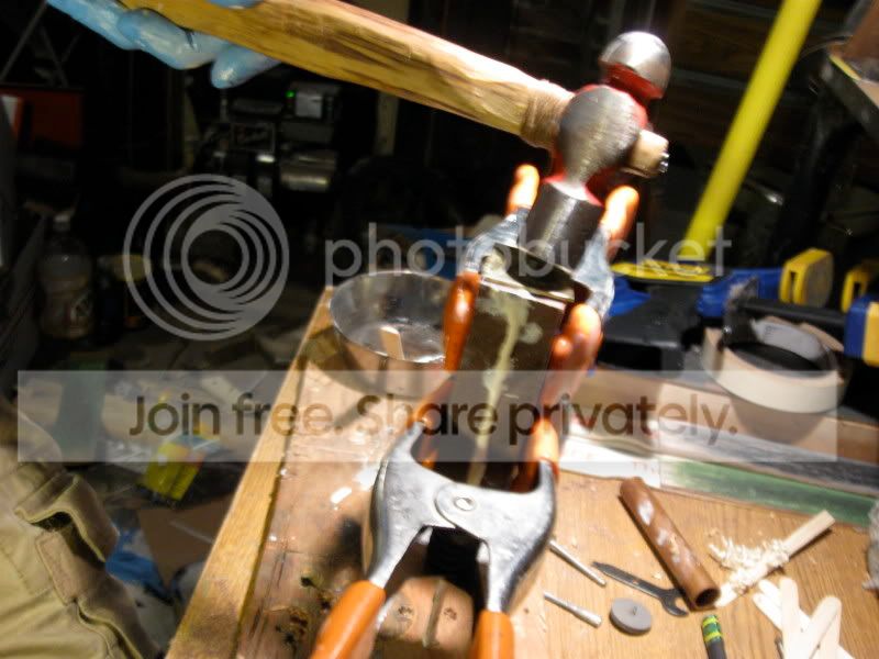

once the parts are all fitted together, i stick the tip of the knife in a scrap board and place the last piece of brass over the tang. hammer away! to form a rivetted tang end to hold everything tight together. if you want, you could cut the tang shorter and forgoe this part, having a fully encapsulated tang.
try to wipe out the epoxy here, it will be tough to get out once it is dried. you can use a stick with a bit of acetone soaked cloth over it.
here it is right now
one of the hardest parts of the process for me, having to wait 24 hours for it to be all cured up and ready for me to proceed. next up, is shaping and finishing of the handle, and then hopefully a sheath!
