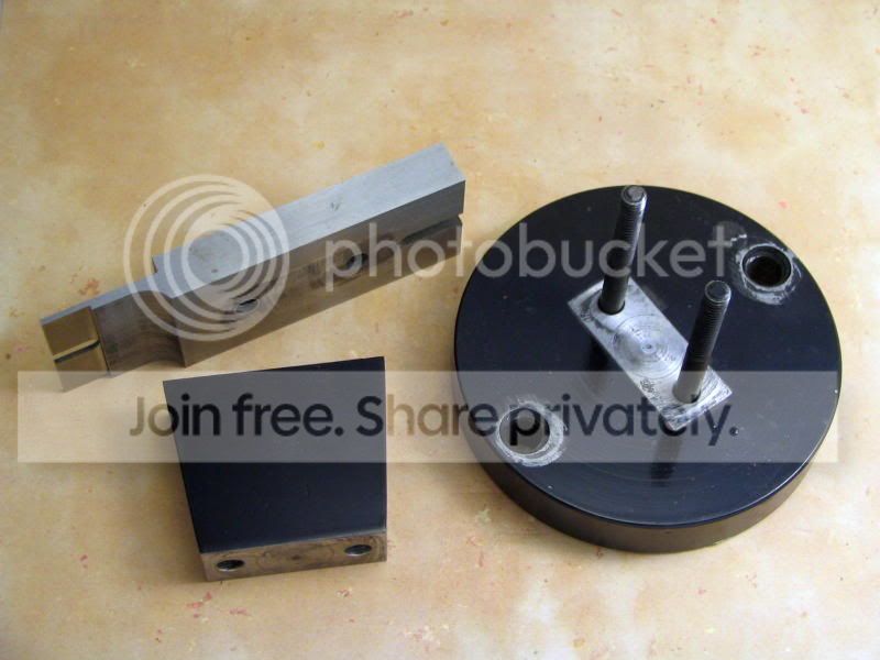

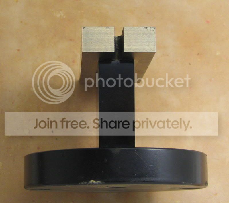

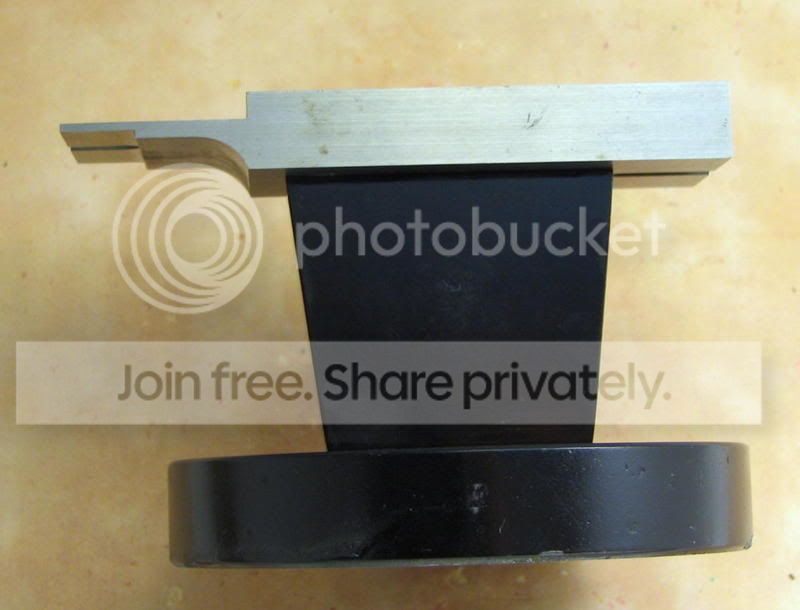

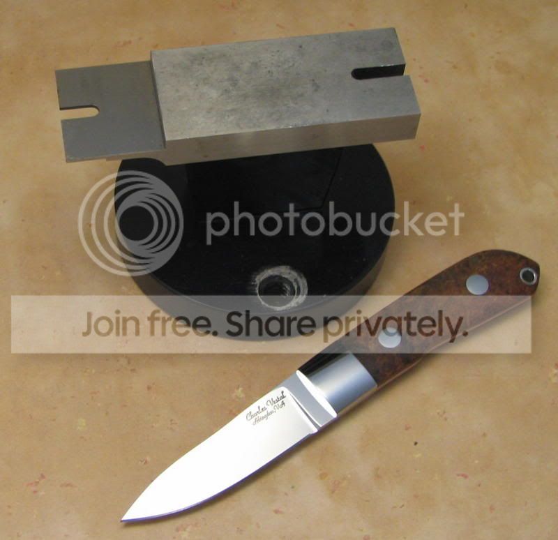

Here we go
Sorry for putting the knife in this picture;)
side view
end view
All the parts
I hope this helps
Take Care
Charles

Well I posted the pics through photobucket did it work????
I uploaded the pics too BladeForums but they have left the building.
Charles
I see 'em all, now, Charles. Nicely fabricated anvil!
Nice semi-skinner, BTW. ;)
Dave, this little anvil is an old design used by cutlers making and repairing pocket knives.
I use it mostly for peening pins
Charles
