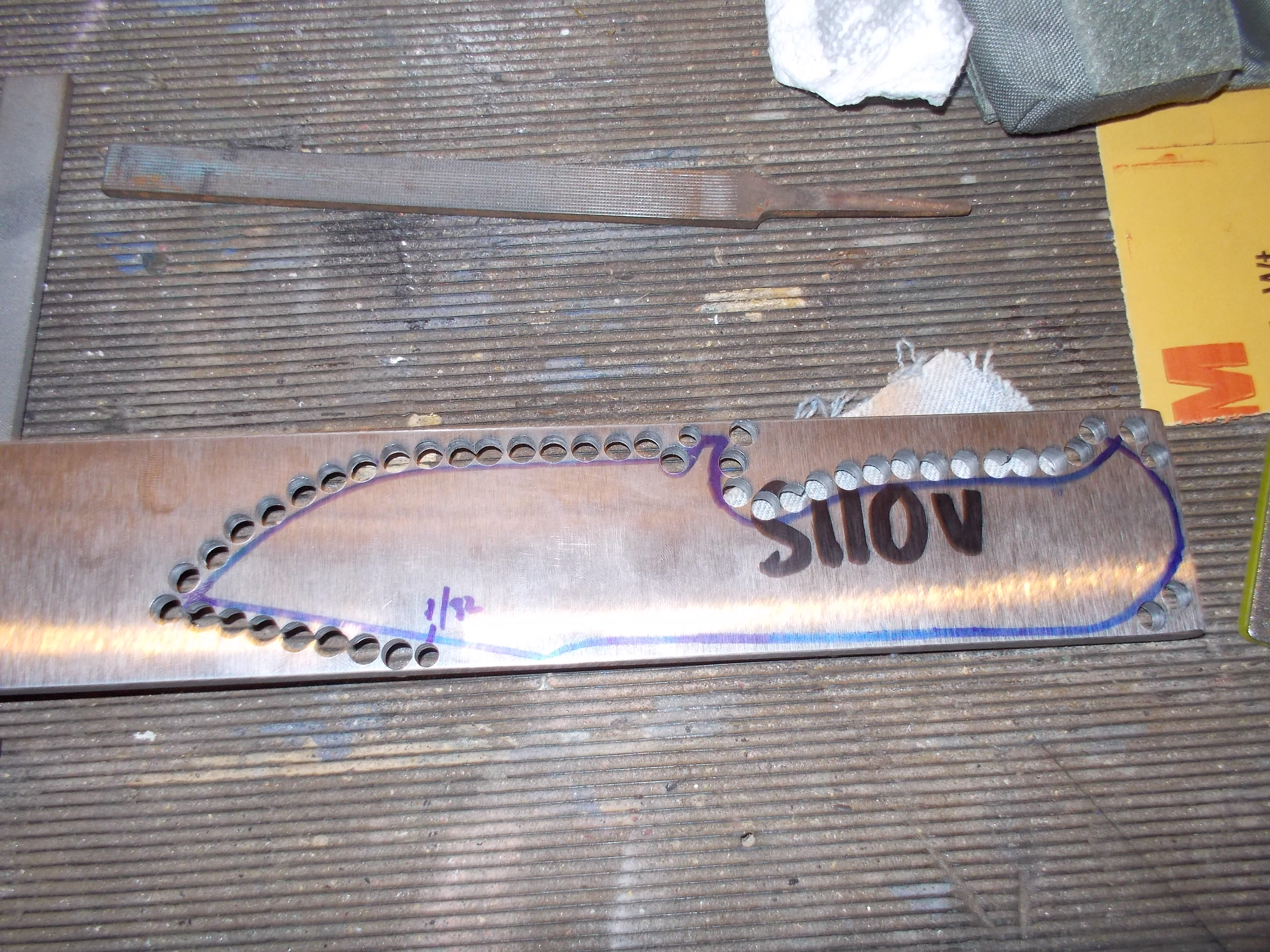

Here is a quick series of pics from a build I did while stationed in Rota Spain. At the time my equipment was very limited, but not limiting. I found that my HF portaband would not cut S110V or S90V effectively so I went to the tried and true.."Connect the dots" method. I use a small chainsaw file to cut out the pattern. Refined on a disc sander, then on my cheap 2x42 craftsman special.
Mark the edge center line and grind initial bevel. I adjust the plunge with a 1/4 in chainsaw file and file guide. Then grind in my FFG on the craftsman. refine as needed with sand paper and draw filing. (not as much anymore.)
I send my blades to Peters' for heat treat then finish up hand sanding and fitting the handle slabs. This material was .220 thick, if I had been more confident in my abilities I definitely would have tapered the tang. :)
Figured out how to attach pics!
the smudges on the blade are tape residue from making the sheath. This one has 1/4 inch titanium pins, Titanium thong hole. Grey G10 with blue g10 liners.
thanks guys! surprisingly...the steel works well with files despite being a bear to grind. It si hard on drill bits...I highly recommend the norseman bits from USAKnifeaker..or the Cobalt steel ones from McMaster. They seem to last a bit longer.

I wonder if changing your current bandsaw blade type could allow for better cutting that steel.
I'm sure that if I were to invest the money in a carbide blade it would work, or a more powerful (read larger) band-saw. This process works pretty well and since I am a hobby maker, will suffice for the time being.

Navman, an angle grinder is a great investment! You can pick up an 7 amp, 4.5" grinder for very cheap! I use mine for ALL heavy cutting.
yep a cut off wheel works great. Don't twist it in the cut though or it will shatter. Wear full face protection. The discs can explode fyi.

Thanks guys. I used an angle grinder early on, but was not at all happy with the results.
