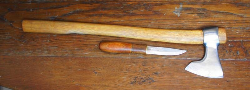

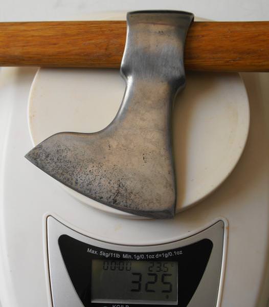

You don't need light material to make a light axe, you can make a steel axe as light as you want.
Here is one I made, a ground down slip fit head that is under 8oz & a total weight with handle of 11.5oz(325g). Lighter than a can of Coke.
It's a surprisingly good chopper too thanks to a very long handle, what the head lacks in weight it makes up for in speed!

But at 11.5oz it's 50% heavier than what I am trying to achieve.
