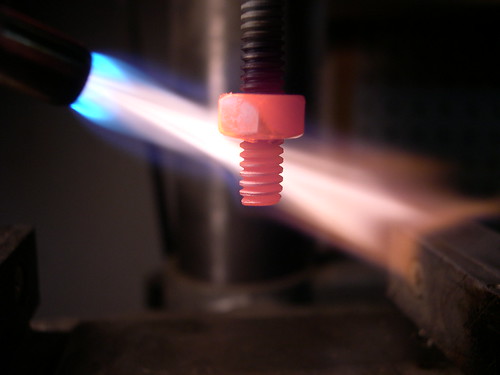

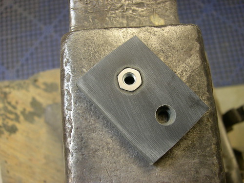

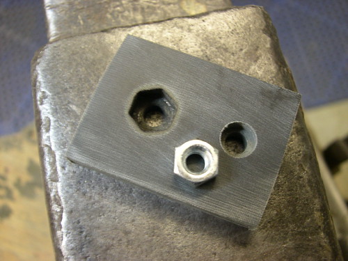

Works awesome.

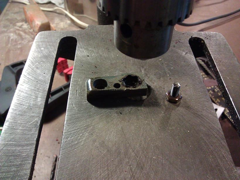

This is a little piece of test micarta in which I'd already drilled a couple ofholes for 10-32 bolts, counter-sunk at 3/8" with a spade bit. I tried pressing a nut into them as worked well with wood and got nowhere - barely even a mark. Both counter-sunk holes in this piece were identical when I started.
The hot-nut method (oy) works great. I'd recommend using a 2" threaded shank as this will let you get the nut far enough away from the drill head so its easy to heat (used a basic propane plumbing torch), and also allow some of the bolt to protrude through the nut as a pilot into the hole to ensure perfect alignment.
The slag from the melting sanded off in moments. The slag inside scraped out with a couple casual strokes from a cut bicycle spoke that happened to be on the bench. Obviously do this before you start your shaping and finishing work if you can.
-Daizee

Well....yup. I tried it this way and got the exact same results. Very cool. I guess I didn't play with it enough! Good job, Daizee! You might have just opened up another great process!

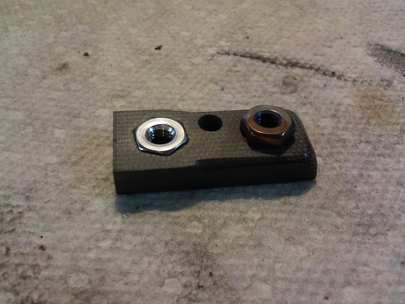

Here's my attempt at doing it with the hot nut as Daizee suggested. I used a bolt and did not get the results first round- this works far better. I was quite amazed how well it turned out. This was done with a 1/4" piece of micarta, 1/4" hole followed by
a 3/8" counter sink as Daizee said. Heat the nut to a cherry red and plunge. It really did seat nicely and cleaned up very well. Sure beats spending $$
for a CNC capable mill!!

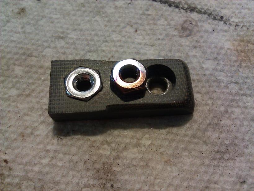

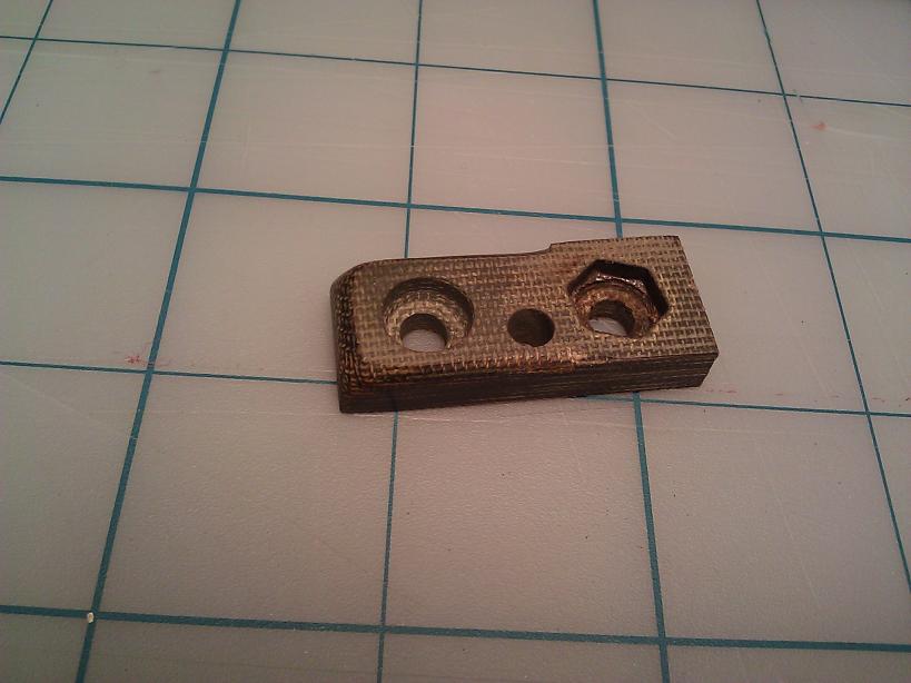

Huh, interesting - I would have bet money that you'd just wind up with either a horrible mess or just a burn mark. Now try it with G10/G11. :D
