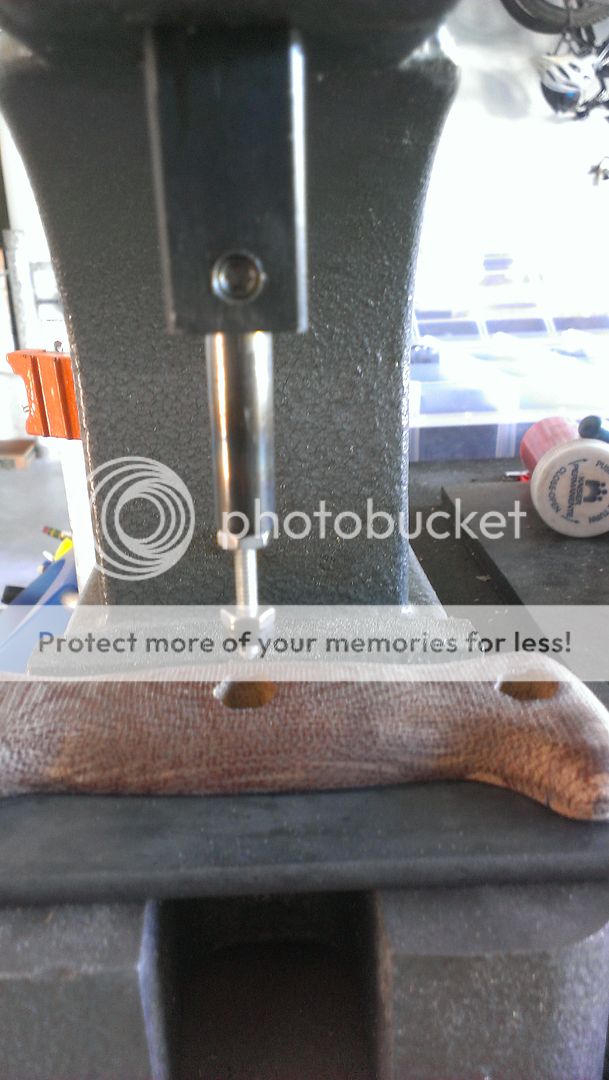

so after doing several hex heads on handles i started to notice that my chuck on my drill press was getting hot and turning black, I didn't feel like breaking it so I decided to search the internet and local hardware stores, I found some MORTISING CHISEL AND BIT SET but didn't seem like it would work, I came home empty handed:grey: I felt defeated... then I was using my 1/2 ton arbor press and BAM:eek: it hit me..... after several attempts I found a solution. works the same even better and less expensive to replace. This is what I came up with.
I got a different design I am working on same but different...
That should be interesting because the laminate in G10 is glass, not cloth. let us know how it works.
Huh, interesting - I would have bet money that you'd just wind up with either a horrible mess or just a burn mark. Now try it with G10/G11. :D
