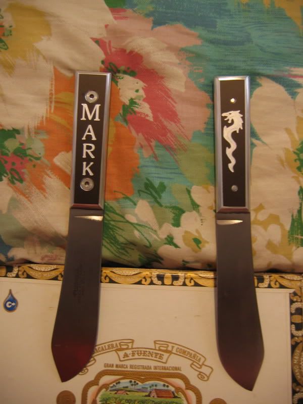

Some RGR's I did with real nice ironwood
Some may find this interesting. These blades from China called caper or mini ,I could not figure why the front pin hole was so far back . I hafted many like this with the cover going up towards the front
Then one day I saw this on Ebay ,and realized this was where they got the idea for this blade ,and pin hole placement

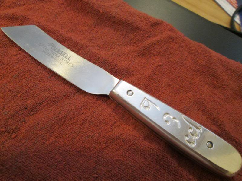

I've done a ton of kitchen knife rehandles from finished knives, but since "blanks" was mentioned specifically, here are some of the ones I have done from blade blanks. Mostly kitchen knifes again, but hopefully these count.
Most of these are Zhen knife blade blanks that are easy to find online. All as gifts to help upgrade friends and family's kitchen cutlery. They have pretty good steel and decent grinds for blanks that don't require extra labor to pull handles off. Prices were reasonable as well for how well they function. The standard Zhen knives came from Woodcraft's website last I purchased. The hammered damascus was a damaged blem with a bent tip from the Zhen main website that was really well priced. I cut about 1.5" off the tip to make it more gyuto style so the bent 1/4" didn't bother me at all. The last pairing knife in rosewood was a Jantz knife in AUS8 and is ground nice and thin. Probably my favorite knife from that particular line.
The Russel Green River carving knife looks very nice. Next time I get the idea to do a blank I will pick up one of those.

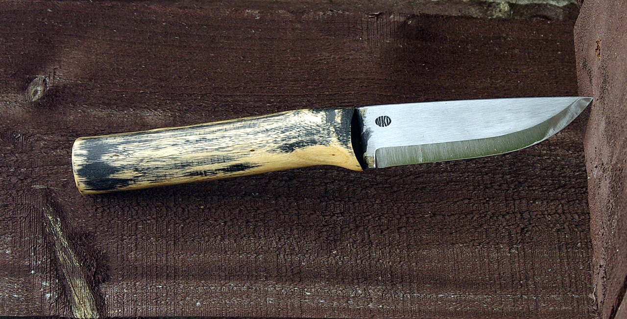

NKD 95mm Blade blank in 80crV2 Carbon
Handle is a Gumtree branch .
Would have been all white , except I hit it with some black marker and sanded down .
Then varnished it .
Spine was ground to make the blade more Bushcrafty .. Scrape ferro and wood to make fire !
My 5th DIY blade blank ..
Just considering right now what my 6th one will be ?
