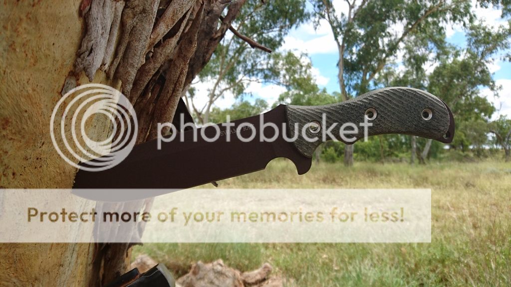

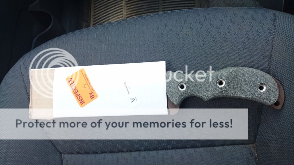

I received my new Ratweiler yesterday morning, gave it a bit of a work out while we were having a bbq lunch & some tea. It's phenomenal! The countors of the handle are perfect for me. Mine's 1/4 thick - this knife is indestructable!
I won't blab too much more, but will let the pictures speak for themselves. Please forgive me, this is my first go at working and photographing at the same time - I didn't really put much thought into setting up the pictures, I just took them.
0.0002 seconds after I picked it up from Australia Post:
Just getting the feel for it, nothing too drastic yet.

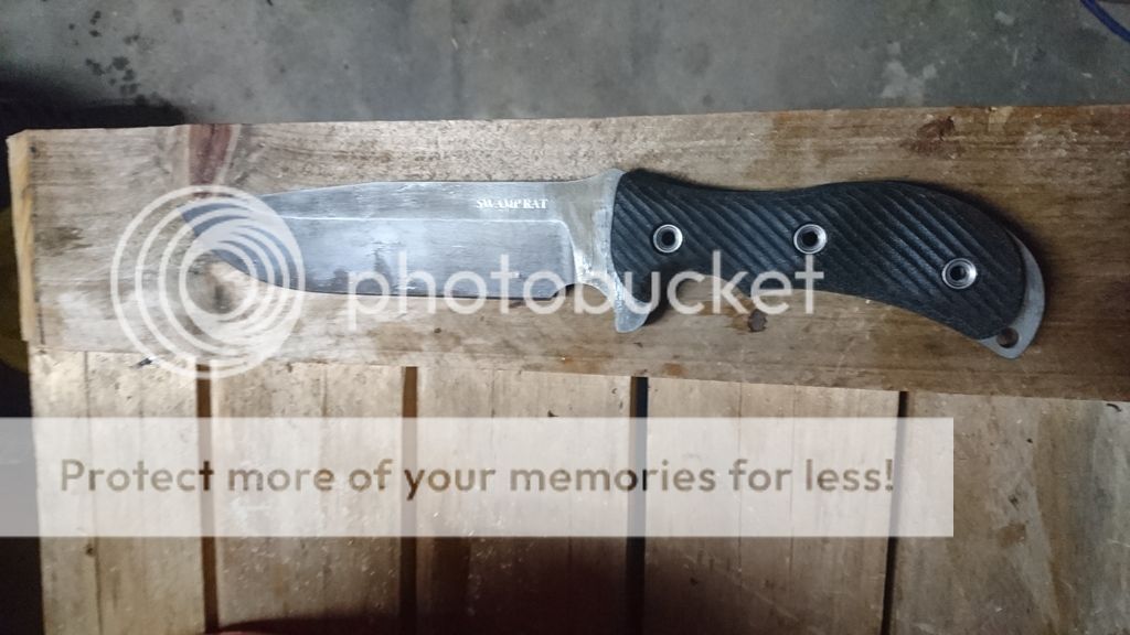

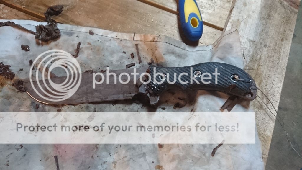

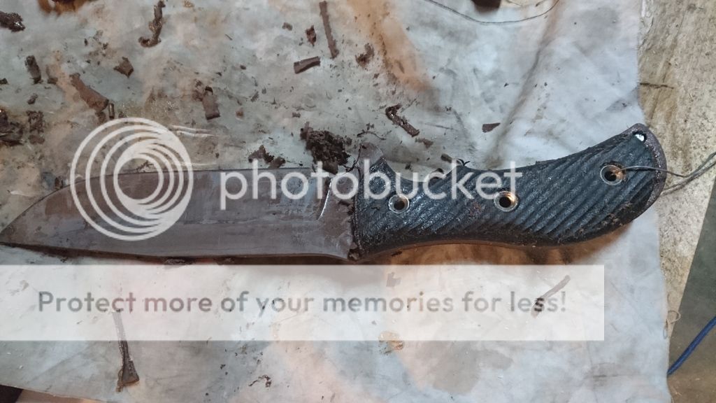

First go at stripping with aerosol paint stripper. Will not try again, it's hopeless!

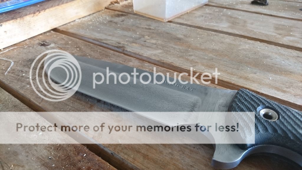

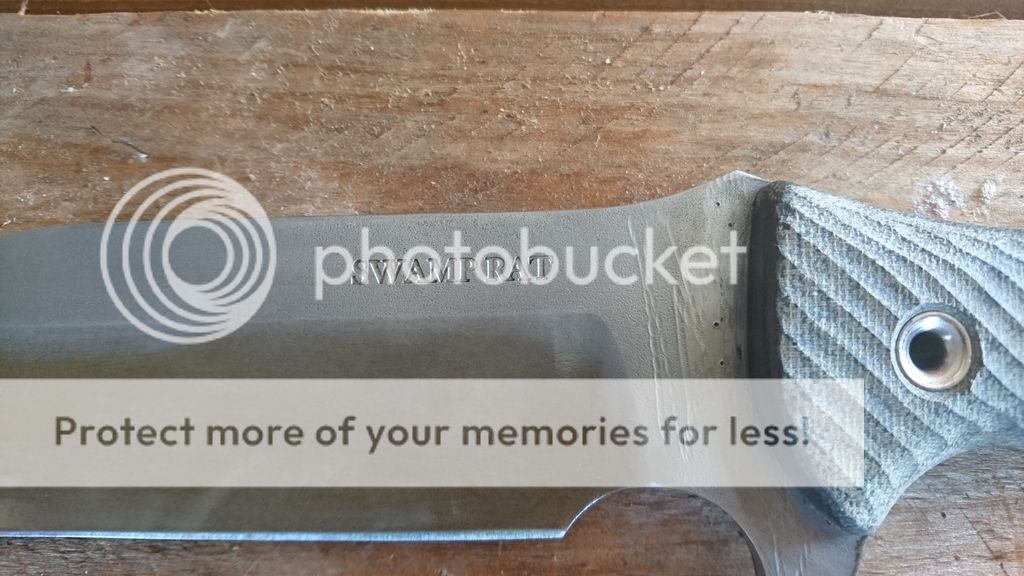

I etched the logo using cotton wool ear cleaners (I think you folks call them q-tips??). Didn't take any photos of this part unfortuately. Used a battery charger, salt water etc. Very simple to do!
No more paint!
Light rust forming already.

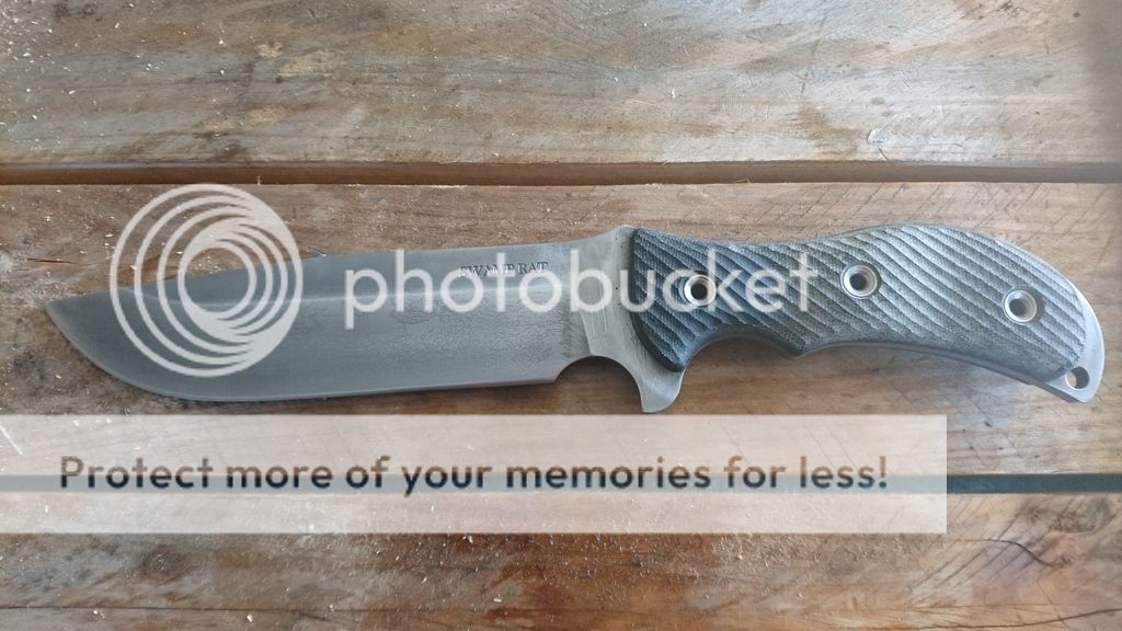

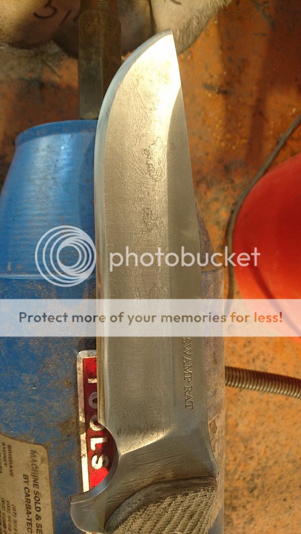

Tidied up the decarb with a wire wheel on a Dremel. It worked really well!
A couple of character marks:

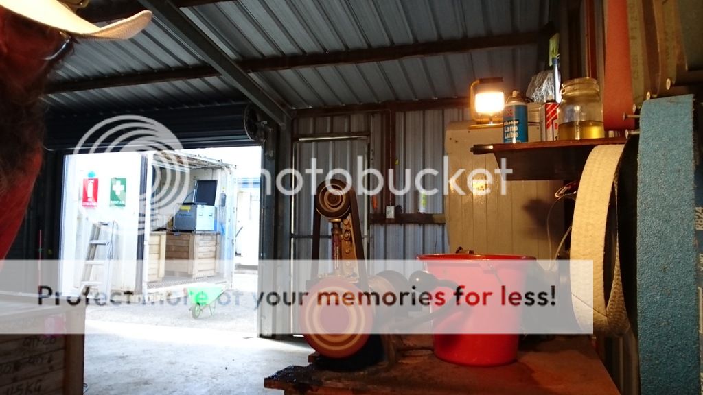

My set up for sharpening - slow speed angle grinder (1400 rpm) and the absolutely essential water. I admit I don't get all flustered about the science of sharpening - what I do works for me and my knives stay sharp for a very long time. I work by eye and dunk the knife in cool water after each & every pass.

I like your sharpening setup. I'll bet it's handy to have the belt, flat disc, and buffer all on one machine. Did you buy it that way, or did you do some mods to it yourself?
Pretty much put it together myself, though all the parts come ready to go. I just had to fiddle a bit with bushes etc as the shafts on the bench grinder aren't a standard size.
The belt is run on what is sold here in Australia as a 'multi-tool', they come in heaps of different sizes and are very well made.
Mulit Tool Australia.
Then it's just a matter of changing the buffing discs to suit through a quick change spindle. I use a stitched cloth and also loose leaf calico.
What a great transformation. Which wire wheel did you use with the Dremel? I'm guessing the lower RPMs did not get the blade too hot? I have a BG MOFO coming to me eventually, and I'd like to strip it. With the CBT, I think that the wire wheel will make my life infinitely easier--I just do not want to heat the blade to a degree that messes up the heat treatment. Also, does SR-101 have marginally better (or equal) corrosion resistance than 1095 or O1? I have plenty of experience with those steels, and I think that if I can manage/ maintain those knives stripped, SR-101 should be fine.
Thanks again for posting the pics/ process.
Anthony
Anthony, it would be similar to those 2, after stripping give it a good workout in the kitchen veggies, fruit, raw red meat and you won't have to worry much about rust after you get a patina on exposed steel.
Team, the etching was super easy. It'll take me a little while (couple of weeks - flat out at work and then flying across the country to see my brother) but I'll see if I can do a dummy run and do a photo essay.
Seriously took all of 5 minutes!
