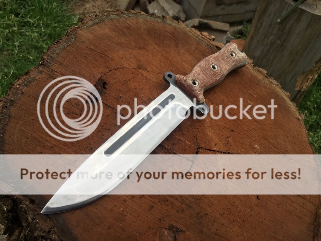

Just the wheel that cam with the Dremel kit. About mid range in terms of speed. Plenty of passes taking little bits off rather than holding in one spot. I think it would be excellent for removing coating/tidy up between the corrugations on a CBT blade.
Thanks man--so the blade didn't get too hot, even at the low RPMs? No spraying the blade with water? I definitely have to try this--hand sanding all those grooves has to be a serious PITA.
Thanks again!
I froze a block of water in a large plastic container about the size of an piece of copy paper.
Once frozen I lay my blade on this as a work surface while I flap wheel/Dremel the coating off.
If you use the 120 Grit wheels you get a good starting point for this.
No worries with heat, it's how I got my BG ASH so shiny so fast too.

I etched the logo using cotton wool ear cleaners (I think you folks call them q-tips??). Didn't take any photos of this part unfortuately. Used a battery charger, salt water etc. Very simple to do!
