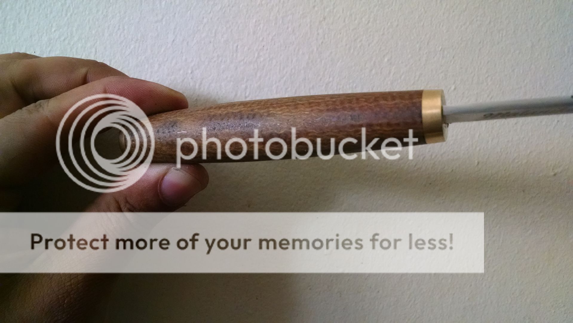

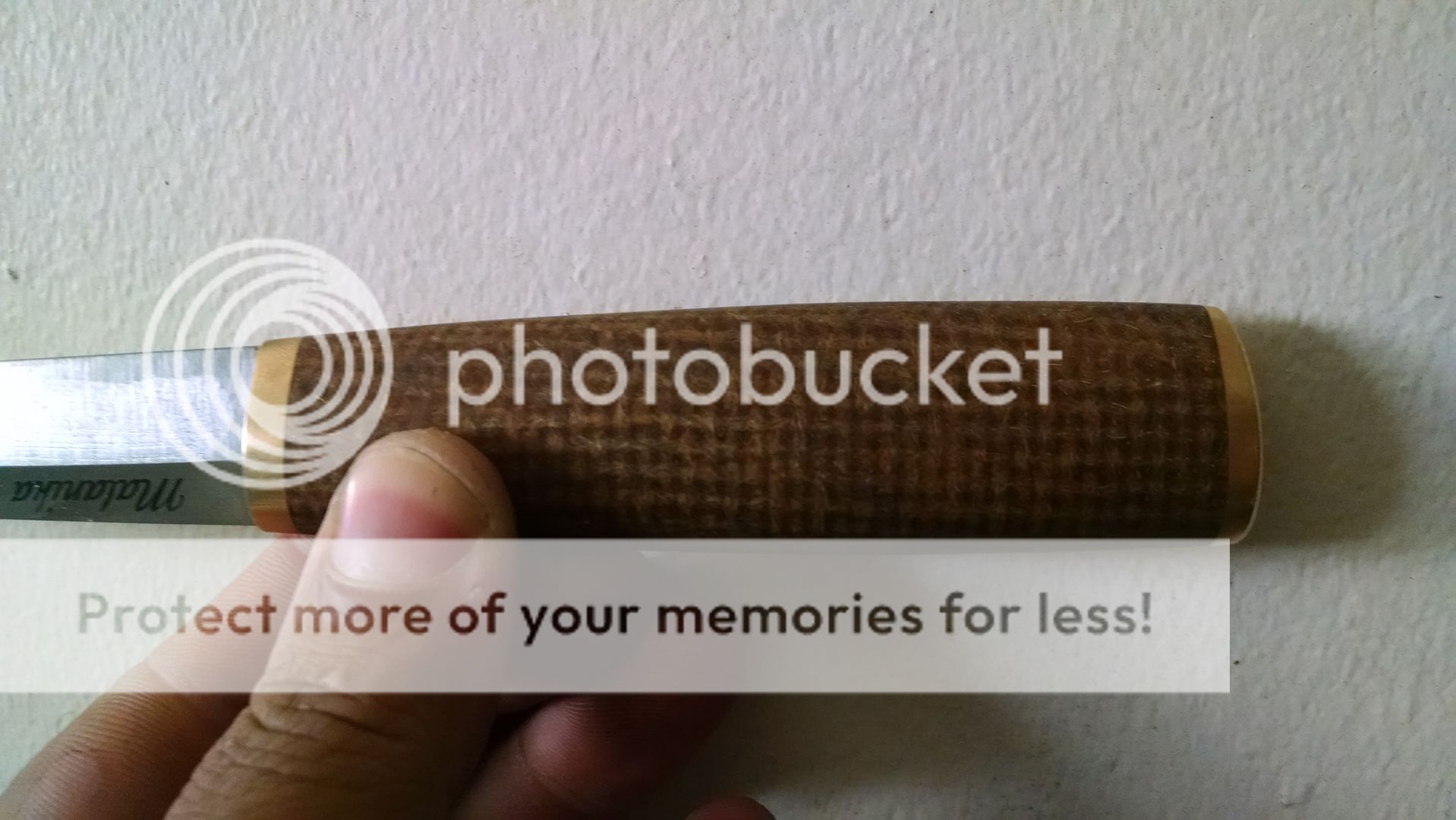

Howdy Brian,
It's not that spiky :D
It has a subtle swell to it already
I wouldn't change anything :D
I share that concern, particularly because I am out in very cold temps and wear mittens or gloves that don't necessarily provide a lot of traction. I know this will be sacrilege to some, but my ugly solution to this is to wrap a few layers of hockey tape around the hilt to make a modest hand guard to give a little resistance (both because it creates a bump and because it creates some drag). I hope mine is already on its way so he does not change his mind ;) Most of the handle will still be as delivered of course.
You should be fine
I've used it with gloves, no issues. :D

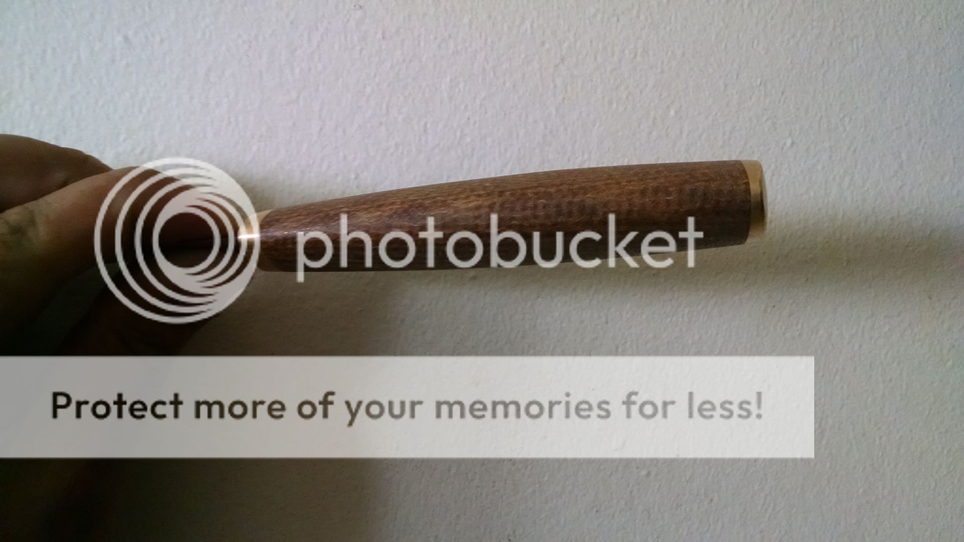

Barrel handles on puukkos usually tend to have teardrop section and to be slightly tapered in both height and thickness, at both ends. It may sound strange but, once grasped, it's a self locking handle, that nevertheless keeps a great liveliness in the hand and allows for the best controll, whatever the knife grip. It's the kind of handle that feels like it melts in the palm.

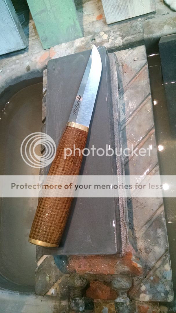

Alright time to start this review!
It's always daunting to start these reviews
Ill just start with what I was doing yesterday

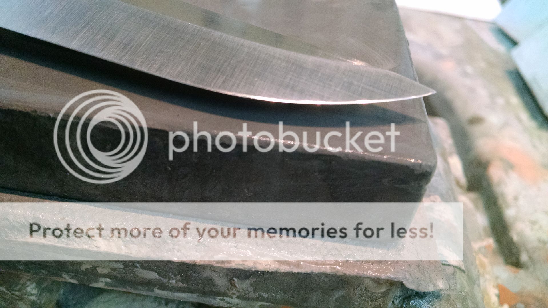

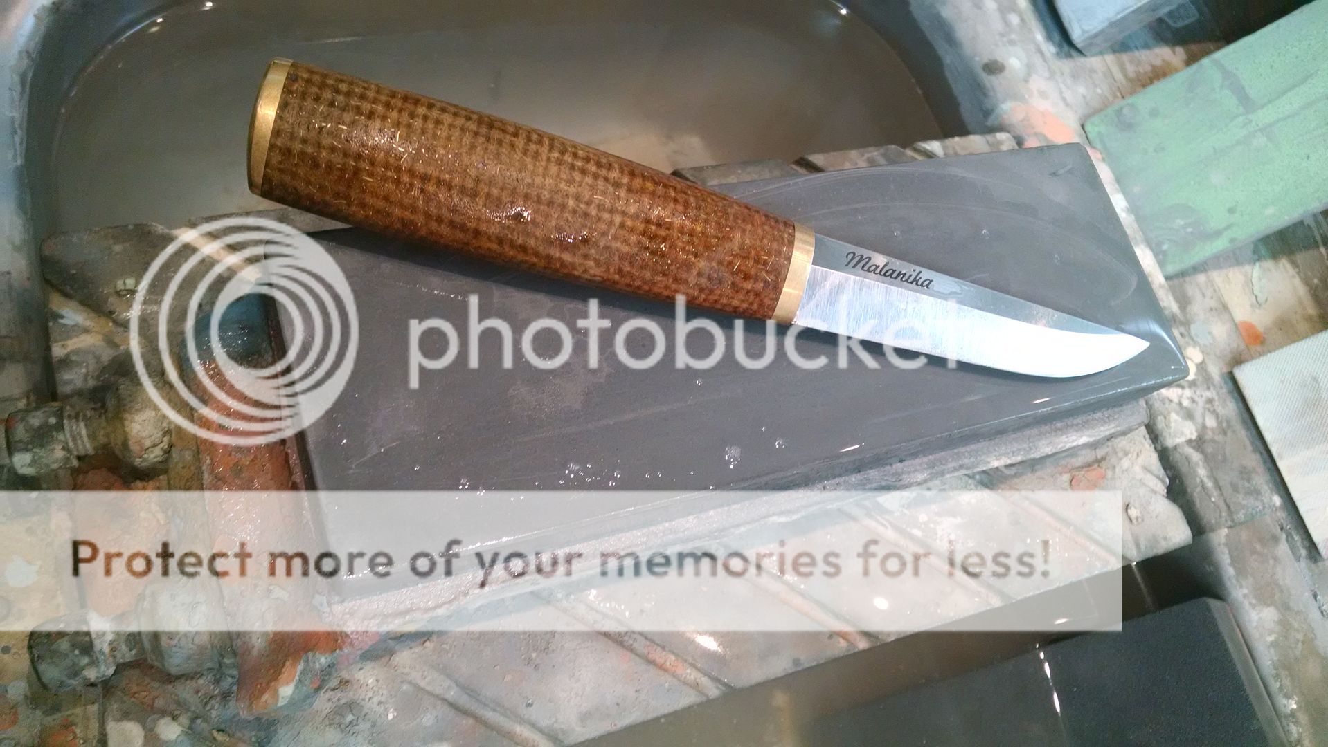

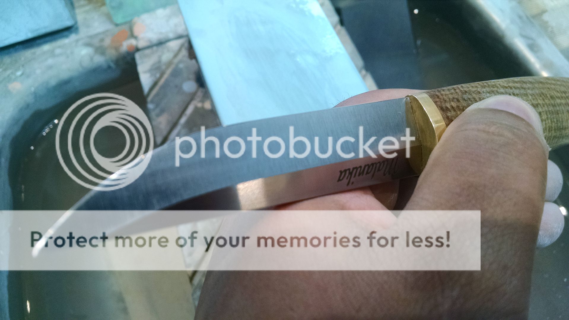

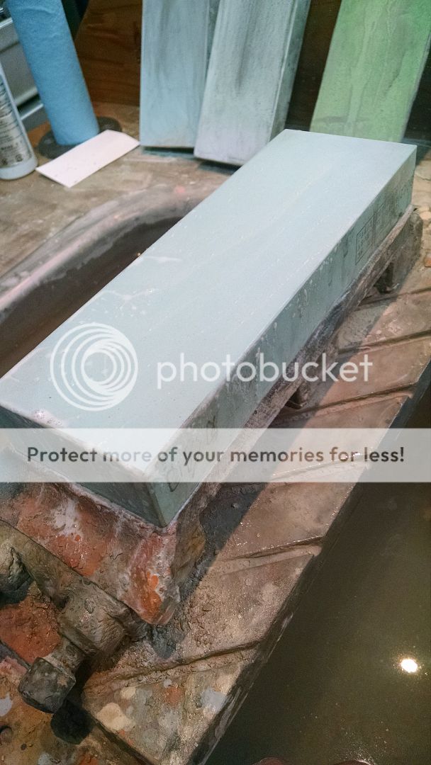

My gracious friend allowed me to use his high grit,very expensive high end chosera waterstones
I was curious to see how CPM M4 behaves with such a high polish with such a high amount of carbide volume.

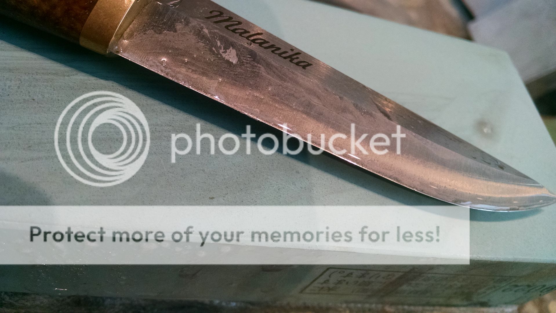

I started on the last stone I own and used before
The chosera 3k
I then moved up to the chosera 5k
The 5k is unusual in the chosera series, it needs a light soak compared to the splash and go on the other stones.
It's a great feeling stone, rockhard but great feedback low dish and minimum load up. Builds more mud the the 3k

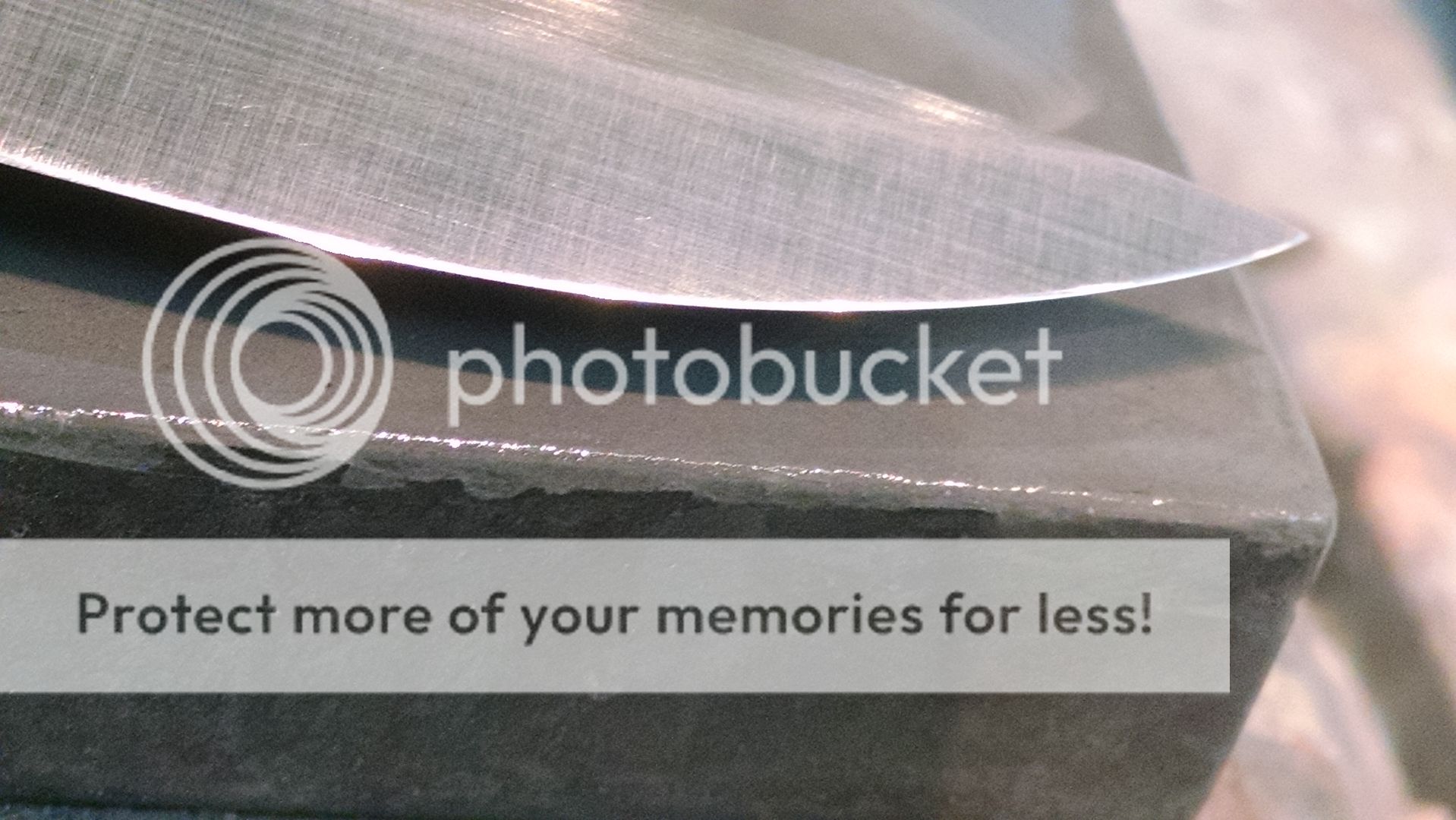

Here is the edge after

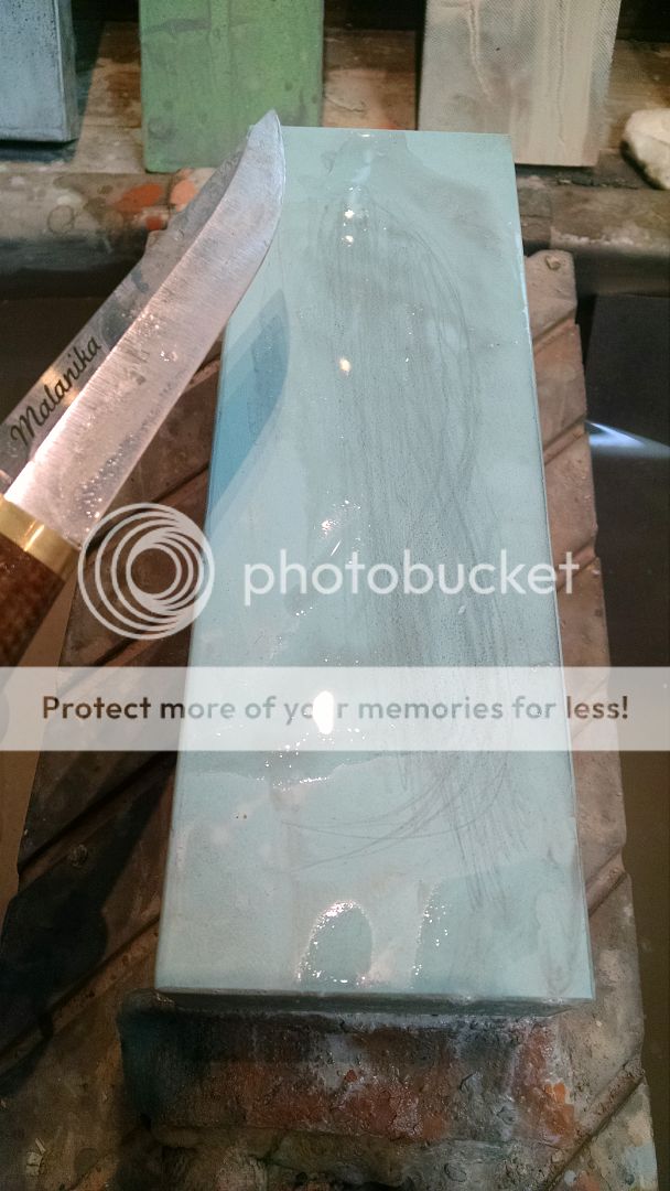

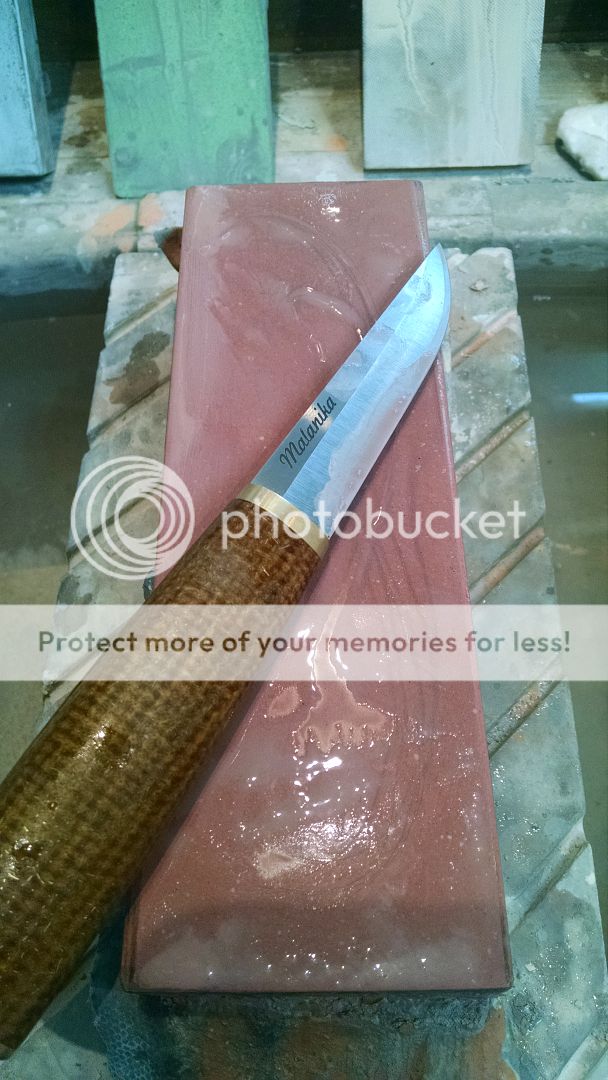

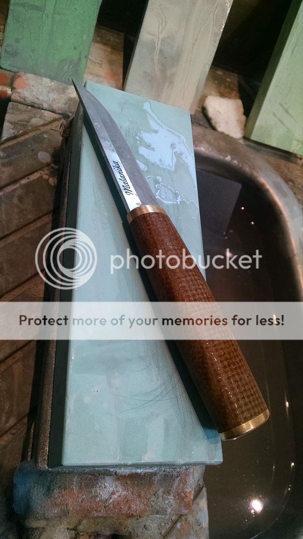

Next up is the 10k Chosera
Wow, what a mysterious stone.
What I mean is it leaves an insane polish but can still raise a burr!
Too expensive for me to own. $250
But I would truly need to own this stone to master it's capabilities
What a conundrum :D

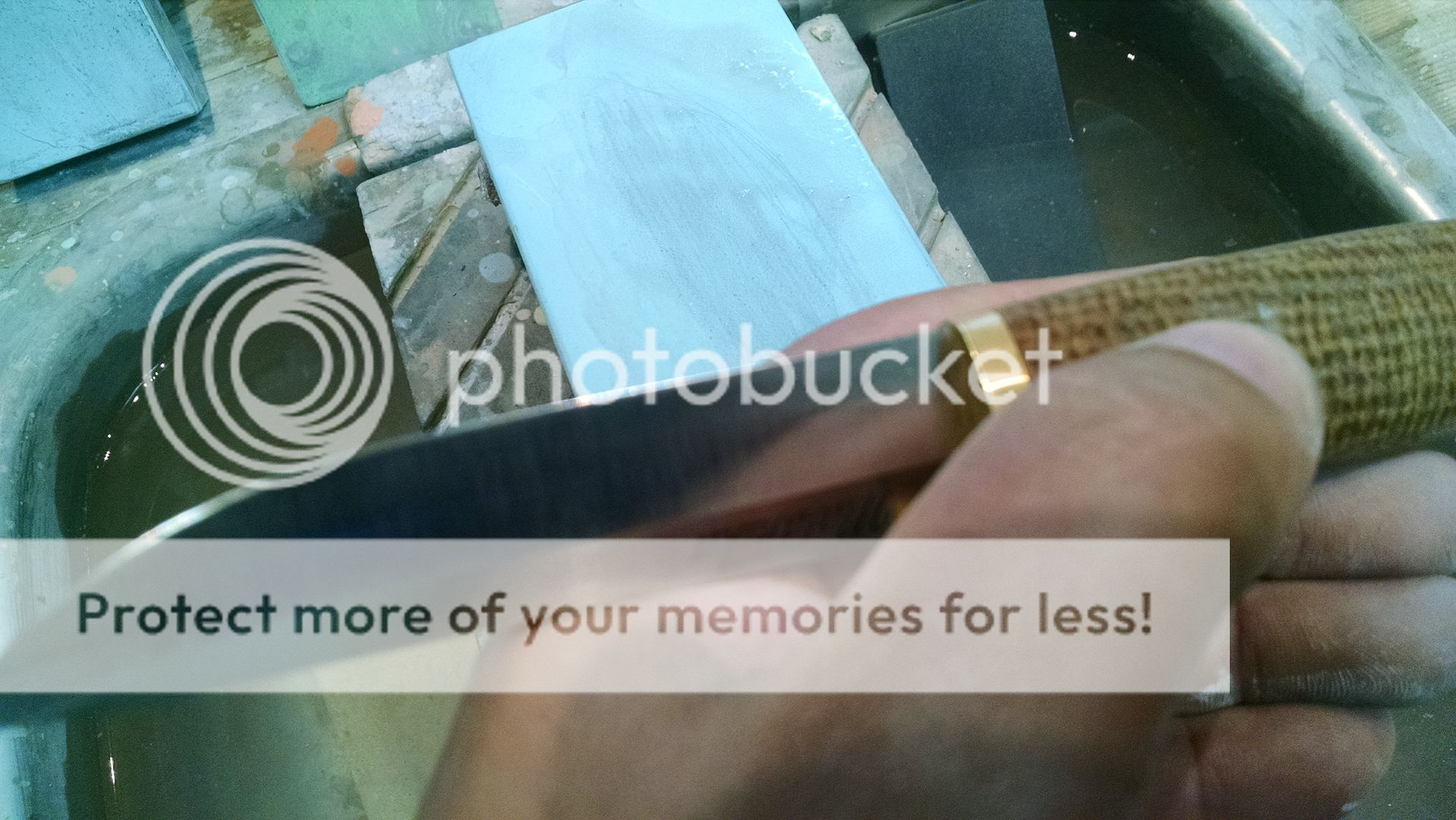

First, a short soak
Then I use a Naniwa stone flattener to level the surface and build a slurry.
Again great feedback, you can really feel it cut the M4.
But the M4 is definitely not as fast cutting on the stone as plain carbon steel.
One of the most challenging aspects of Sharpening on high grit stones is preventing apex rounding.
Basically the edge is still very sharp but not as sharp as it could be
This has to do with angle consistency and if you want to treetop hair and slice paper you have to have a clean apex without rounding.
You can see that the stone is cutting the steel but not as good as a plain carbon steel.
Yet, the desired results are achieved

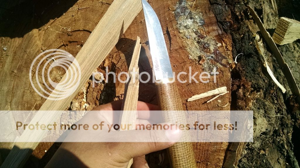

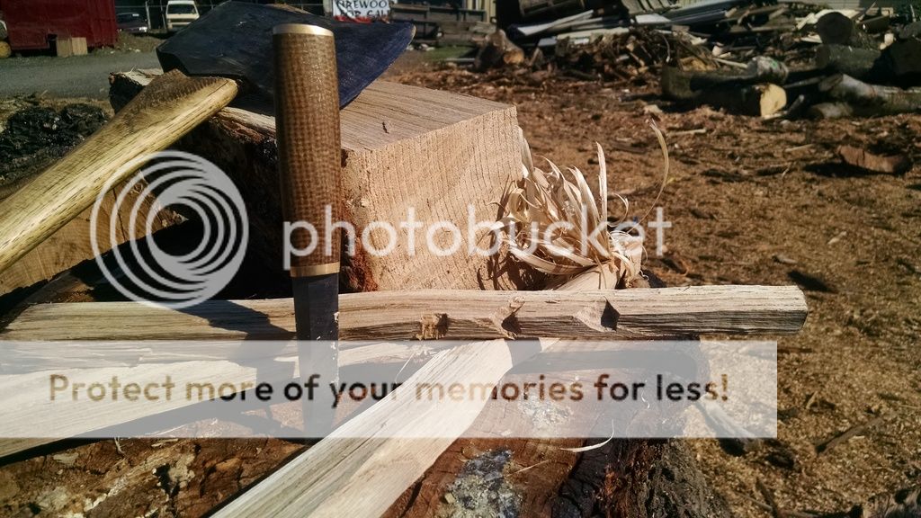

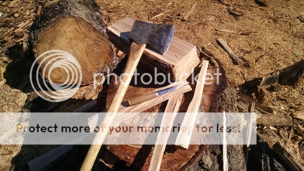

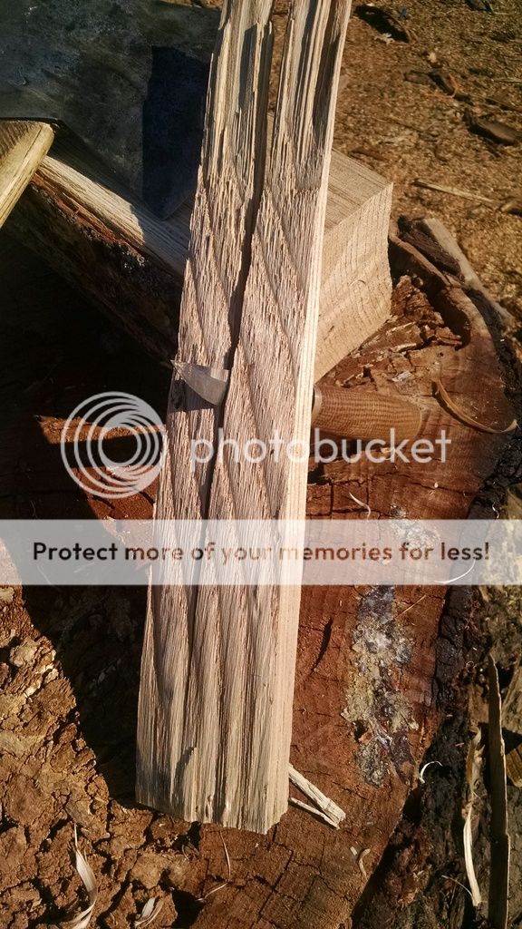

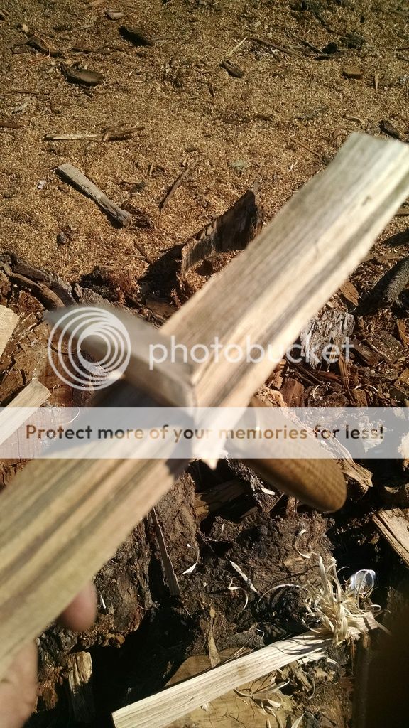

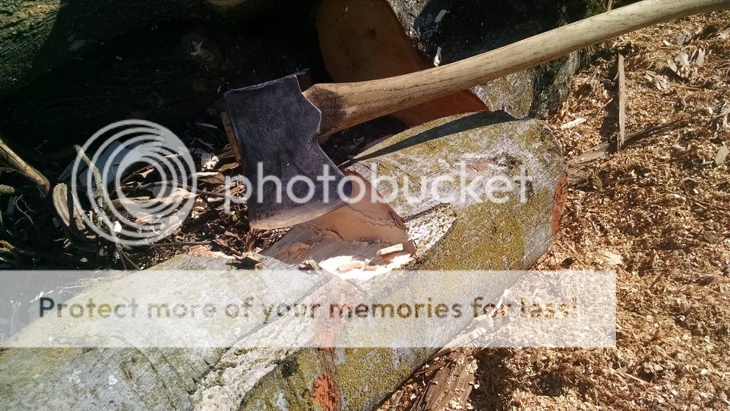

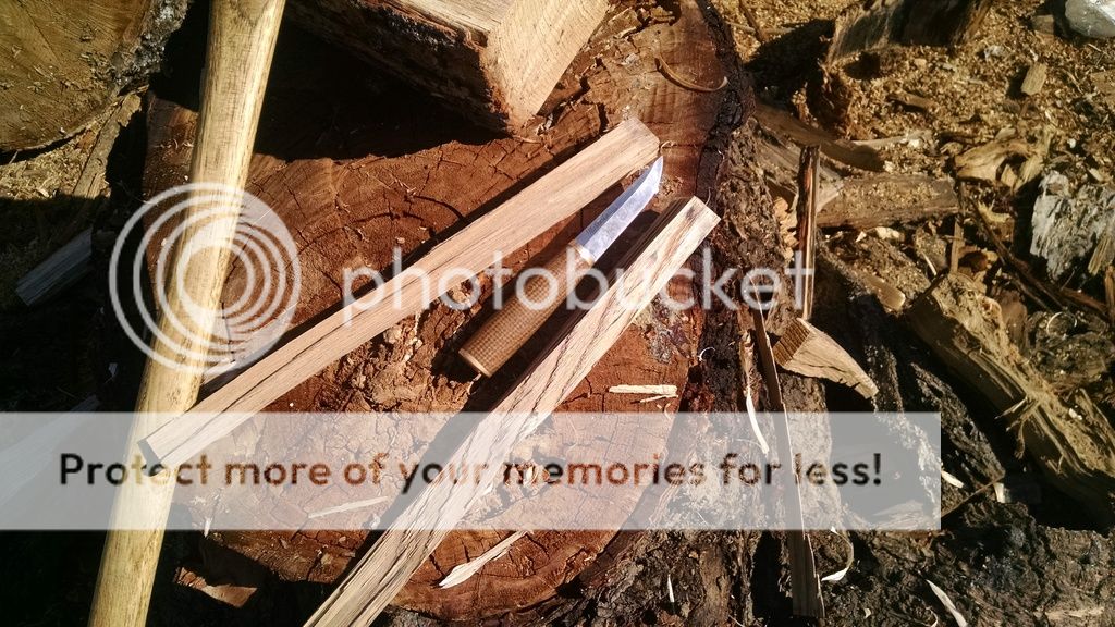

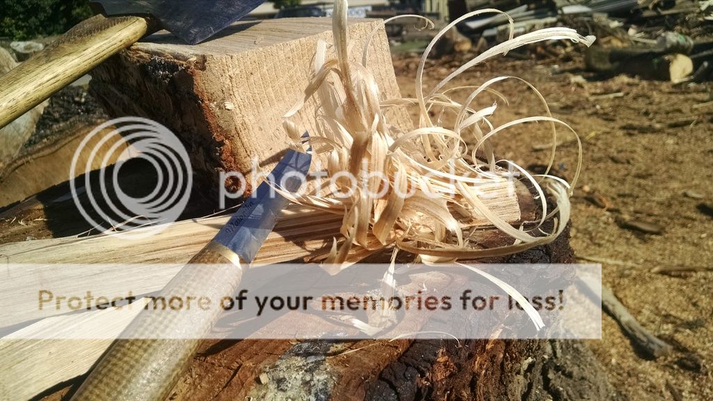

Went to the woodpit today to brush up my wood processing skills for my next wilderness camping trip.
A Puukko is a perfect companion to an axe which is the best tool for serious wood processing.
Wood can be broken down to Puukko sizes
This is what it's all about, when the rain comes this will be the only tender available.

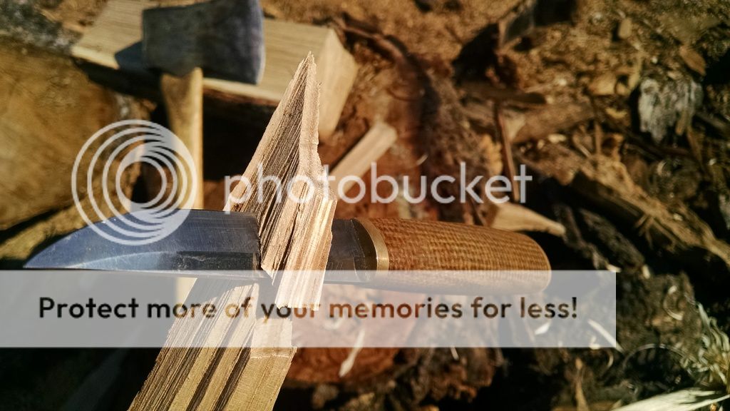

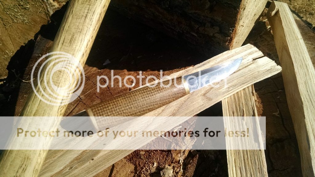

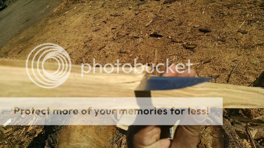

The cpm m4 shreds especially with such a thin rhomboid geometry.
Notch carving is a breeze as well, very nimble without any guard or finger grooves or choils to inhibit use and manipulation.
Batoning can be done but it must be done intelligently. Knot free smaller pieces. While possessing relative toughness the blade is still at 63hrc!
Of course there are some cool techniques with using wooden wedges to split bigger pieces of wood we'll have to check out later.
Using a chest lever technique the knife just keeps cutting
Really separates the wood
Cuts it in half
Killer geometry for wood
We'll check out more later.

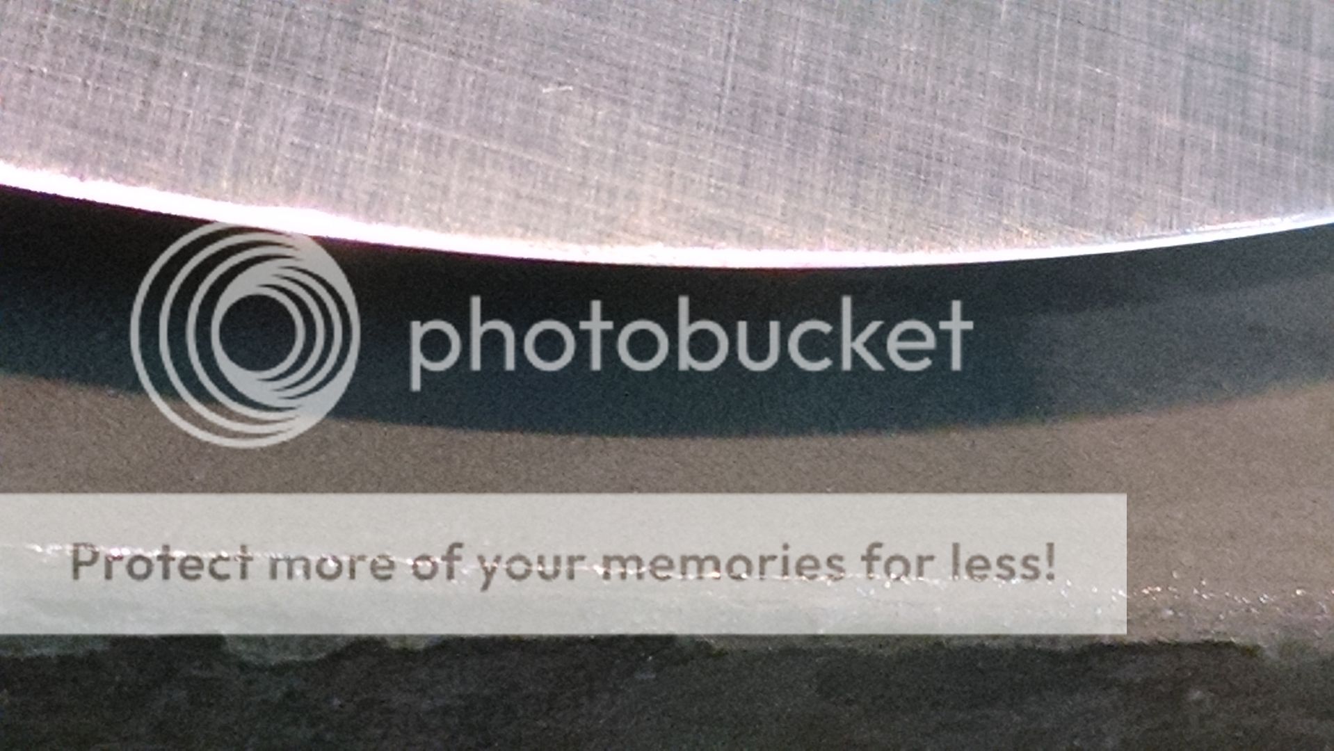

Here's my question Shawn. That stone is very soft .Is it really appropriate with a steel like CPM M4 ? would it be better to use a very fine alumina stone ?
My old question also - make a burr then remove it ?? Why bother making one , then removing it ? Just do fine hand work to bring it to a great edge. I'd still like a logical answer to that without " everybody does it " or " you have to do it that way " WHY ? My sharpening was mostly self taught as a little kid [wood carving at 7 years old ! ] We know today that it takes very little to damage the edge from heat with machines .We also know that a thin sharp edge can actually be bent forming a burr with enough downward force. So gentile hand work to make a burrless edge. Explain that guys !
That stone is actually incredibly hard, it's a Naniwa Chosera or "professional" stone it is packed with ceramic abrasives with a magnesia binder.
Notthing like the muddy "clay" stones
It's one of the few high grit stones that can actually raise a detectable burr on.
There are alot of secrets to this stone in particular because of its usual qualities. But it's not in my budget and is very specialty.
As for burr making.
That's the only way to make the sharpest edge possible.
Fatigued metal is abraded away
And fresh steel is revealed.
The burr confirms the apex point has been created and damaged steel is removed.
The burr is fatigued and removed leaving a crisp V apex that can tree top hair, and cut paper towel.
That's the only way to get the sharpest edge possible consistently and timely.
I honestly wish I could get the same results with out forming a burr.
But without a burr the apex is like a ballpoint pen. It will never be as sharp and the only way to make it sharper is to form a new apex with a burr.
I can understand the reluctantly to from a burr.
It's difficult to remove and there are pitfalls such as a "foil edge" as well as removing too much steel.
Again with the proper understanding and techniques burr removing is a non issue.
As for removing more steel, that is why a small burr is created.
It removes less steel to keep your knife sharp as well rather then waiting until a knife too dull to cut.
Also we can only strop and hone for so long before it's time to Sharpen a new apex.
Here are some resources this gentleman is mostly focused on straight razors but he has access to an electron microscope and has great sharpening knowledge.
https://scienceofsharp.wordpress.com
Here is a picture of a pocket knife edge after sharpening on a ceramic abrasive like the Spyderco fine ceramic.
