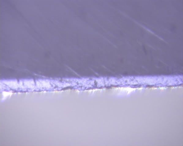

I did a little cut test with my S90V mule a few weeks ago, I chopped on hardwood for about 10 minutes, cut some drywall, some manila rope and some real nasty cardboard. This is the damage.
The edge had visibly flattening but would still cut like a much sharper knife.
Edge was microbeveled around 15* and photo was at 400x

Why would you do such a cruel thing to such a nice blade? You must be stopped.
Haha just kidding. That looks about as expected. Any comparisons to S30V?
