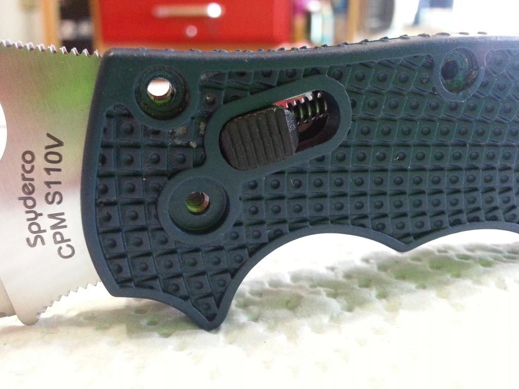

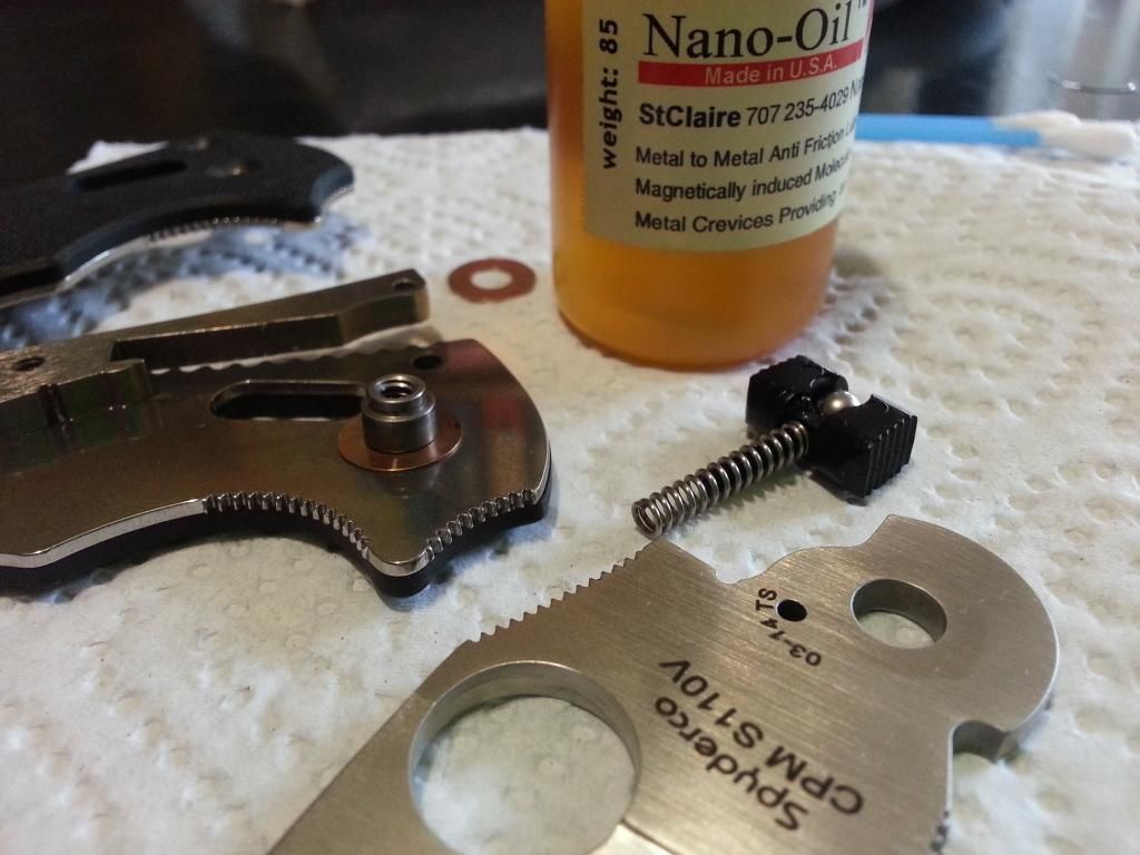

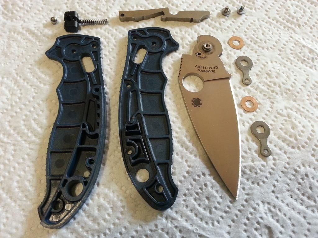

Manix 2 S110V Blade Swop WIP Part 1
Manix 2 S110V Blade Swop WIP Part 2....

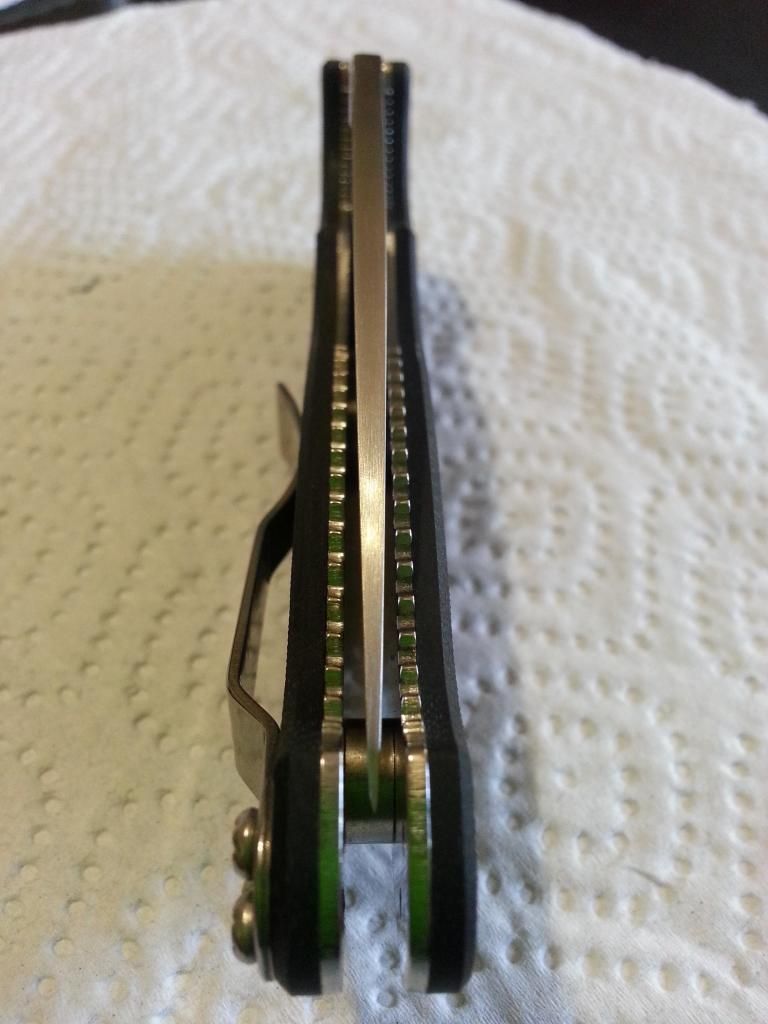

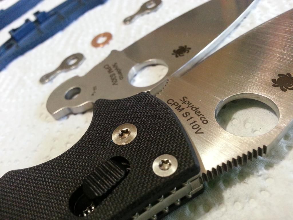

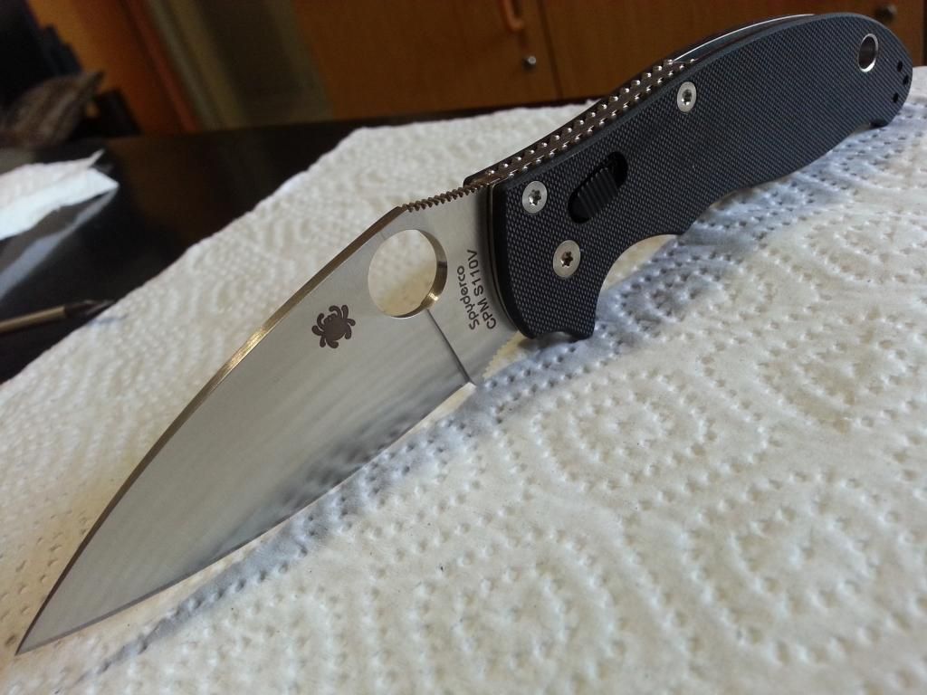

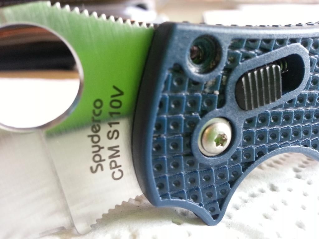

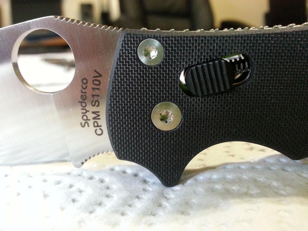

Solid lockup - no blade play in any direction whatsoever & blade centered.
Thanks for looking.

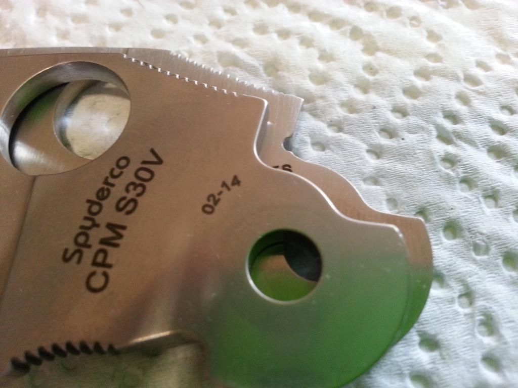

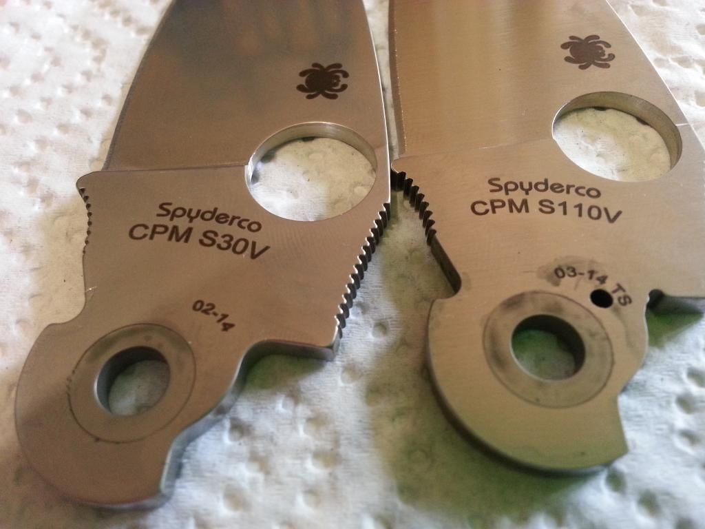

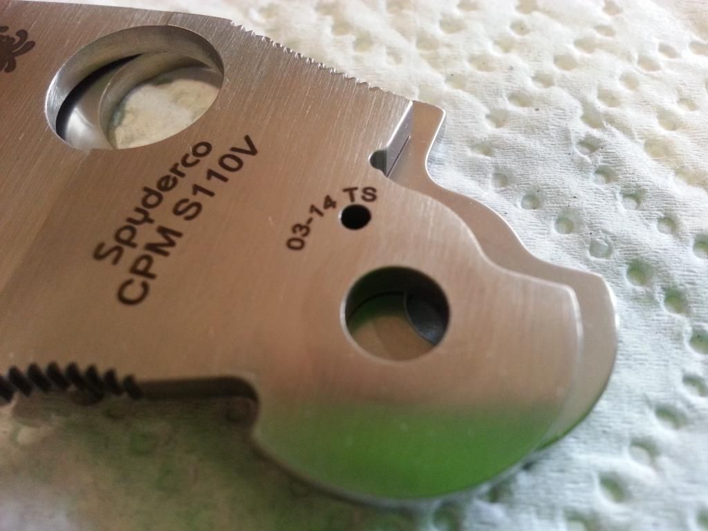

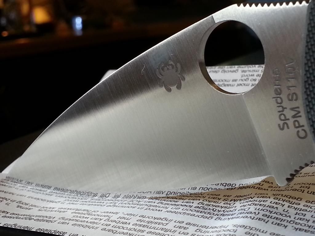

Looks good. Why does the S110V blade have a notch and the S30V not?
Probably because the S30V can be fine blanked in the finished shape, but the S110V needed to be machined/ground and the notch is an artifact of the process that was used.

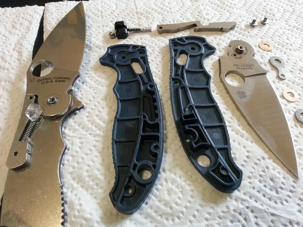

A few questions MasterRook

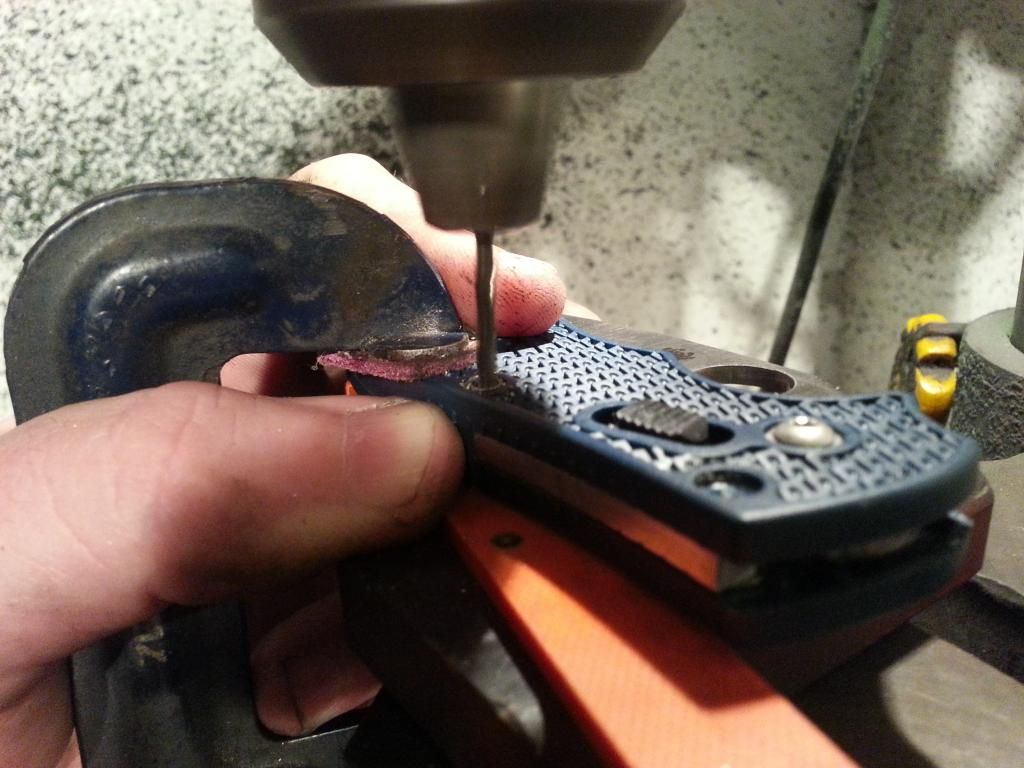

I'd you only have to drill the riots on the one side and then push them out?

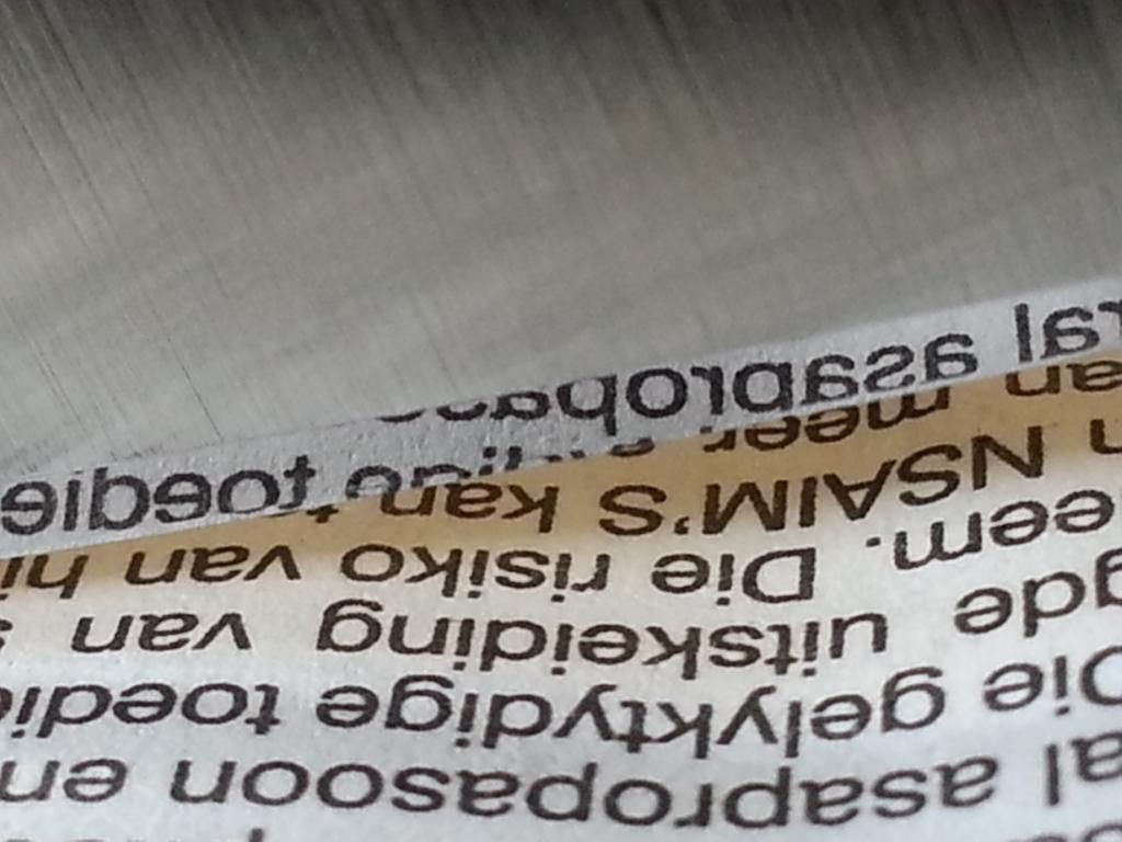

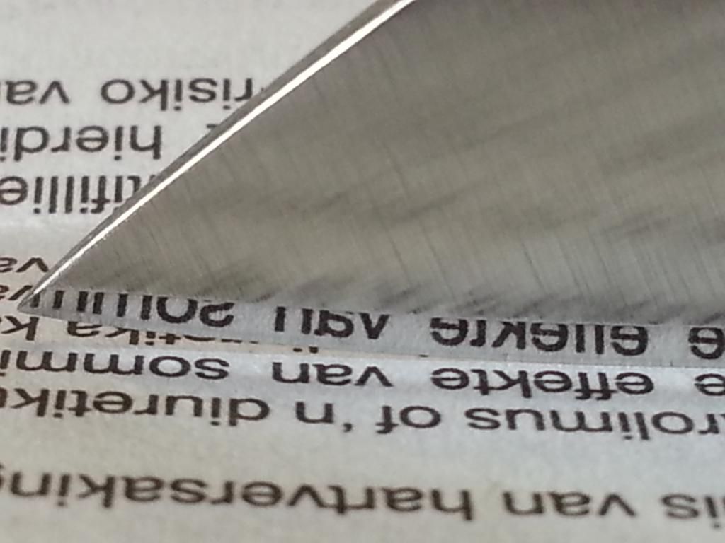

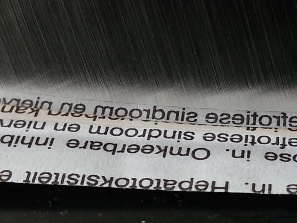

How did you get such a beautiful mirror edge? Just gorgeous btw
Yes, drill out one side then tap out remainder.
Used Shapton Glass stones to 30k spritzed with diamond spray.

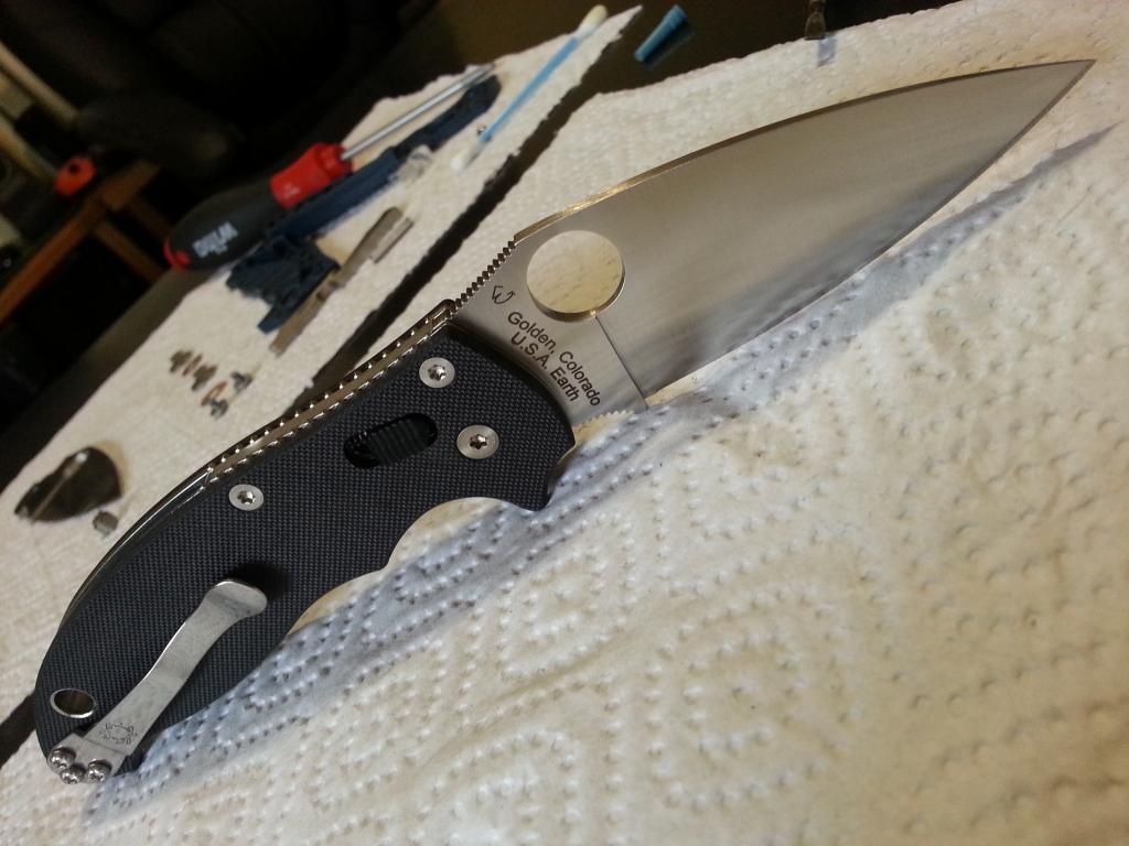

Going to use these to rebuild:
http://www.kmts.co.za/Main.asp?D={37056F5E-B915-4976-B78E-0C30C379301E}&PageType=Product&SKU=DP3.0T050++++++&CategoryID=130

Really nice! I am very impressed with your work MR!
Can't wait to see your picts o rebuild. Yea, my wife wants that FRN with 30V and placed dibs on y swap project based on your presentation. ;) )

how did you make sure your drill bit in your drill press didn't slip off of the rounded rivets? I am thinking at least exchanging my rivets for screws...
