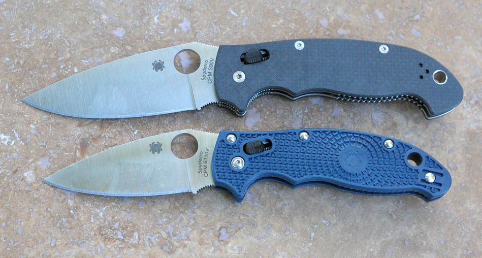

A few pics never hurt no one
OK, if you wish...
