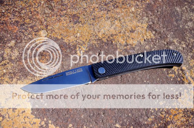

Edited to add some more about those detent stops, one thing I like is, it doesn't slam shut on you, the two large flat areas for half open and full open work great and are very solid, the softer detents are when the corners fall into that V, makes for a softer closing, which I think can equate to a safer closing too.

....... please do not rely on the nail nick as I feel it really is there for looks, as it is not cut deep enough for your nail to catch a purchase in order to open the blade, better to pinch the blade to open right from the start .....

Yes, it is not very confortable. It's easier to catch it with fingers. The spring is strong and it's dificult to open with fingernail. For a lady is impossible. But there is enough space to catch with thumb and index finger.

and you're welcome Flatblackcapo, it's a great knife, carried it today and was my main go to blade, so solid, so sharp, nary a thing to complain about, if anything my only thing would be to have a lanyard hole, maybe a hidden one in the back spring, but, that's asking a bit much for such a reasonable folder.

Yes, there's a LOT going on in the design of this folder, but my main thing...is how she cuts, just quick and deep, a really good slicer/cutter right there. I've been holding myself back from getting one of the other coloured handles ;)

And speaking of review, a friend reminded me that I neglected a few specs, I guess if people were aware of the Manly folder they'd check it but it's handier in one place so here are the following specs provided on the nice card that comes with the knife;
Model: Comrade
Length: Open 205mm, about 8"
closed 115mm about 4 1/2"
Width: 22mm about 3/4" ( I take this to be the scale width)
Weight 110 grams
Steel is 1.2379
Corrosion resistance: Low ( so care is needed to prevent rusting )
Sharpen angle 15 degrees, which I take to be 30 degrees inclusive
Hardness 59/61 HRC
I measure about .019" thickness at the top of the edge bevel so ground down fairly thin.
G2
Edited to add a few fine points, the multiple detents I am guessing is that there is a V cut into the back spring that the corners of the tang drop into, causing the knife to halt at each passing.
The steel liners have large cut outs for weight reduction, still a hefty knife but less so due to that removal of steel.
When closed the back spring is flush
With the blade half open, the spring is also flush
With the blade fully open, the spring is again flush, amazing level of detail provided in such a moderate priced and rugged folder, well done !
Hi Gary,in my Manly folder, the backspring is flush in closed.Very slight rise at the first stop.Flush at the second stop.Slight rise again at the 3rd stop and flush again at open position. Is this how it is on yours.
Knife comes very sharp from the factory. One of the best factory edges.
Correct, at closed, half open and full open it's fairly flush back spring, the orange/black one has the full open with the backspring slightly lower but not by much, all in all I think that is pretty nice they can do that on such a modest priced folder!

A better view of the scales, fairly grippy in the way they grooved them, without being harsh to hold
