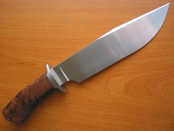

If I choose not to use a through pin I have another procedure that produces equally sound results. I use a hidden pin, a rivet, and a file worked tang. All of my tangs run to within 3/8-1/8" of the butt. All parts are cleaned thoroughly using detergent and acetone. I use a slow cure epoxy and place the entire piece in a curing box. I allow ample time for epoxy and JB Weld to cure before I resume work. This process creates a handle attachment that is every bit as strong as through pin construction.

All of my pieces are tested thorougly. All go through at least an edge flex, 2x4 and cured osage orange chop, free hanging paper and rope cuts. This piece was used heavily clearing small hardwood trees, cutting vines and grasses, in addition to the above testing criteria.

I have done many destructive tests using different compounds and epoxies. I have found that epoxy alone is sufficient. However, I prefer not to rely on epoxy alone.
