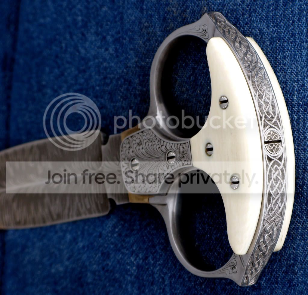

I just got these images back from Sam Welch the engraver. I made this and sold it at the Reno Show without engraving. My collector sent it to Sam. I cant believe the talent he has!
I just thought you guys would like to see it.

Wow!! what size wheel was it ground on?
It was ground on a 5" wheel. I like the small hollow because it lets the ridge stay higher.

I want to learn how to engrave but I cant see myself doing this quality of work. I cant even figure out how Sam did the celtic pattern. Just one slip and its a modified celtic.

Bruce, that's fantastic. the shape of the blade and the engraving... :drool:
and the lined up screw heads are crazy!

The engraving is a superlative job. Your knife making skills are amazing. I really like the way you indexed all the screw heads :thumbup: WOW!
man-oh-man-oh-man is that ever beautiful Bruce !! :thumbup: :thumbup: :thumbup:
Elephant Ivory Scales ? Curious as to the other materials used in the build too. Do you call that a feather pattern damascus Bruce ? Its beautiful !!
The indexed screws do attract attention. The depth of the counter bore is critical and then the underside of the screw head may need adjustment by removing metal. The large screw on the pommel I made on the lathe and cut the slot myself but the small screws are stainless slotted 2-56. With fine threads ya get a better chance of having most of them lined up anyway.
