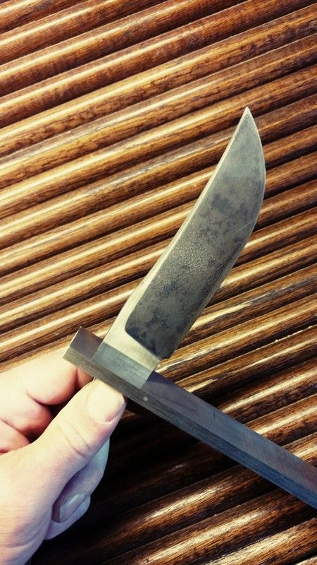

I started this blade last summer and work on it here and there between projects. It's for a friend of mine that spends a lot of time hunting everything from Coyote to Elk.
Long story short, I asked him if I could make him a knife to use and give me some feedback. We discussed a design, and he said, "A hunter would be nice, for Deer, Elk, or Antelope maybe". My strange brain makes up words and shortcuts, and I said "Ok, Delkalope it is then".

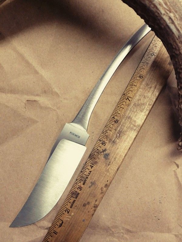

Just so everyone knows, this is a long term project for me. I'm not in a rush with this knife, it's a bit out of my comfort zone and will be a learning experience. When I finish the leather work I'm doing now, I'll focus on it a bit more. It's 5/32" 1095, the plan is a pinned antler handle with a through tang, thin end cap, NS guard, stacked leather and spacers of maybe brass, nickel, blackwood, not sure yet. The pinned handle and end cap are out of my comfort zone, we'll see how she goes:thumbup:
After heat treat and the guard close to fitted. It's been collecting dust at this stage for a little while.

John, I think I would do a peened tang on it like your other knife with the stacked leather handle. By the way thats really a nice looking blade design.
I wanted to ask you about that Scott. I want to do a through tang, peened through and end plate. I figured a pin would be necessary as well to keep everything locked up. In my head I can imagine that antler wanting to "twist" on the tang if it is just epoxied, even with the exposed and peened tang. I'd like to turn the tang round at the point it goes through the end plate and make it look like a button.
The salt from Maynard's tears, will pribably corrode the blade off before the handle would fail anyways.:D
The antler will never twist what so ever if you use a good epoxy like Devcon or G-flex or something similar. Peening the tang if rectangle shaped is much stronger than a round tang. The best looking ones I've seen on BFC for sale by maker are by malanika and his are oval and that will never twist on you, in fact he a knife for sale in that forum right now that shows the peened tang, very nice knife, take a look. When I first started making lives I made the mistake of using 5 minute Devcon epoxy to glue on an elk horn and stacked leather handle to a 5" drop point and it started setting before I got the handle on and couldn't get it on all the way and it left about an 1/8" gap between the antler and leather spacers. Anyhow finished that knife up and eventually decided to re-handle it, anyhow I beat on that elk horn with a carpenters hammer until the cows came home, I squeezed it in my vise as hard as I could, and didn't do shit to it. The only way I could get that handle off was grind it off, that Devcon is that tough.
Great to know Scott. Initially I was thinking about doing it like I've done on the leather stacks, a somewhat rounded rectangle. But the overkill in me got to thinking that the antler might want to twist, so I started considering a pin. I've been using Bladebond with good results.
Well good deal, I can avoid drilling the antler and just to slot it nice and tight and stick with the way I've peened them before:thumbup:
For what it's worth Randall stopped pinning their handles quite a while ago, the only reason I pin mine is tradition, it's pretty much purely decorative nowadays, Scagel's were all built prior to epoxy being readily available so his handles all had to be pinned and a lot of them even had two pins in them.
With the through tang and peened end, I think I'll lose the pin. Sometimes overkill gets me.
