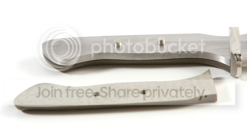

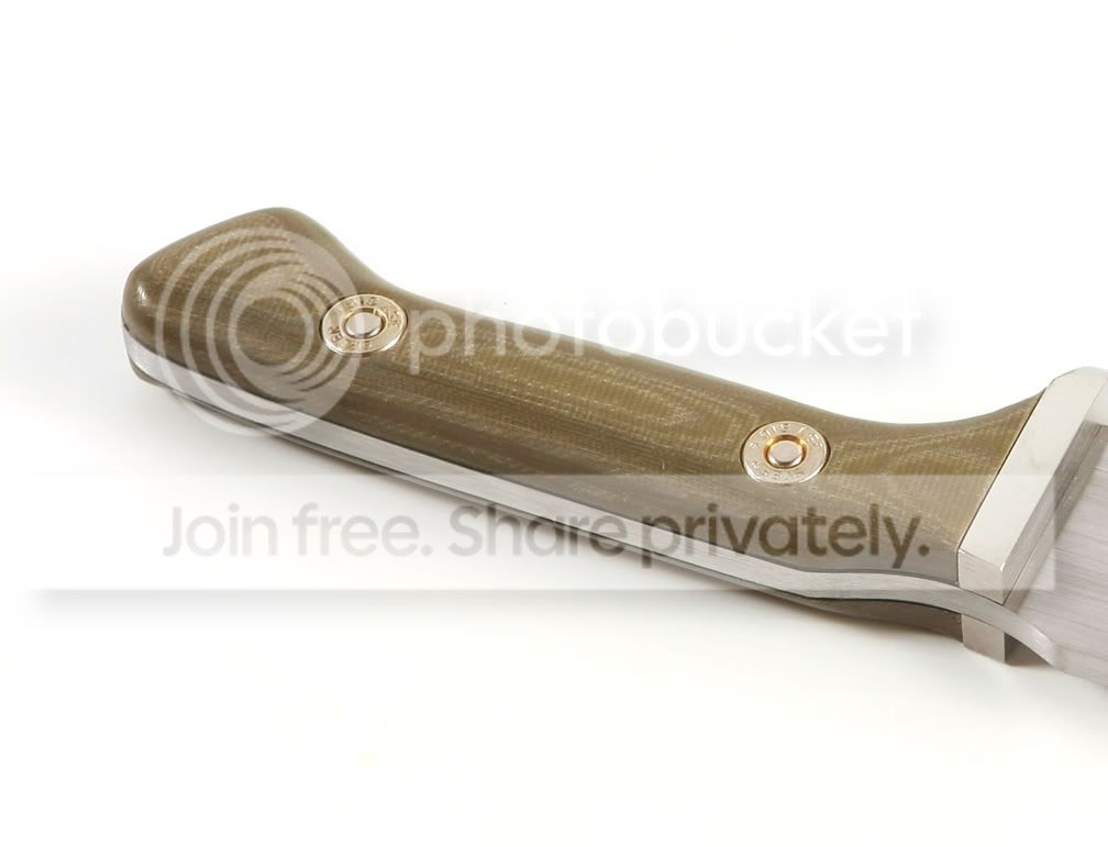

Great Idea! Here is one I did a couple weeks ago, I didn't try the thong hole though. I soaked the primers in penetrating oil before I seated them:D nothing is glued together yet, just an experiment. (still needs some sanding to blend it a little better)

Muleskinner, that is sweet with the hidden pins! Thanks for sharing it.

muleskinner - instead of leaving the primers in, why not use pins that are the same size as the primers - then you wouldn't have to "hide" them - or take a chance with a "live" primer?

Cool idea! I have a few ideas for ways to use the casings as rivets for you if you want to try them out.
For the hidden pin look that muleskinner went for, without the danger of a live primer, you could install the casings without a primer. Since the primers are a press fit, you just machine a brass or stainless pin long enough to press thru one casing and into the other bonded in place with some clear epoxy. You would have to measure your pin length required, cut to size, and slightly round the sharp corners on both ends off so it looked like the primer before pressing it in place.
To do a thong hole rivet, machine a brass pin on the lathe that is very slight press fit into the mouth of the casing. Do all the normal steps to countersink your casings into the handle material then drill your tang out to the size of the new pin. Position one casing in place on the first side of the handle. Cut your pin to the proper length so it is an 1/16" short of being seated in both casings when they are in the handle so it can't prevent a flush fit. Put a small bevel on the ends of the pin to aid in getting it started in the casing. Coat it with epoxy and press it into the casing already installed in the handle. Position the 2nd casing on the other side of the handle and coat the pin with epoxy. Press the 2nd casing into place. Then just drill all the way thru the center hole where the primer would normally sit.
