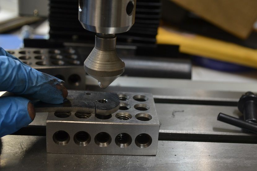

I'm drilling the spotted pivot hole out to 6.2mm or .244" so I can ream later.
Chamfer the burr off... this also lines up the reamer path.
A light sanding to deburr fully....
Reaming to .249" for a press fit... this ensures that the pivot will not spin. This is a critical operation and done with a collet in the mill. I brush on a drop of tapping fluid to help the reamer cut cleanly.
I'm pressing in a temporary pivot with my one ton arbor press. I'll use the above procedure for the other pivot hole but ream it .001" larger for a tight slip fit. After that I use the pivot to line the two frames up for the next reamed holes.
